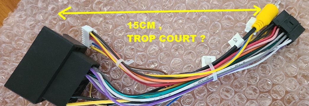

hi,
contact 'they will send me the right cable...
because cable too short
and the wiring instructions too, I hope!

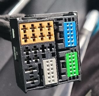

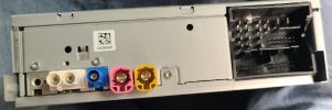

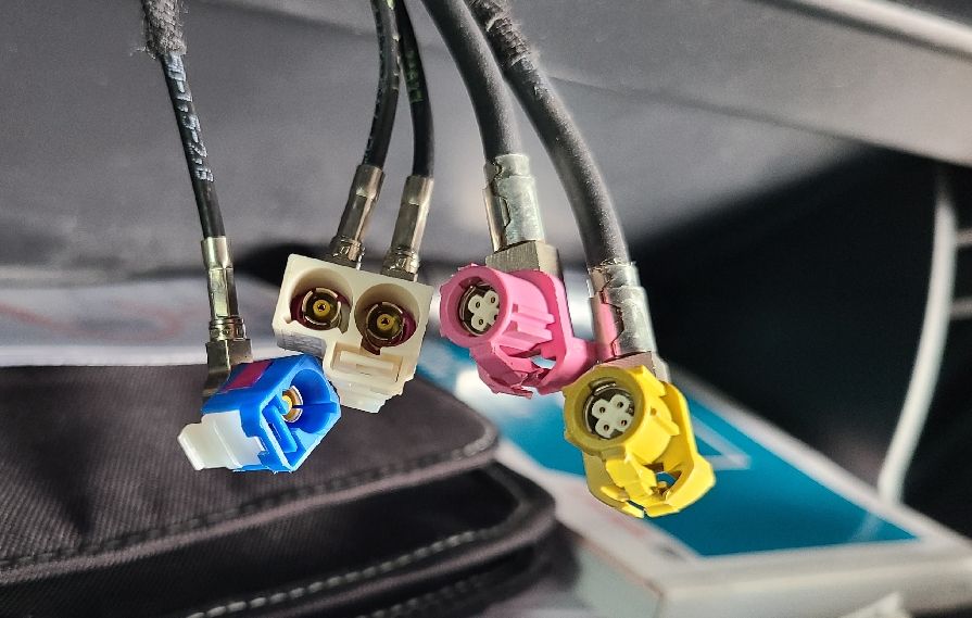

Can anyone tell me what these connectors are?
usb, that ok, there is a gps antenna, radio and the other?
Who is who?
I think I should not use any of these connectors with Chinese multimedia, right?
thank you
I'm not an expert on Fakra connectors, but I'd guess from what I've seen before that the white connector you label 'USB' is in fact a Fakra Z dual antenna connector.
Reactions: Tell
after searching, I find pink, GPS and blue GPS ?
the white , I wrote USB because I’ve followed the cable that went green the usb sockets ,but I did not see well...
when to the yellow? not clear all this , but not important I think
because all these antenna cables will not be used I think .

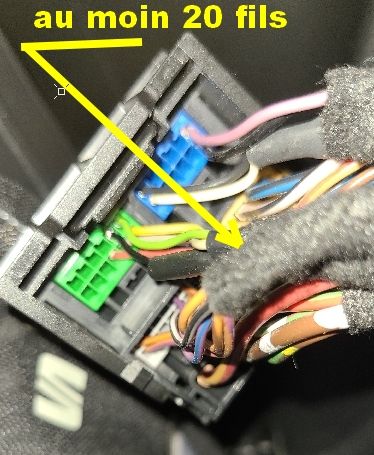

the big problems is the main connector , 16 has 20 wires on mine and about 10 wires on the new , not very logical ! without documentation of the car radio (which I’m waiting for ) it’s not easy .

HSD , ok ,
so , high-speed cables for audio and other ?
but how to think that it will not be used after
the new car radio will need to communicate with audio outputs , so ?
I hope they will send me a documentation soon .
Chinese always "in silent mode"

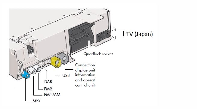

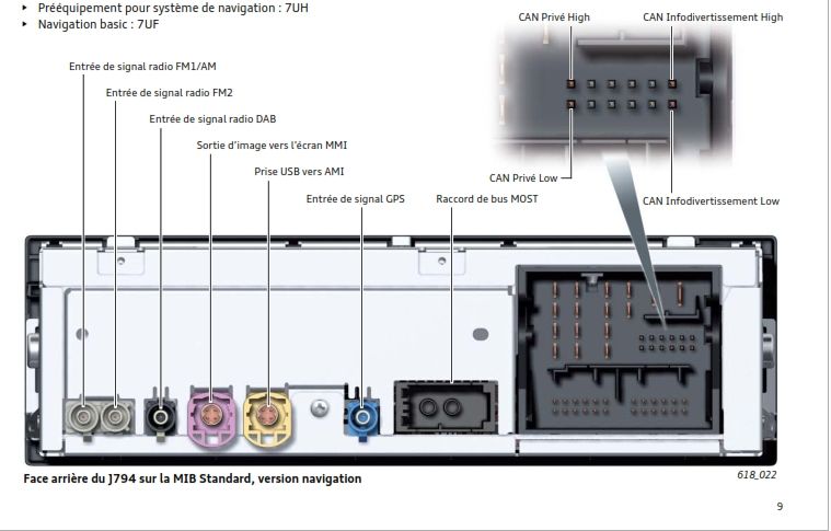

I did some research.
the new car radio has its GPS antenna and FM Antenna
what I found, it seems that I can forget
all cables and connectors, of colours,
white (FM radio) / blue (GPS) / yellow, (USB) /
the pink??? I don’t know! ....
Waiting for the response of the Chinese , can I forget these cables?

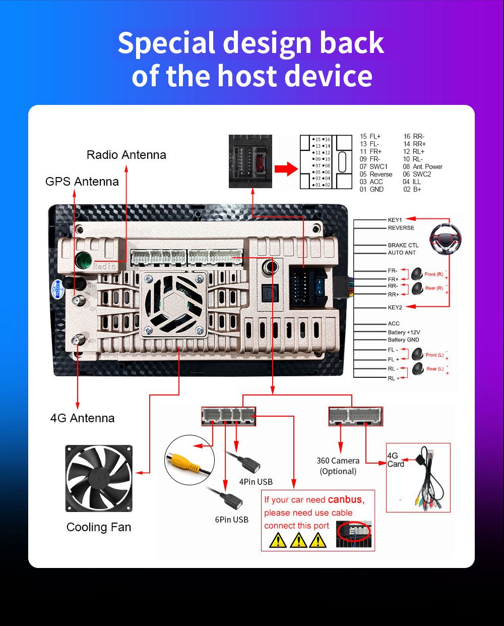

This picture explains everything. Buy an FM and GPS antenna adapter. Display cables are no longer available. The Chinese part is a display and radio in one. The standard USB is also missing. The dealer is not reputable. Otherwise it would say what is needed for installation.
A small criticism from me. If you want to implement such a project, you should be interested in it and inform yourself beforehand.

the seller, under pressure of "paypal" finally offers
to send me a longer cable to connect the multimedia (too short cable because it goes out to the navigation unit that is in the glove box and the screen is more haus in the center of the dashboard!
( 8 days that I explain to him , he answers me every time ,
"it’s good for you" ......")
so, everything seems clear, just a doubt about the thread key1 ,key2 , Ant , and my rear camera that is currently on the vehicle (how to recover the signal? )
I think (not sure) I can forget the cle1, the cle2, the ant! ?....
my rear-view camera, I do not know and the seller answers a shot yes...a shot no to shooting without detailed explanation.
