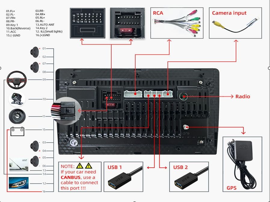

no problem , the seller will send me the cable longer than I need and I found the shematic of connection of the manufacturer (RSNAVI).
I think in a week (as soon as the cable arrives) everything will be ok! for my original rear-view camera, I will find a way to wire it somehow .
thank you
your camera is connected to the original Quadlock. There is a 90% chance that the extension will not carry this signal. So make an adapter yourself again...

the connection diagram of this multimedia that I got from the manufacturer (RSNAVI)

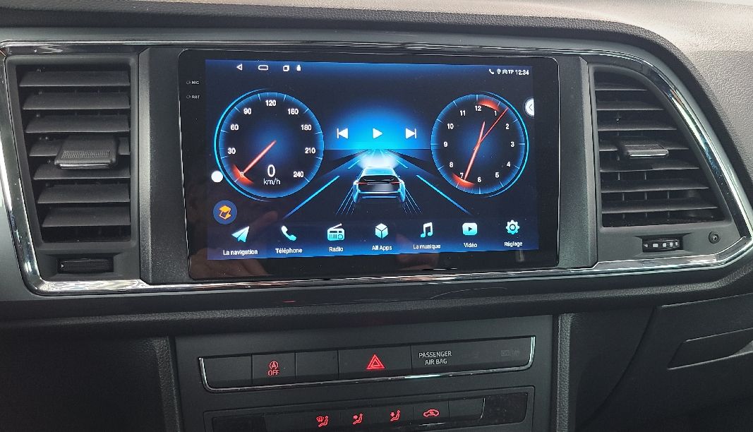

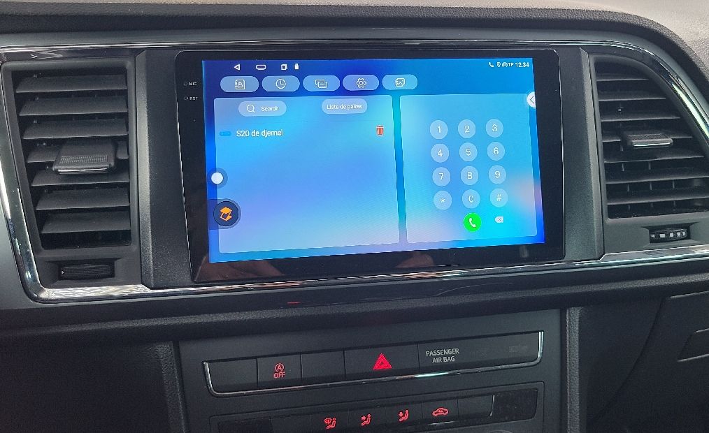

I waited before posting to be sure of the proper functioning .
verdict, it’s simply day and night compared to a mib2...mib3... !
Larger screen, everything is read, music, video, waze (gps)...
All steering wheel controls are recognized, even voice (phone) control.
the only thing that is not recognized is the rear camera , but it’s nothing , I ordered a rear camera (20€) which is special seat ateca which will perfectly replace the original one.

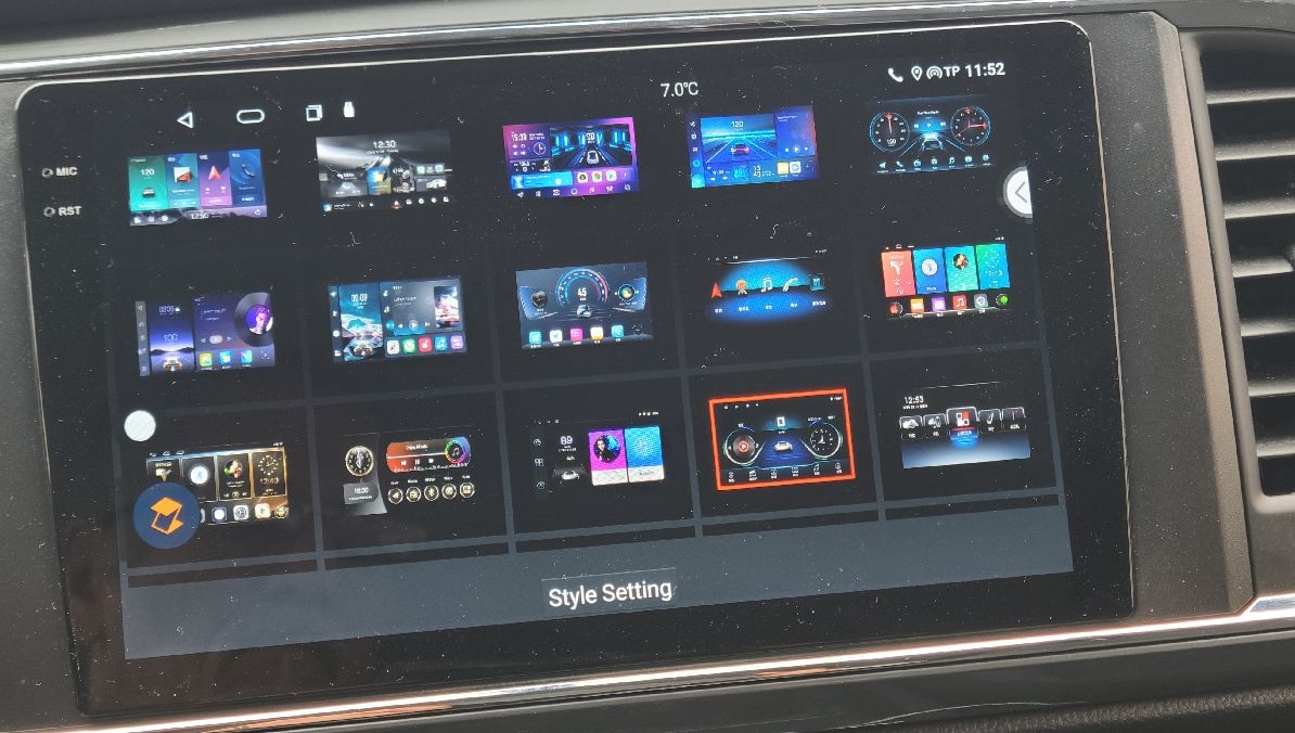

you can also choose your home screen,
some images , may be a video to show more , I do not know .
Bonjour à tous.
J'ai attendu avant de poster pour être sûr du bon fonctionnement .
verdict, c'est tout simplement le jour et la nuit par rapport à un mib2...mib3... !
écran plus grand, tout est lu, musique, vidéo, waze (gps)....
Les commandes au volant sont toutes reconnues, même la commande vocale (téléphone).
la seule chose qui n'est pas reconnue c'est la caméra arrière , mais ce n'est rien , j'ai commandé une caméra arrière (20€) qui est spéciale seat ateca qui remplacera parfaitement celle d'origine.
vous pouvez aussi choisir votre écran d'accueil,
quelques images , peut être une vidéo pour montrer plus , je ne sais pas .

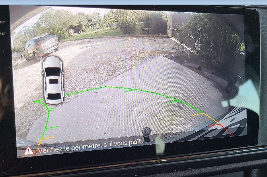

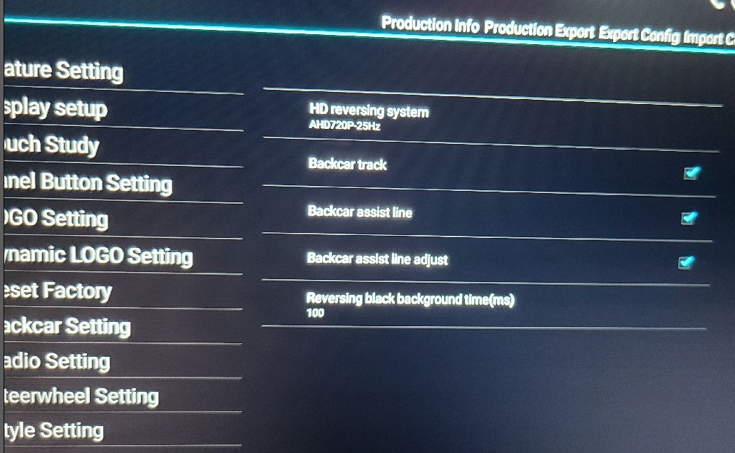

Hello everyone
I don't know if anyone can help me with this one!
after buying a reversing camera built into the boot handle
(different vendor to the multimedia vendor)
I can't configure it, I contacted the seller of the camera he told me
that, it's not the camera it's the multimedia, you have to remove the
the guidance lines on the multimedia options, but I've done everything, it seems.
I don't see where I can go to remove the rear guidance lines!
the multimedia salesman is completely lost! it's pointless asking him for anything, he doesn't know how to do it.
He doesn't even know what he's selling!
as soon as I bought it, on the second or 3rd question, he knew NOTHING!
I ‘wrote it down’ on my note, multimedia 5 stars, seller 1 star! ....

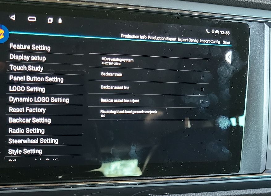

Does anyone have any ideas for removing these lines?
thank you
delete options ,everything, but, always these green lines
my camera rear

Are you talking about the white and green thread loops?
(on the camera link?)
tried everything!
After trying everything, I questioned the loops of green and white wire on the camera, cut the white and green and all possibilities, the only one that works and does not give a black screen, is the white wire (loop) cut and green wire (loop connected).
It is therefore the multimedia that creates these rear guide lines that indicate a direction (always the same) while the wheels are straight!

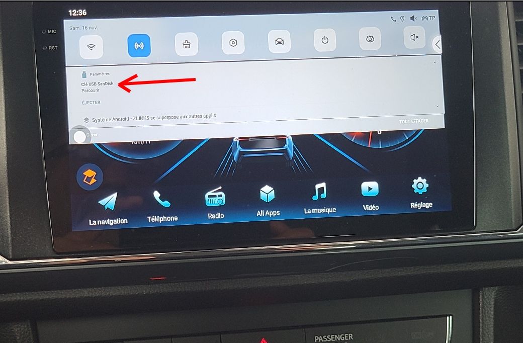

Show me please the Installd Firmware
