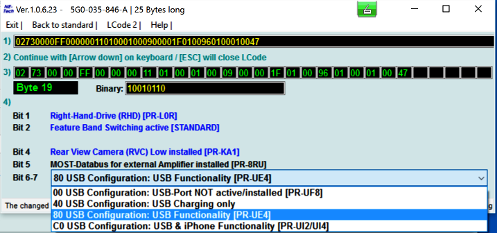

My current USB connector is 5Q0 035 726G and the AUX/USB housing is 5G0 035 222F, the radio unit is MIB STD2 ZR+/NAV 5QA 035 834.
I ordered the new USB connector 5Q0035726E and actiavion via VCDS is done by a friend (to say the unit that the new type of USB is connected). Maybe some new USB cable needed too lets see. That's how is possible to save 370€ :D (Lets hope it goes as planned).

@eggy did you make activation of fulllink trought vcds?
I have installed the new USB connector, we tried to activate it using VCDS (byte 19 if I remember correctly) but no change. It was a bit older version of the sw, so there were no coding yet, but we did not notice any change. I will receive my own cable soon and can try it with the latest VCDS. In the menus there is still the Full-link activation notice visible. :/
byte 19 on what component?

We tried this part.We did not see any information about the USB (only bits) and it is actually from German Golf7 forum, the unit should be quite the same/similar.
