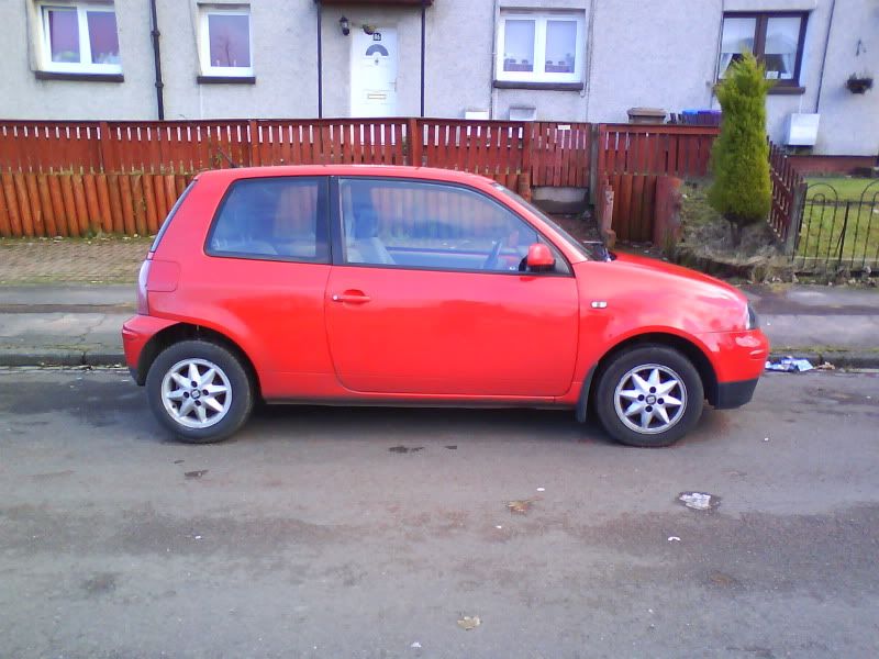

Ill make it as brief as possible, Myself and Jamiea7x from club lupo made a 1000mile round trip from glasgow to lowestoft in norfolk in a day ( yes we left at 9am and got home at 4.30am ) and drove through hail, sleet, snow, near white out conditions and brought the little car home back in december 2010. tragically, about a month after we got the car, the head went on it and it sat for a while untill we got round to fixing it. Time ticked on and nothing was happening, so i got a kick up the backside when we realised the tax was due up at the end of october 2011. Start the panic stations as it left us 8 weeks to get a car ready for an MOT and tax that hadnt turned a wheel since january. so the parts hoarding started.
heres some pics and specs

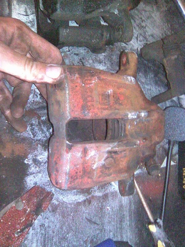

then the front brakes ( 239mm x 10mm ) had jammed as well due to sitting for so long so i got a set of VW Polo GTi front hubs, arosa sport calipers and carriers, discs and pads beefing it up to 256mmx20mm front discs.

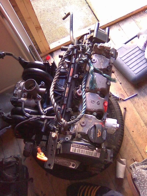

rather than trying to rescue a 131k mile engine, i decided that a heart transplant would be easiest, so i managed to get a new engine out of a 2002 seat arosa with 57k on the clock :D it was as a bare engine so i got the old throttle body and cleaned it up
and then built up the new engine as much as possible

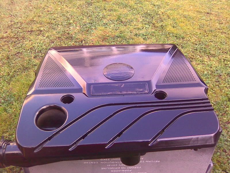

the engine cover after cleaning out the oil of it,
then after a clean up and a lick of paint

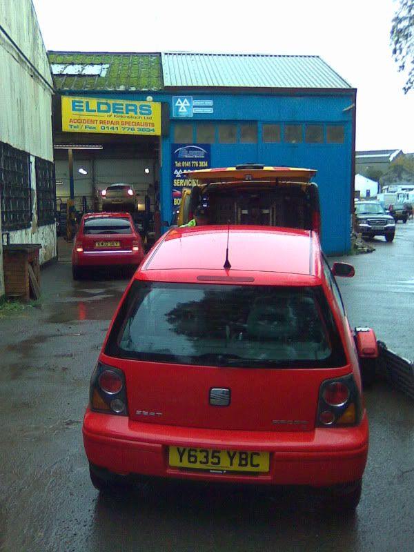

Sadly when we went to get the front brakes done, some moron had crossed the splines on the driveshaft into the hub so we had to load up the car onto Mr AA mans trailer and off to the garage to get the new hubs fitted along with the new engine.
To make sure the wheels clear the new brakes, the car will also be running lupo sport 14" alloys as its only rolling 13" alloys at the moment lol!
