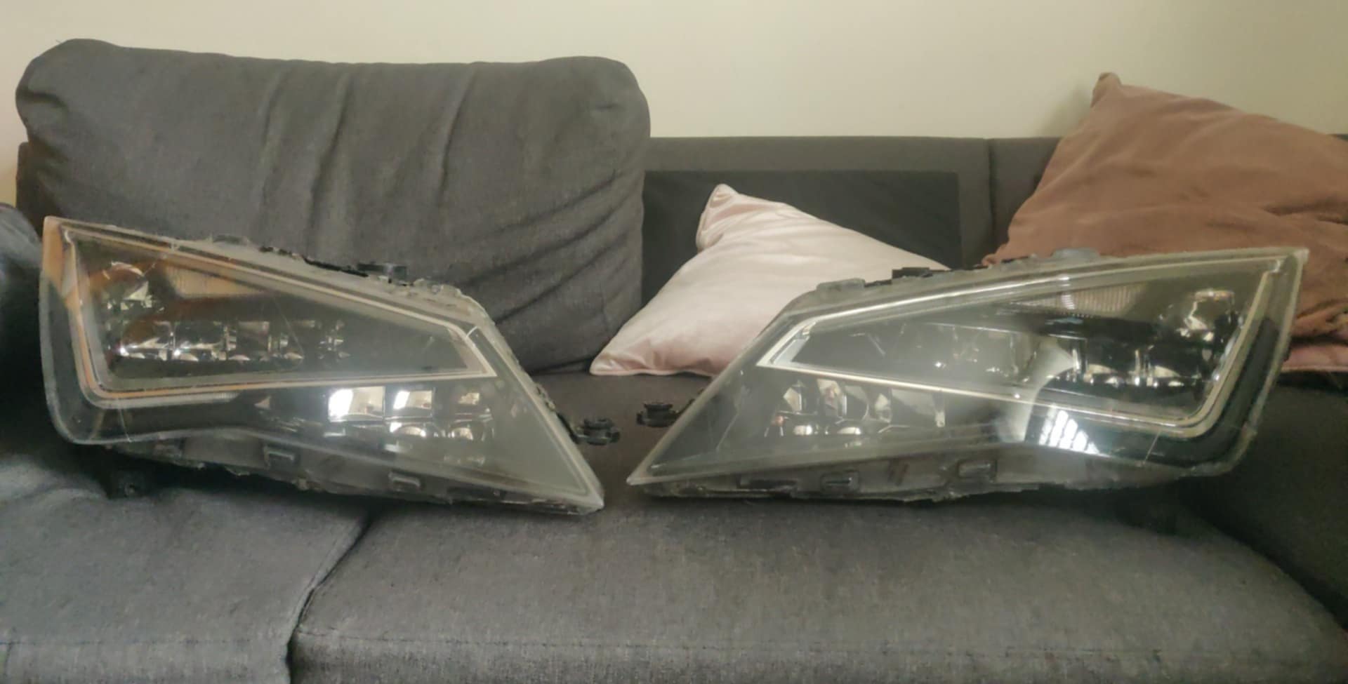

So I’ve got the mk3 Leon SE which obviously doesn’t have the LED headlights and instead has the halogen bulbs. I wanted to know if there was any way of installing that LED design into my current headlights to match the look of the FR facelift ones, I’ve got a picture of my headlights down below. Not sure if this is something that would require an extreme amount of work or if it can even be done, just curious. Thanks
I’d want to fit the light strip in to make it look somewhat like this, just the general shape of the LED.

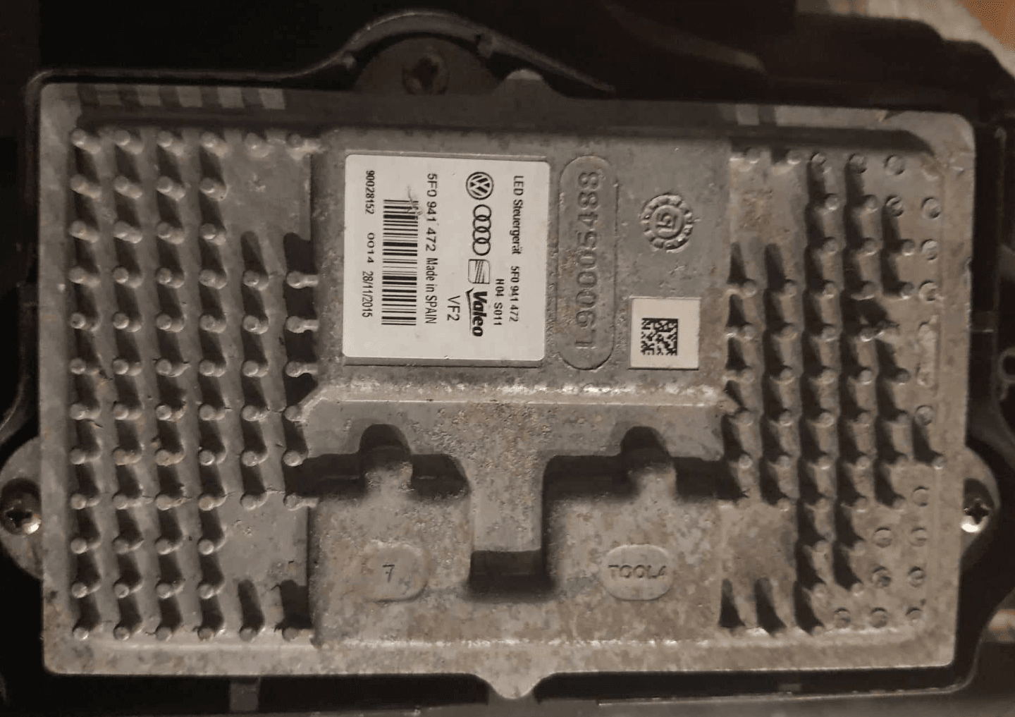

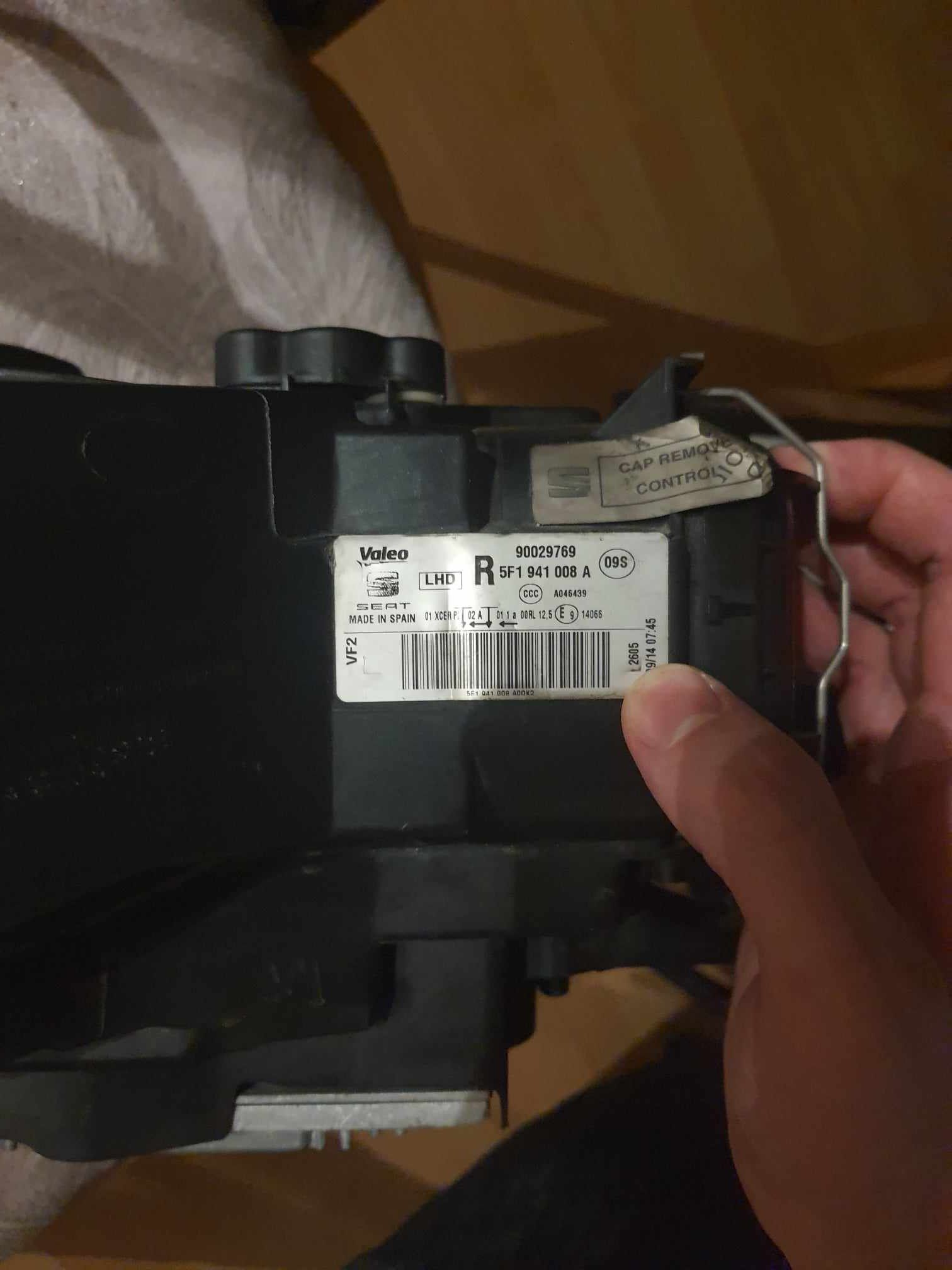

Yeah I get ya, its not the light really because any brighter the oncoming traffic gets beamed even on low beams. If its anywhere the same as halogens but with a cooler look I'm in. I've the L90028086 MBD DRL LED Modules on hand for both sides (not auto leveling ones). I'm just trying to find the perfect mind that can install them without errors. PWM Pulsing Fix Anti-Flicker Capacitor Link | HR H300 or GTR PWM Interface Modules promise a lot but will they work tho :rolleyes:?

You can't just fit a set of LED headlights - without the self levelling you will have endless issues with dazzling others, and they will not pass a yearly inspection either. LED lights cannot be manually adjusted, and need the level sensor fitting and working.
Those headlights you've put in your post are from a pre-facelift Leon, and they are known to be absolute crap as far as light throw goes. My previous Leon had them, and they were atrocious, especially in the rain. Changing from your standard halogen lights to a lower light output LED unit just because you think they look better really isn't the way to go. And putting aftermarket stuff in to try to fool the canbus into thinking things are standard can be a very costly mistake when the BCM gets fried.
