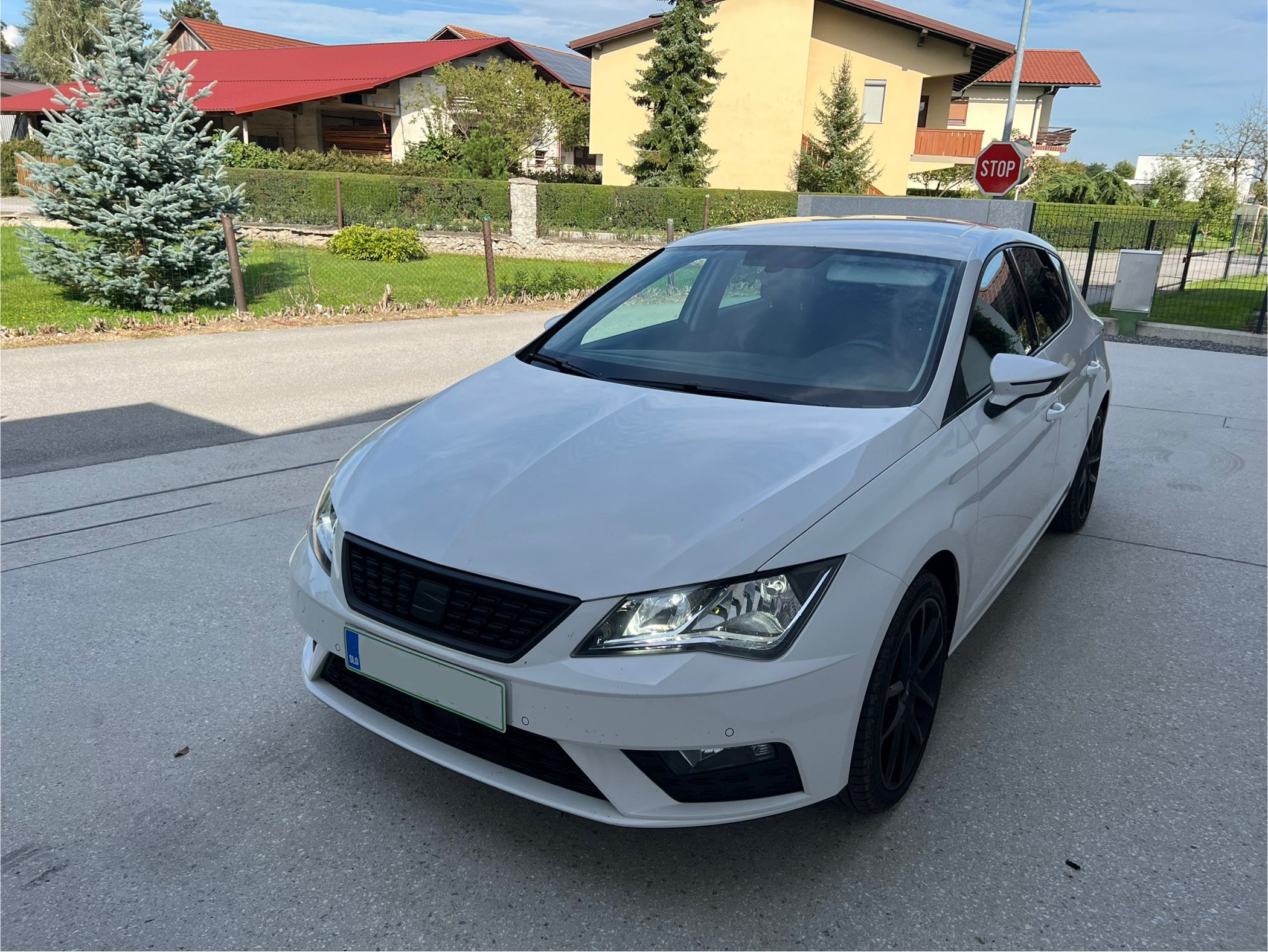

Hello I am from Slovenia and I have same spec Seat Leon mk3.5 SE and I decided to do halogen to LED bulb conversion. Due regulations I had to drive to official OSRAM partner business and they fitted light bulbs for me. These lights weren't cheap but they are definitely worth the money. Total cost was around 300€.

Thats usually the downside of adding LED lights in reflector headlights. In the NL its not that strict but other drivers are the ones who are blinded by them. And the driver itself is happy with the higher light output :LOL:
You made the right choice then (y)
I have to say its like a giant difference before and after so if anybody does have the money for lights I would recommend the conversion.
