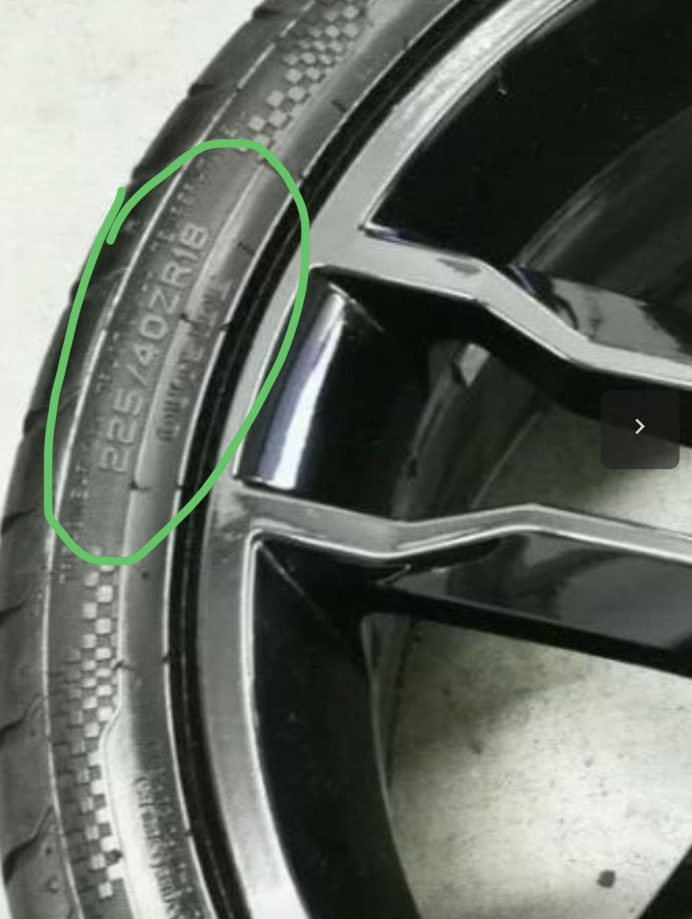

Will these 18 alloys fit in my Leon I currently have 225/45/17 standard fr alloys on and these mk2 alloys are 225/45/18

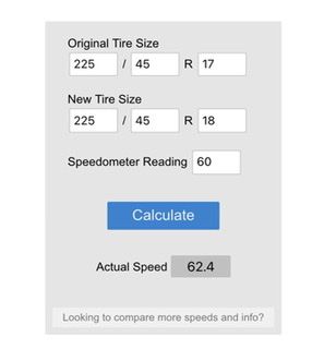

What’s the width and offset your existing alloys and the 18” set you’re thinking of fitting? - the spec of the alloys should be stamped into the reverse side of the spokes. If you use the calculator at www.willtheyfit.com and input details of your existing and new wheel / tyre set up, then it will calculate differences in tuck and poke so you’ll be able to determine whether or not you’d have any clearance issues.
Irrespective of width and offset of the wheels and potential clearance issues, bear in mind that 18” alloys with 225/45 R18 tyres will result in a larger overall circumference and rolling radius than your current wheel / tyre set up so your speedo reading will be inaccurate; it’ll under-read by roughly 4%, so when your speedo is indicating 60mph, your actual speed will be around 62.5 mph
The last paragraph of article at the link below states that legally in the UK, a car’s speedo shouldn’t under-read / should never, show less than the actual speed, so you’d need to consider changing the tyres on the 18” alloys to a lower profile to eliminate the speedo under-reading error.

Your standard 17" wheels are 7.5J x 17H2 ET51, if the MK2 18" wheels are similar offset (ET49 to ET 51) they should be OK, the only thing is that the tyres should be 40 profile not 45.
OP should check that the mk2 alloys are genuine Seat Alloys. If they’re replicas, then many replicas have a more aggressive offset than the OEM alloys, and may have a centre bore larger than 57.1.
The tyre size difference means the speedo won’t read correctry, if your original post is correct. The tyres are both 225/45, so have the same sidewall height ( 101mm approx), but one is 1” bigger diameter, so the 18” rims with the 225/45 tyres are a bigger circumference, meaning your speedo will under-read, by 12%. So at an indicated 30 you’ll be doing 33.6. And a a “safe” (from a speeding ticket POV) 35 you’ll be doing 39, and get nicked.

I think the speedo error will be less than 12% though; using a couple of the on line calculators that’ll work out the impact on speedo reading of changing the diameter / rolling radius of the wheel / tyre set up, both calculators suggest the speedo would be under-reading by around 4% - still too much though; it’s permissible for a speedo to over-read but it shouldn’t under-read. Screen shot of the results of one of the calculators is in my earlier post.

@black_sheep; well spotted on the tyre size! I wonder why the OP said they were 225/45 R18? Maybe the existing 225/40 R18 tyres were badly worn, and they’d found a set of well priced 225/45 R18’s that they were hoping to use as replacements.

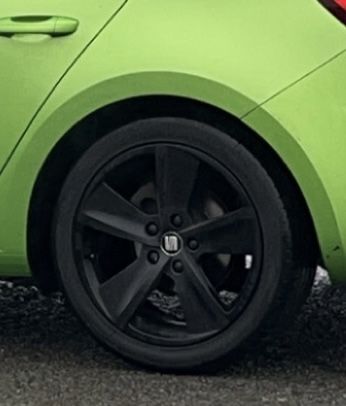

A bit off topic could anyone tell me what wheels these are I.E. product name, part number, I have a set fitted to my mk2 leon FR (BTCC) and I am looking to purchase one as a spare.
Any help would be appreciated.

Assuming you’re referring to the alloys in the pictures posted by @Jordanw20 in the first post of this discussion topic. If so, a quick internet search gives the part number as 1P0601025Q (size; 7.5J x 18, offset ET51).
If you do a search on the part number, you’ll see from the images that they’re the same alloys as those in post #1 above. Looks like there were two colour options - gloss black and what looks like silver (or possibly white? difficult to tell from the internet pictures), so if you can’t find a gloss black one, you might have to go for the other option and get it painted / powder coated to match your existing alloys.
