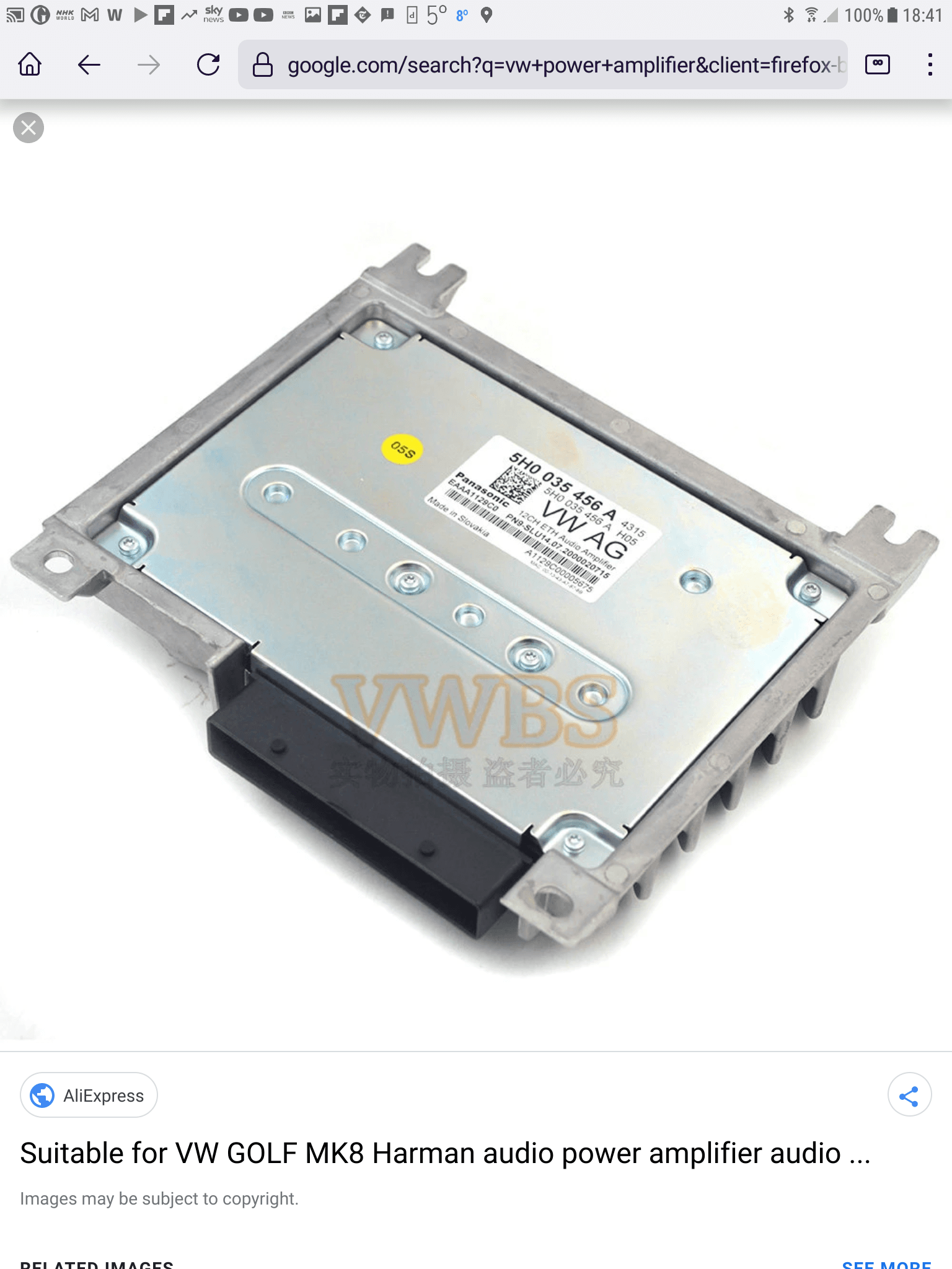

Reckon that's your AV power ampflier. They slap them under the seat.
That metal bit is the heat sink. The power amps came a bit late to Seats, VW and Skoda had them but Seat were deemed not worthy of outboard power amps.
See what @East Yorkshire Retrofits says.
Reckon it's one like this. You are looking at the top of it, base is like this if unscrewed.

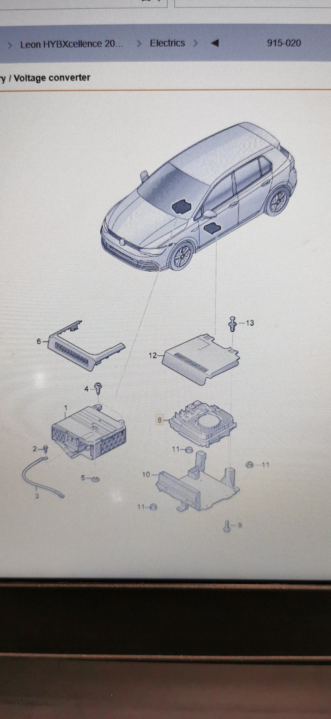

Your car isn't actually listed as having this fitted, going off the vin you sent
PR code for all of this is 0K4, your car has 0K3.
0K3 is PHEV (plug in hybrid)
0K4 is MHEV (Mild Hybrid)
However, the module is the 12v to 48v transformer
Cover is 5WA907318
Securing clip is N91158501 - 2 of these

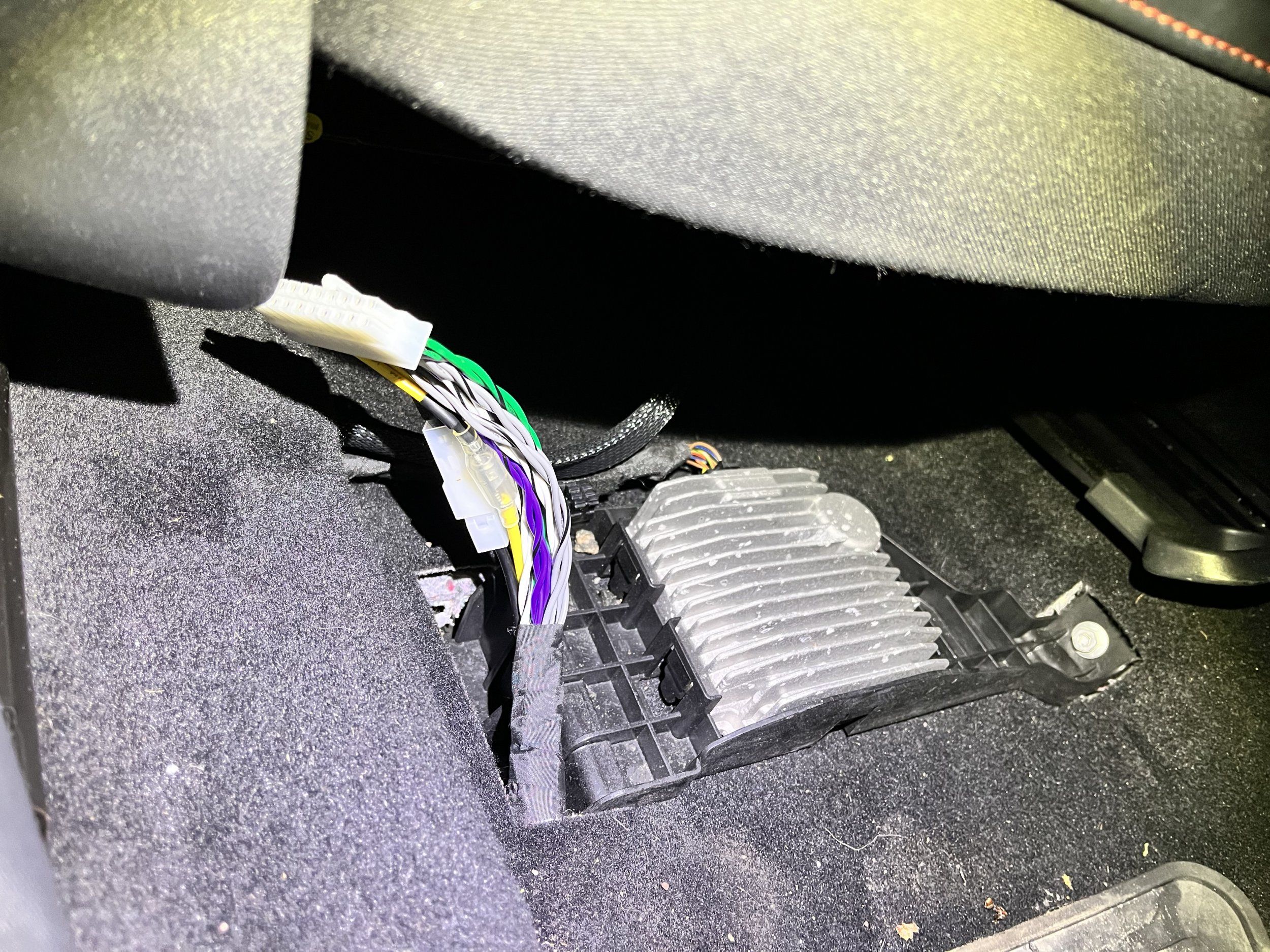

Just ordered these parts as i have the same metal box exposed under my seat. But now that i googled a bit more, i think these wont fit. I am pretty sure that part is ā€engine sound generator moduleā€ Part number 5QE035335B - atleast it looks just like it.
Should there be cover over it, as mine is exposed just like OP’s?
Just installed an amplifier and trying to find a good spot for it under there. Amplifiers wire harness is allso in the picture.
