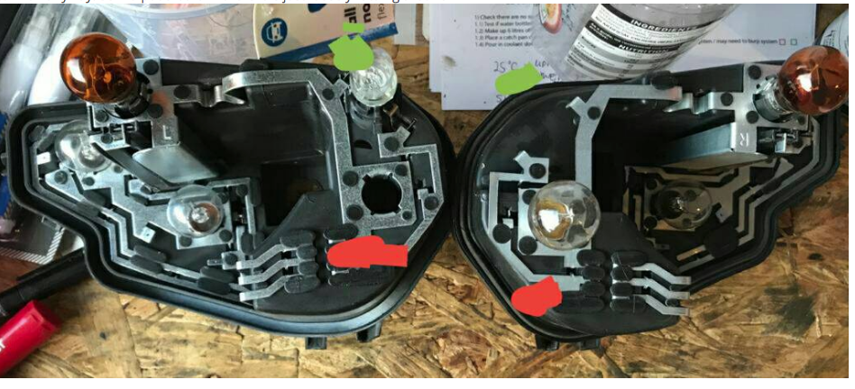

Hey Kanye. Well I took the lights apart and had a look. If you look at the green areas. There is a bulb which is the reverse light (left) but look on the right there is no means if even putting a reverse bulb. Then if u look in the red section there dies appear to be a bulb missing but upon trying to put a bulb there it is just an empty hole it has no electrical switch underneath compare to other red side so it wouldn't turn on anyway. So if u put a bulb in there it is just loosely rattling around

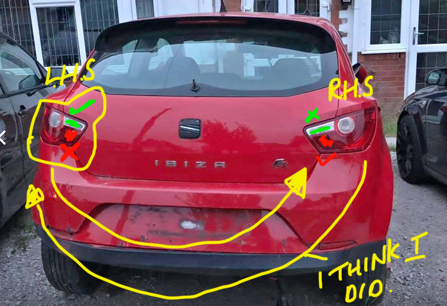

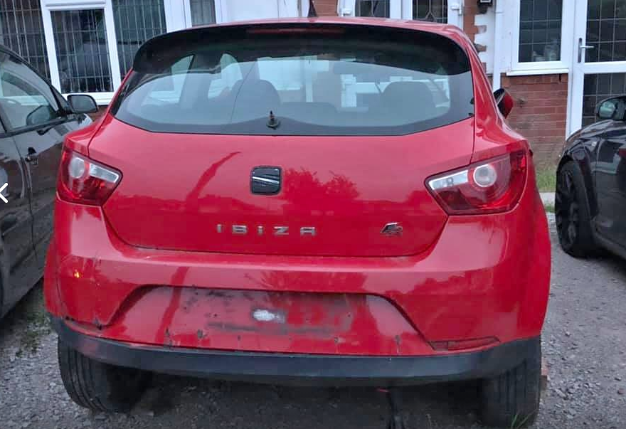

Ive found a picture of a seat from behind to try illustrate clearly what is going on, its an fr but i believe the rear lights are the same on my mom mk5 1.4 (see pics attached). Pic 1: Is jus so you can see things clearly, Pic 2: is what is working and not working & what i tested (sort of).
1) I tested all the fuses and they all are fine and working.
2) If you look at pic 2: The green areas are the "Reverse lights" what are illuminating and not illuminating marked with a Tick for working and a Cross for not working. The same has been done in red for the rear fog light - showing the side that is working and not working.
3) The yellow shows something i remember i did - i took the Left hand side light cluster circuit board and attached it onto the right hand sides electrical connector, now obvious it would sit into the hight area properly due to being on wrong side but the reverse light did light up when i went into reverse gear. so isnt this confirming that the wiring / electricals are working fine sine it lit up the other side?
4) i have uploaded the orignal picture of the bulb clusters, matching to the side / colour coding of the rear of the seat. and again it seems to me that the reverse light cannot illuinate on the RHS due to not having a means to do so, the same with the LHS rear fog light, again no means to do so?
Hope this helps, and please share thoughts, as mom has to take it back on friday, not for a re-test just the tester wants to look himself. We did also call seat and it is 1 reverse light and the manual also confirms this.
I forgot also - i cant remeber is i tested the RHS cluster on the left hand side electrical connector but that is surely irrelevant no??

The clusters would need to be connected to their correct side connectors as there will be unused pins in both.
So your picture confirms that the reversing and fog light positions are not the same, so that ties in with what you are seeing looking at the bulb side of the two clusters.
My only other issue with the cluster pictures is, there seems to be one bulb missing from the RHS cluster, ie both should have the same number of bulbs, just one side has one missing for the unused reversing light and the other side one missing for the unused fog side, what I am seeing is one bulb missing in the middle roughly on the side that has the indicator and the stop/tail + extra tail light, that is probably completely irrelevant but still not right as these cars probably pass an MOT with only one tail light working in each cluster.
So, back to your problem, you need to get the cables back into the car if possible (I seem to remember just wrapping them up in a poly bag when I was drying out and resealing the rear clusters of that late 2009 Ibiza), fit the clusters to their own connectors, put the car into reverse and switch the ignition on, then check remove the reverse bulb and carefully probe between its earth and +12V contact, if nothing there, check between +12V contact and a good body metalwork point to see if you can get 12V on a meter, doing that will go a long way to finding out what next to look at/for.

Thanks again for input. Again I'm a little lost as the two "white" sections on the headlight clusters in RHS AND LHS are surely the reverse lights and when u pull the bulb clusters out of both, they machine up the same. I've looked in manual and the illustration seems to be exactly as mine and there is only one reverse light indicated ( see pic )

Yes, as said earlier, normally only one reversing light is provided, the bus bar arrangement inside the clusters for RHD and LHD will be slightly different but the actual outside or lens covers will be the same, so that is why you can see 2 white areas when only one side is actually a wired and working reversing light.
Can you also see what I was talking about one bulb missing from the RHS cluster picture of your mum's car's cluster, ie one tail light bulb is missing as far as I can make out.

Hey Rum.
I believe I think I can see what you mean with the bulb. I have another pic with better angles. So if you mean it's. Missing in the green circle - then yes but it seems to be an inoperative anyway as it is literally a plastic emprt hole. If you mean the yellow circle it is there just the previous picture was hiding it some. But if u mean in the red areas those are just empty hollow areas and no bulb can be used there.
Apologies for constant asking from you. Just when it comes to all things Seat you see to know it all and I am a basic DIY at best so if you think somethings wrong I'm likely to think so. So from my point of view should I tell my mom not to bother taking it in as you do in fact think it's a fail or do you see what I'm thinking to why the MOT test centre may have their wires crossed with this reverse light not working.

That is good that you cleared that up, yes it was the yellow circled one, so that is okay, and I can see it now.
The MOT would not fail that car for only having a single reversing light as that is what it had when SEAT manufactured it, so if you can not get the reversing light, which will be in the LHS cluster to light up, then you still have an issue that needs resolving, either wrong style of bulb fitted, car manual should give descriptions of all the bulbs used plus normally VW Group mould that info onto the bulb holder section of the cluster, or wiring problem or switch problem, that is as you have already checked the fuses.
