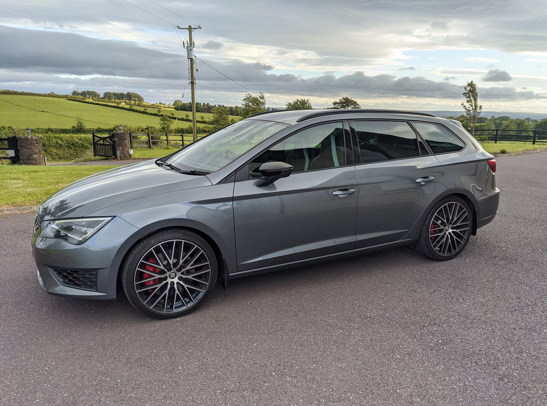

Fitted mudflaps on my Cupra ST
Rear: OEM partnr. 5F0075101D
Front: Rallyflapz black Kaylan
Thanks for the info on the ST. I'm late to the party but standard Leon fronts and the FR ST rears (part no 75101D) fit perfectly.

Very nice! Just a word of caution in case you're not already aware: over time, grit can get trapped between the front mudflaps and the wing and sill causing damage to the paint.
The way round this is to stick a piece of helicopter tape behind them.

Helicopter tape or black silicone sealant, which is what I ended up doing with my 280 and another forum user has done recently with their Cupra Ateca, I have also used sealant again on my Cupra Ateca as the gaps around the mudflap are not too large. My initial concerns of grit sticking to the sealant - imagine a clay bar falling on the floor - did not occur or present any problems.
