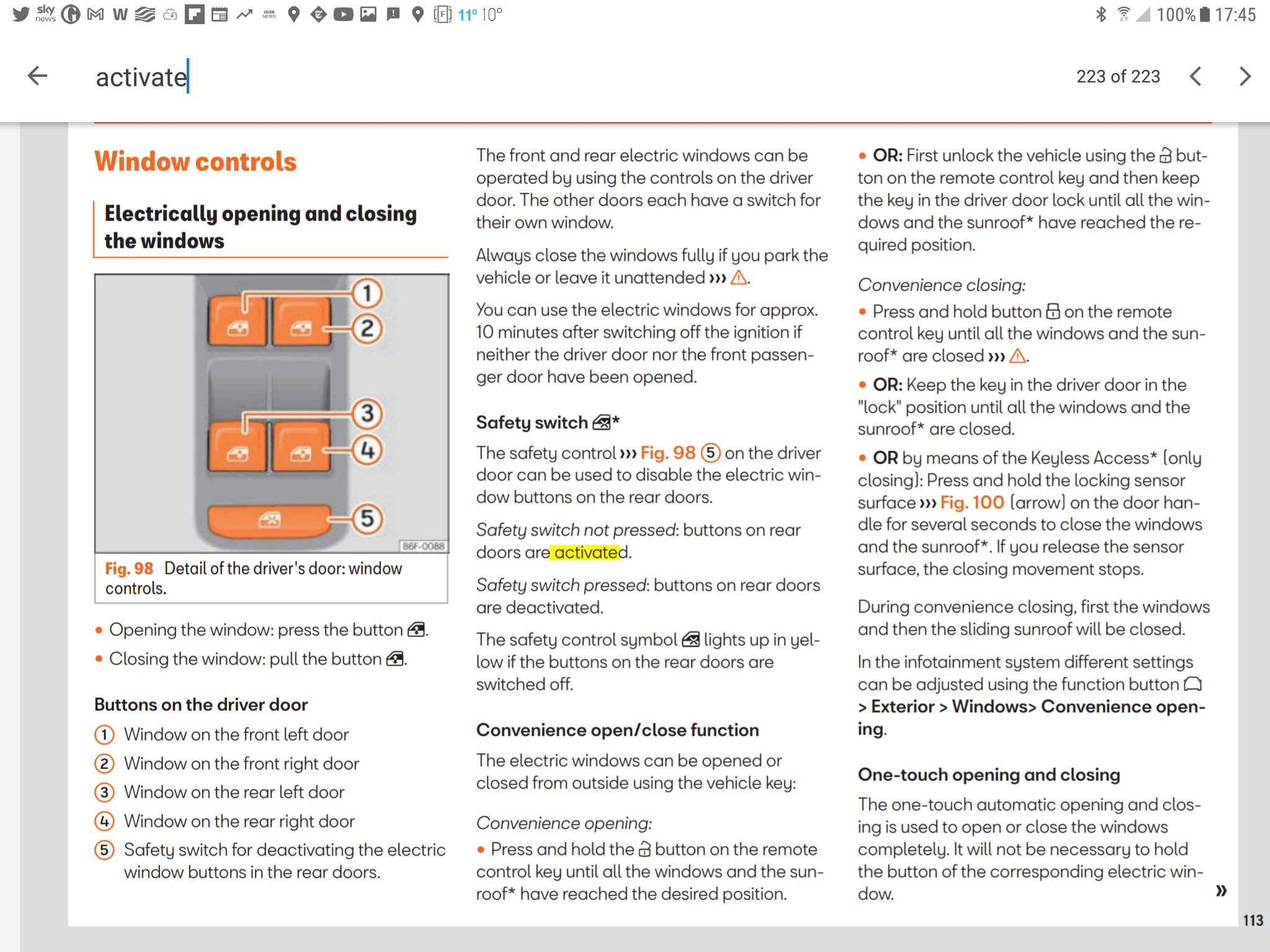

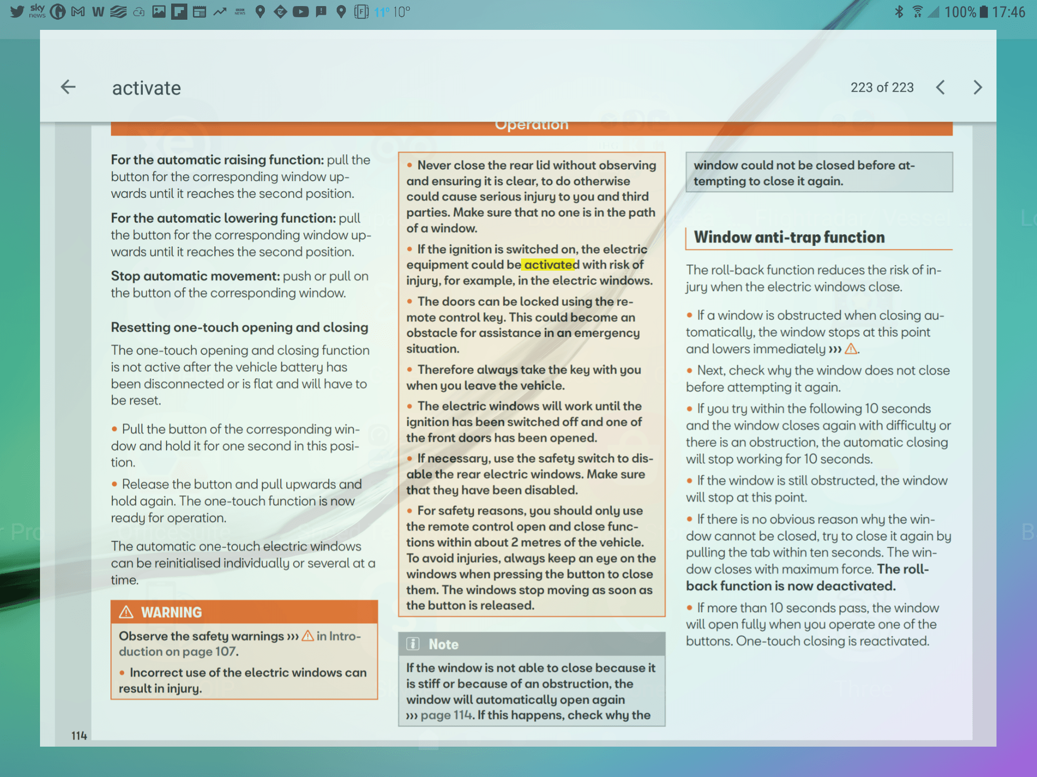

I would have thought the battery would be under warranty so the dealer is trying to wiggle out of it.
On changing the battery the Ateca needs the window retrained so opening and closing works on the windows and mirrors in on the Kessy. probably a similar procedure is required.
Ateca:
Resetting one-touch opening and closing
The automatic open and close function will
not work if the battery has been temporarily
disconnected. The function can be restored
as follows:
– Close the window as far as it will go by lift-
ing and holding the electric window switch.
– Release the switch and then lift it again for
1 second. This will re-enable the automatic
function.
If you push (or pull) a button to the first
stage, the window will open (or close) until
you release the button. If you push or lift the
button briefly to the second stage, the win-
dow will open (one-touch opening) or close
(one-touch closing) automatically. If you op-
erate the button while the window is opening
or closing, it stops at this position.
Does the Leon 4 have one touch... ?. Could try that procedure if one touch has stopped working.... might fix the rest 😍.

Not sure whether that is a Leon 4 but suspect activating the automatic open / close function described in the cut and paste above kicks other system to life, whilst the deletion of event just removes them from memory but perhaps that's required as well....
Attached pages 113 & 114 of the Leon 4 manual on retraining the windows. Also on the Ateca people said you also needed to fumble the rear window lock as well since that resets.
Ateca:
as follows:
function.
I tried this with resetting the window but still no luck :( Hopefully the garage can sort it out and find a solution🤞
