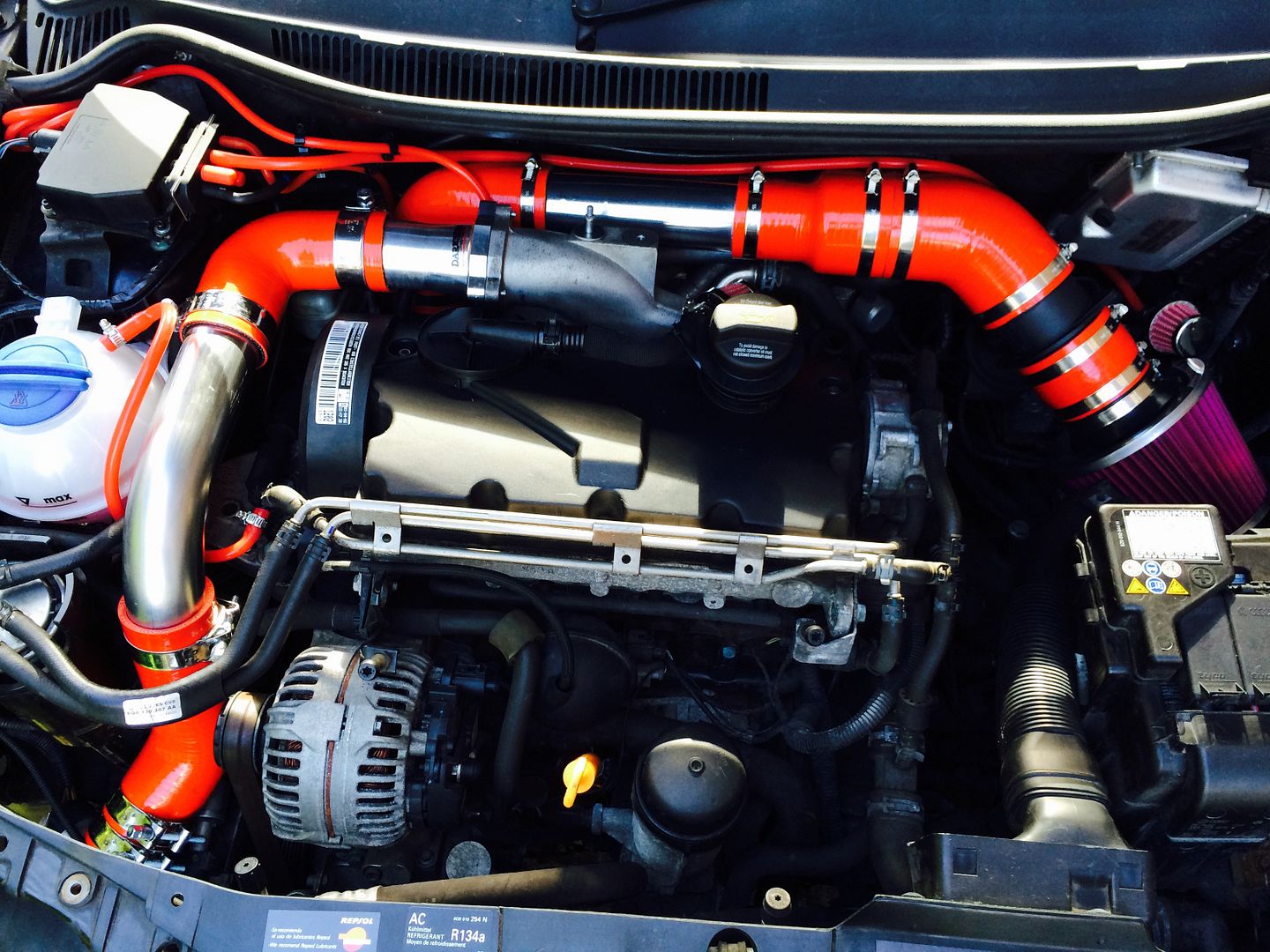

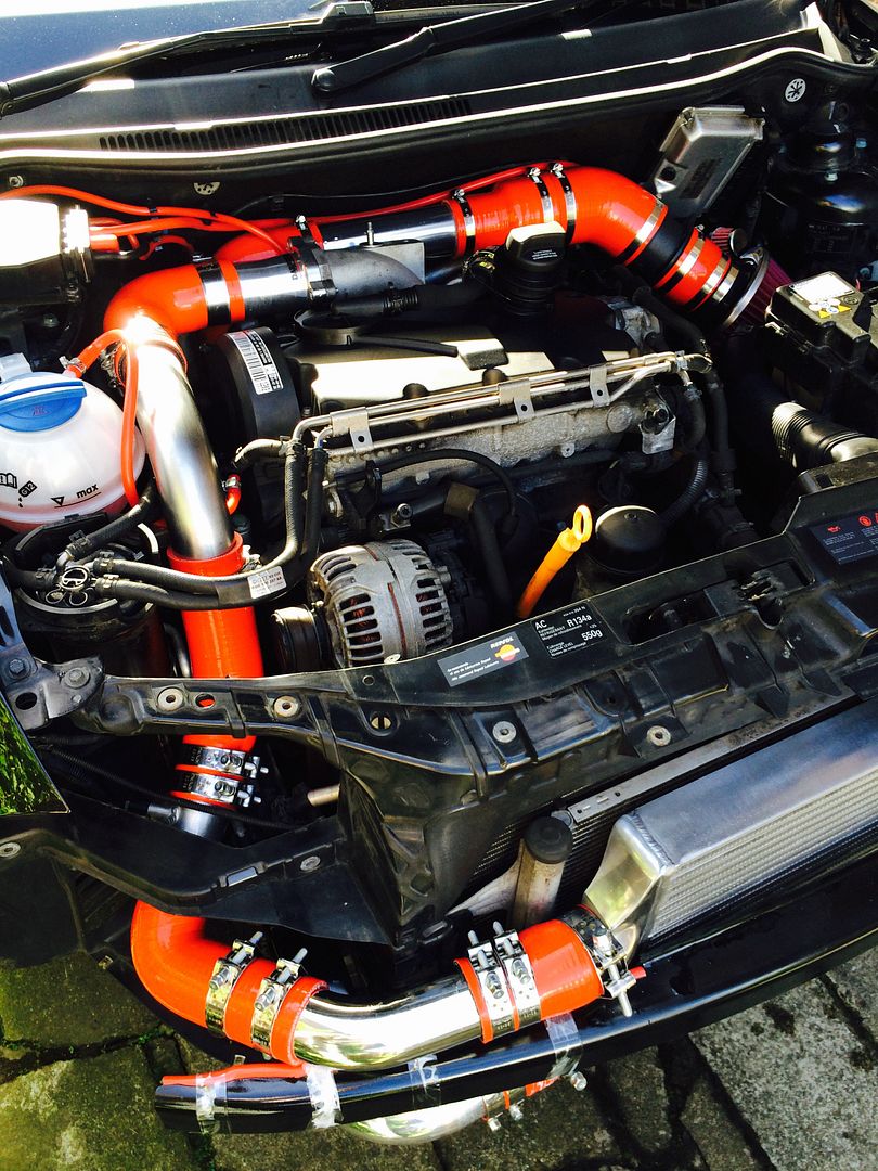

Hey guys!, love my cupra to bits! Purchased it a couple of months ago then I found a Boost leak! :/ so instead of patching it up
like a normal person, I designed and made a hard pipe/hose kit all the way around from turbo outlet to turbo inlet! and threw in
a EGR delete whilst I was at it! On the bottom pipe I found out it went flat and restricted so doing this was very pleasing :) -
after this I decided to upgrade the intercooler, even though the seat sports intercooler is already fantastic I opted for one with
a 70mm upgraded core! - after this I noticed the intake, where the MAF sensor is its 80mm but follow it back towards the turbo
and again another weakness it goes flat!! So I had to take it out and design a intake kit too, to take out the rubbish pipe and create my own
that goesa healthy size back to the 80mm towards the end. All the vacuum lines are important and have also been replaced by silicone hoses.
Here are some pics below, lot of money and work went into it thus far lol

how did you go about designing and making the pipe kit?
got an ibiza cupra tdi myself and found a fair few boost leaks so wanted to see about doing this to mine
did you just buy some generic pipes and then cut and position them appropriately?
Hey! Yea noisy leaks are a pain you have to have the right type of mind to do it if that makes sense and
A lot of patience ! I started by visually having a look, hacking car got my notepad and sketched my new
Path I was making, then chose a size, then measured and cut to fit, spent quite a lot to make it what it is!
I'm pleased to say it's made a noticeable change in throttle response!

Bought a seat sports style cooler with upgraded 70mm core. And I sourced a large red universal filter that wasn't oil based. Love it!
Hey, well both have there advantage! But for this particular type of car
And the layout I defo advise the double. They both produce similar types
Of results and it was designed this way for a reason, they best results for
Throttle response and torque concerning intercoolers is always best to
Have the most direct and shortest distance with as little bends and the
Double design allows this. Plus mine has an larger 70mm core.
