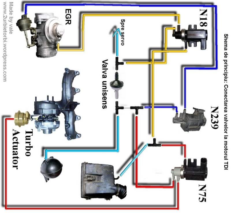

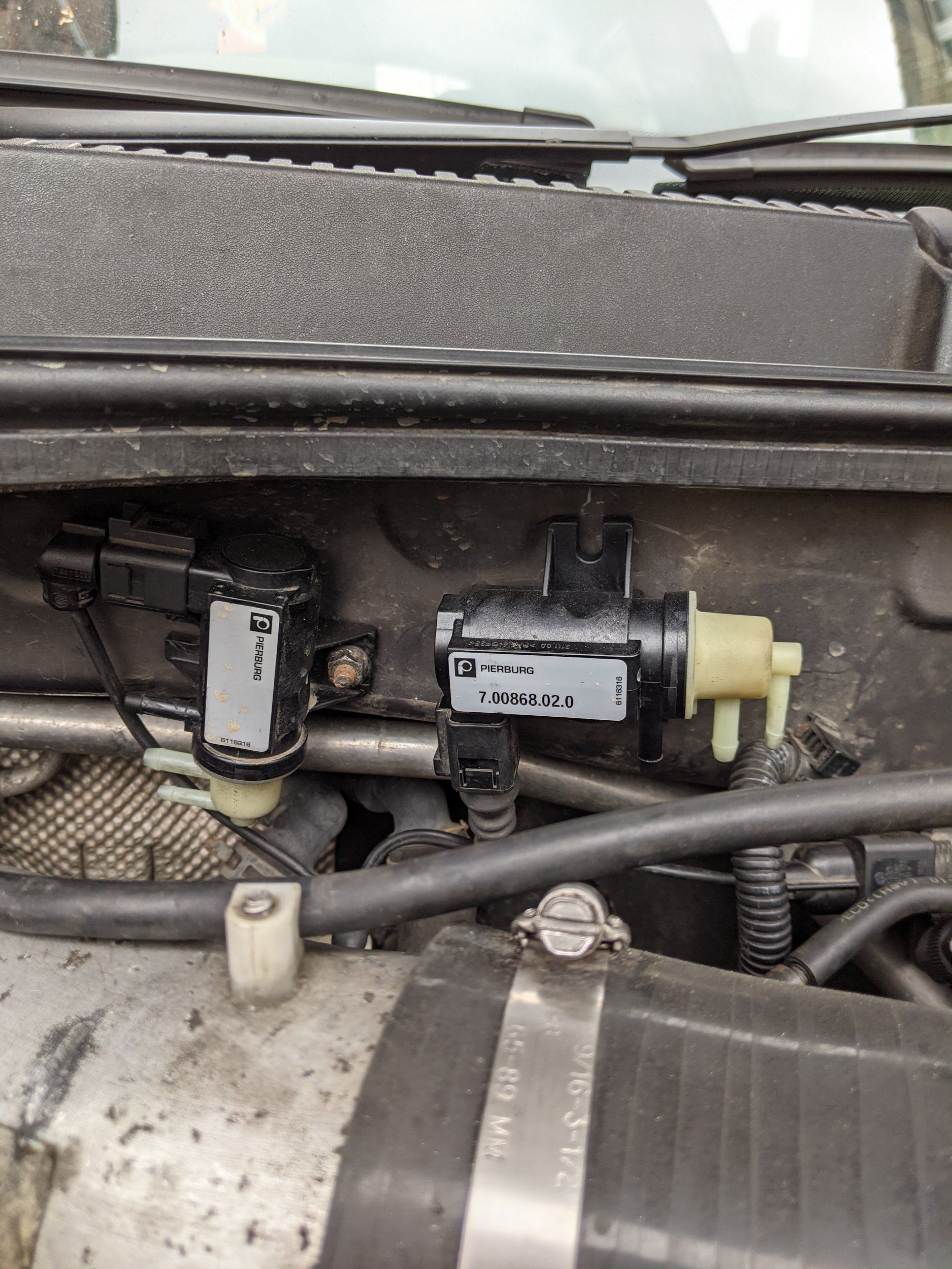

Hi I was just wondering if my n75 I mounted the wrong or does it not matter. Was also wondering does it matter what hose connects to the nipples on the n75? And if so what goes on what? Thanks
No idea about if the way up makes a difference,
