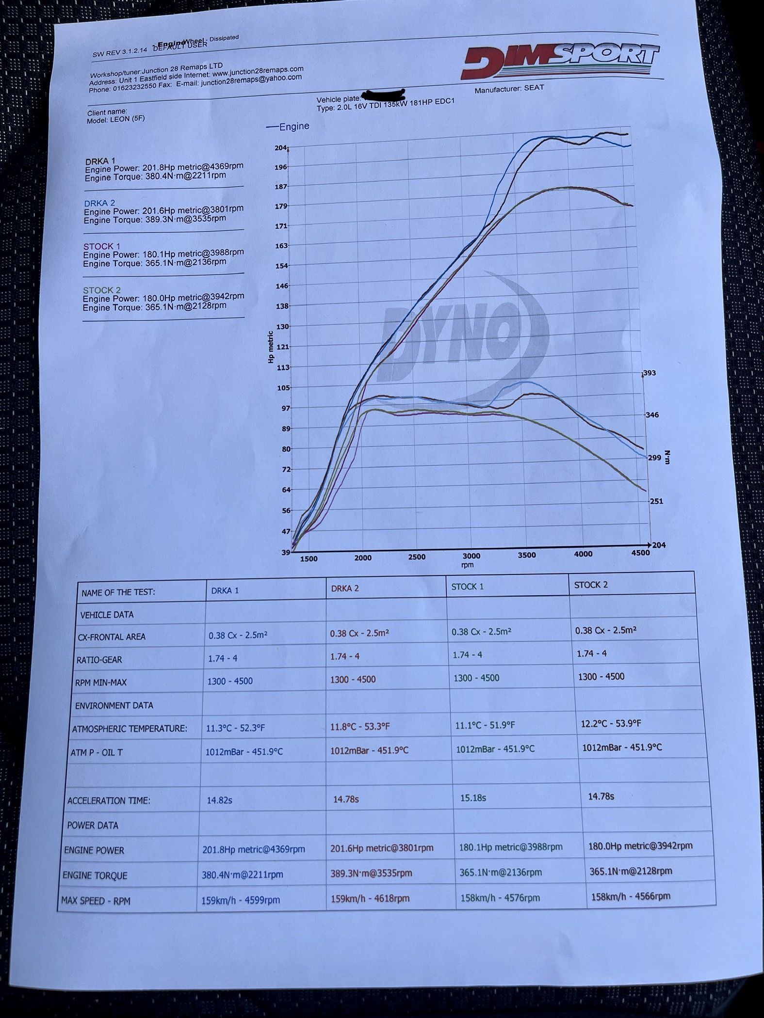

Hi guys I bought a 2016 Seat Leon 2 litre 181 bhp model in September from available car. It’s done 42,264 miles, I had a quantum tuning map put on around a month and a half ago and I have never felt any difference in the cars performance.
So this morning I decided I was going to get it on the dyno and find out what’s going on, the gentleman did a fair and honest dyno run, he wasn’t trying to sell me any map with his services or giving me the old my map will be better that that jargon trying to sell me stuff.
So the gentleman dyno’d It with the quantum tuning map on first and the cars producing 201bhp & 380nm of torque.
He then flashed it back to stock and the cars producing 180bhp & 365nm of torque.
Now my question is obviously in my opinion the Map that has been put on that is apparently a very good map from quantum tuning that cost me £250 is not a good map at all & I will be speaking to the person I took the car too, to get my money back.
But also are those figures for my car at stock good and should I be happy with them or could there be any issues with my car? I’m assuming the stock HP of 180 is good and what it should be but the 365nm is that something to be concerned about as I’m sure stock it should be 380nm or should I be happy with 365 or could there be an issue with my car somewhere and how would I know what that might be?
I’m just looking for some advice and guidance on what to do next, as this has really disappointed me this morning, I knew the car just didn’t feel any different with the map and I kept trying to convince myself it did but I knew it just wasn’t knocking my socks off.

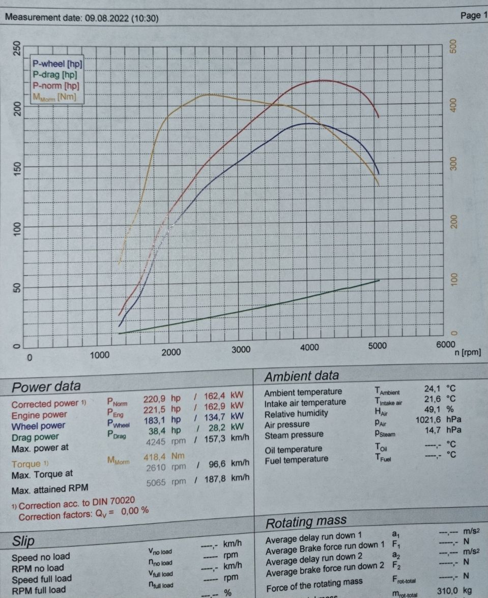

As it's the 184FR TDi it should be around 220BHP after a good map. Wished I'd had mine dyno'd when it was remapped, just for peace of mind, but they didn't have time.
The missus has a 184TDi and we had it mapped in August with a Racingline map.
Stock the car made 179bhp and around 360nm, after the map it made 221bhp and around 430nm. These are all figures from the dyno.
So stock it made the same as yours however after the map it was significantly better. If you can, get a refund and take it elsewhere, I'd highly recommend getting a Racingline or Revo map.

You dyno'd 201bhp so to say the remap is not very good isn't quite true.
It has 21bhp more than stock so the remap has done "something"
There could be an issue with the car. Who's to say another tuner can get more than 201bhp? Maybe turbo's a little tired.
You have 2 chances of a refund. No hope and zero hope

Done something but not what I paid for it to do, I paid for a stage one remap and if you look on quantum tuning’s website the proposed figures for my car are stock: 181bhp tuned: 220bhp & stock: 380nm tuned: 450nm.
So I’d say that isn’t a good map and isn’t acceptable when I’ve paid £250 and haven’t received the stage one remap I was sold.
And from looking at the graph the power and toque figures are to late, the map should be producing the power and torque much earlier down the rev range.

But the stock dyno run figures of my car are pretty much where they need to be, so surely that means there isn’t anything wrong with my car?
Yeah in all likelyhood it's the map, but there is no real way of proving it. I'm sure they cover their asses in the terms and conditions too, most likely they will say the figures are an estimate and will vary car to car, which is both true and the perfect get out clause.

Not quite. Your car may be okay at stock power. However at mapped power your turbo may not be able to produce enough boost / you may have an intercooler / boost pipework leak that only leaks at higher boost pressure than standard.
There are a lot of variables.

Some very valid and fair points there, these are things I can get looked at, if I was to go to somebody else for a custom dyno tuned map I’m assuming if there were any boost issues whether that be from the turbo, an intercooler, boost pipe, any leaks etc the guy doing the tune would surely be able to pick up on something like that while he’s doing the tuning and give me feedback regarding it and get the issue if there was one sorted out I’m assuming?

This bump in torque at 3250 looks wrong to me.
Diesel remaps you would normally expect the torque to continue climbing where the stock tune plateaus.
I would go back to quantum - and ask them to correct or refund.
Didn't notice that when I first read the post.
That doesn't look normal at all, here's a pic of our dyno printout. There's a slight bump in torque around 3500rpm but nothing like that.
