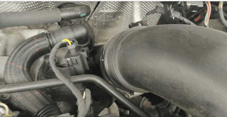

I am getting engine error and have put an OBD2 device and am getting a P0140 error code and it also says
02 Sensor Circuit No Activity Detected Bank 1 Sensor 2.
I need to check the sensor ro see if it needs cleaning but cant find any guides for this model on youtube or google search. I have searched pictures of the MAF sensor for the Leon but they dont look like what I can see under my bonnet. I presume the sensor is the part here with the yellow electric cable, is this correct? If so how do I remove it?
The MAF sensor is a Mass Air Flow sensor so it is always in the intake pipe. Look along the intake pipe starting from the airbox and you'll soon find it.
You can take them out and give them a blast with carb cleaner but if it's faulty it's probably best just to replace it. Check the wiring too. I know a guy who replaced loads of parts on his Kia Picanto before discovering it was a broken wire all along.
You don't have a MAF on your Gen 3 EA888 1.8 engine.
Your code:
getting a P0140 error code and it also says 02 Sensor Circuit No Activity Detected Bank 1 Sensor 2.
Is for an O2 sensor - not a MAF.
