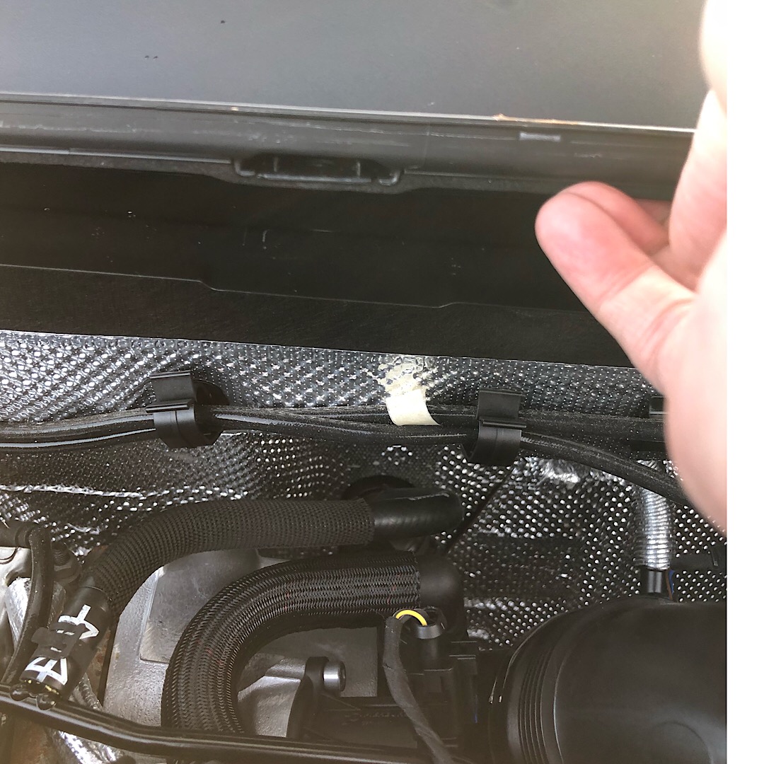

Hi, wondering if you can help, i just tried to unplug my sound Aktor as it drives me mad in cupra mode !
Removed rubber and clips as per first stages on all you tube vids i can see, however on my MY19 model there is no central split in the wiper cover as in all the videos (see pic) so without really forcing the cover I just can’t get my hand in the gap to access the Sound Aktor let alone the plug. Does your car have the central split or is there another way ?
My first choice would be OBDeleven to turn it off but by the time ive bought the kit and the android device (i’m an ios user) to use with it I would of spent around £100 which is a bit excessive as I only want to make one change

carista supports ios and i suspect can turn it off or give a shout out to anybody with vcds obd11 or carista to turn it off for you

Hey, no central split for me either - it is entirely different to the Golf R videos on Youtube. Once the clips and rubber were removed, I used a flat knife to remove the plastic plug thing on the left side that was holding the cover down. I was able to make a gap just big enough to squeeze in and pull the plug out.
I'll try and get a picture this evening.
I probably just have very small hands :thumbd:

Many thanks @cola dont worry tonight though , I have ordered the carista on amazon prime so gonna give that a go first. I will let you know if I need help though !

Hope this may help, this is the method I did to unplug mine.
Top left (driver side) you’ll see the sound Aktor behind the black plastic mesh.
1, Remove the foam 1st
2, Remove the Plastic plug as in pic this will release the black plastic mesh I then wedge the plastic mesh up enough to reach the cable plug.
Hopefully this will help you unless you’ve got man size finger unlike my girly hands haha.
Job done!
