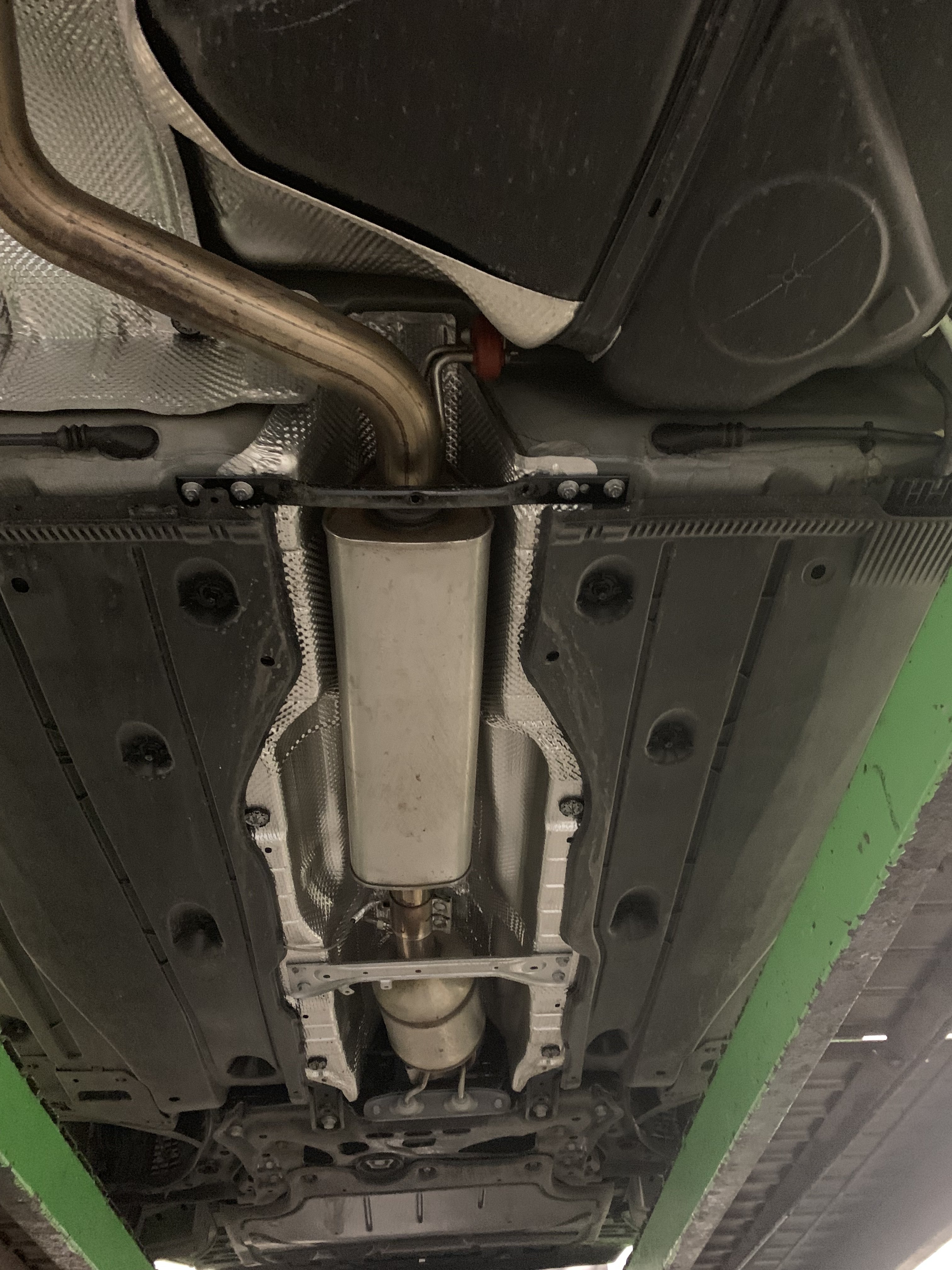

What do you mean by wrong part? Someone sold me a Vag sports res delete from the cupra Facebook page hope this fits...
I think you might find it will not. Especially if you have a Cupra 290 which I suspect you have with it being a Cupra Lux.
The VAG Res delete probably came off a 289/290/300.
There is no Red Delete available for the new 290 models at the moment from what I’ve read ( I have a 300 so gave only read the thread in passing).
Vag Sport is one of the companies I've been speaking with who have confirmed they don't do one for the new 290 yet and have even asked me for pictures of the exhaust so they can see... So they don't even know what the new one looks like
