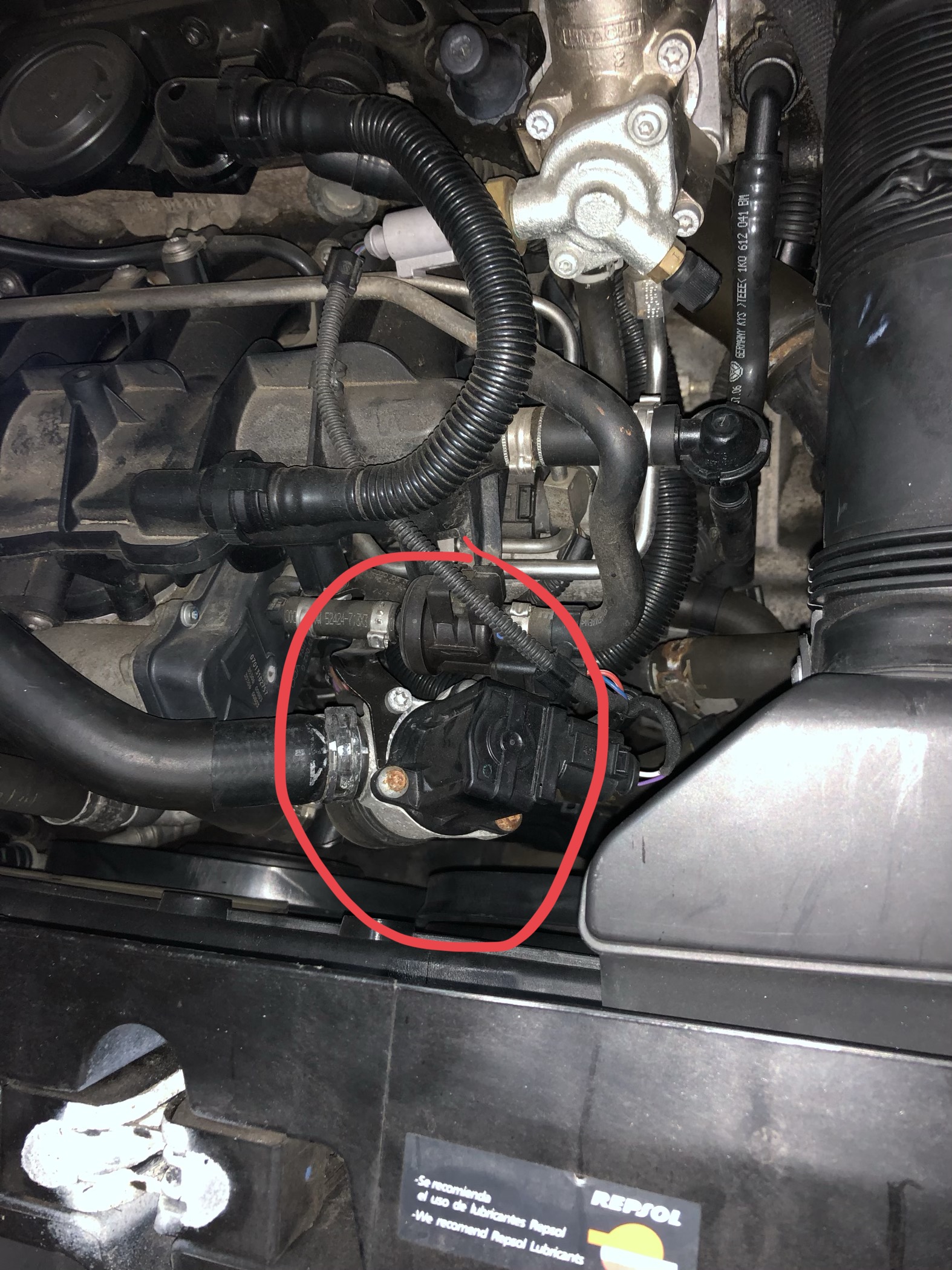

Engine cover has been off, had a very quick look.
The circled red bit is the DIverter Valve right?
Do I need to check hoses coming from there, what exactly am I looking for.

Yeah it is. Looks like it hasn't been off in a while. You can remove the screw on the bracket holding it still. Then the 3 screws fixing it. Then it pulls apart like a kinder egg. Be careful when you remove it you don't drop any of it down the pipe.
That’ll be a job for the weekend that. Could that valve be causing the weird turbo noise?
I’ll try recording the noise tonight on my run into town.

I'd check what revision it is and if it's torn for starters. The new G's have a blue diaphragm me thinks. This is the older D:

Since it's raining and you can't do anything you might want to watch this. Interesting at 3:45 he says "a torn dv makes it sound like you have a blow off valve".
That’ll be the trick then, is It worth buying one of those updated aftermarket valves?
I only really plan on going stage 3, but not yet; while I’m there though, ya know. Preventative maintenance and all that

Hmm. I considered gfb+ or rev g OEM. In the end I went for rev g. I've seen mixed reviews of the aftermarket ones. Some reputable tuners don't like them. And from what I've read may require maintenance every 6 months. I'm currently 2+ and had no issues with OEM.
