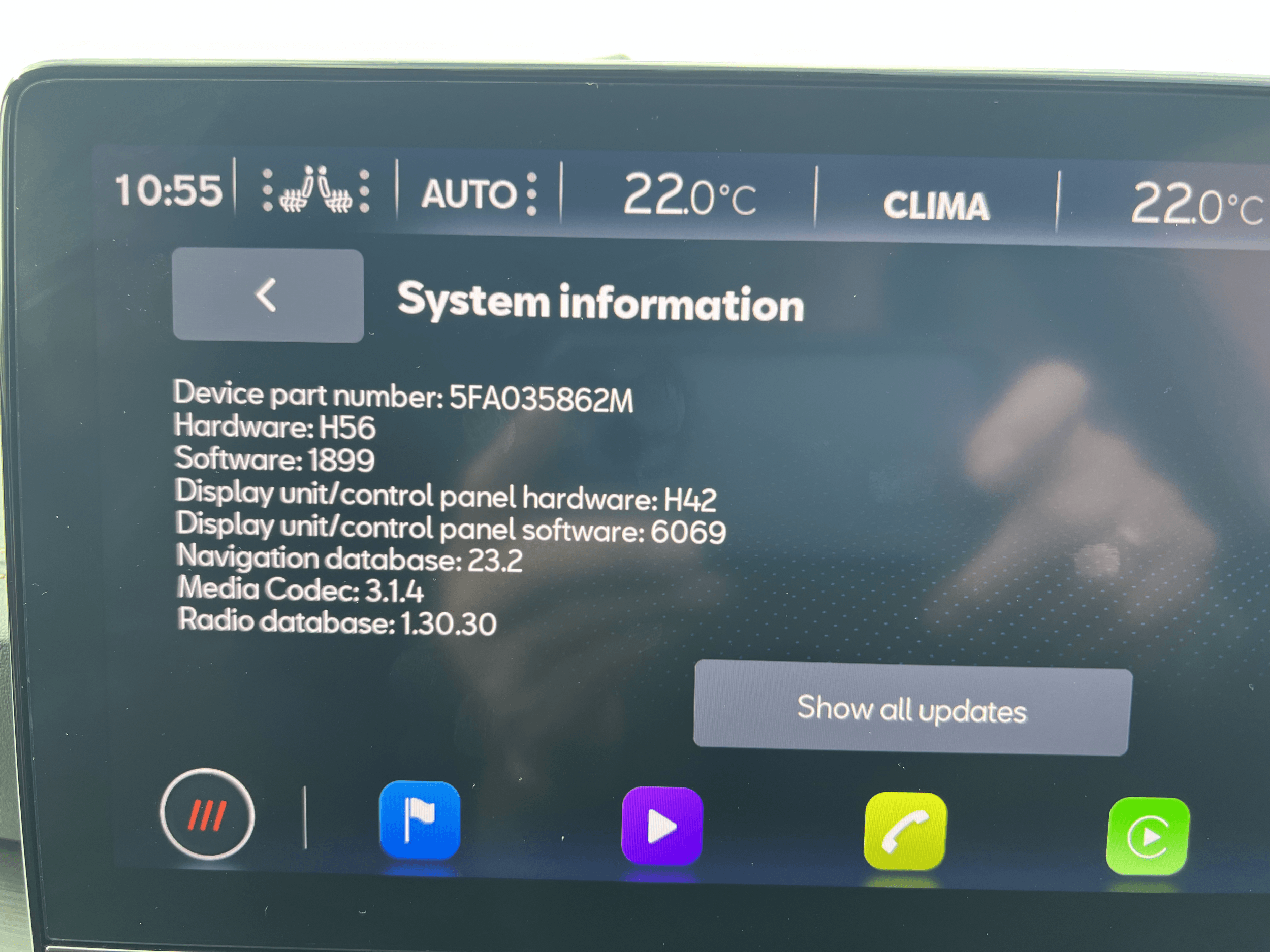

@oldgitdave just had a read through your posts, and the plot thickens! Mine is currently on software 1899, which was updated during a service a few months ago. I'm booked in for the '91EF recall update' on Friday, so I'm unsure what they're going to do if I'm already on 1899. Hmm!

So went for the update on Friday, checked the software version, still 1899! It was remarkably quick, so I wonder if they were too embarrassed to say they'd done nothing.

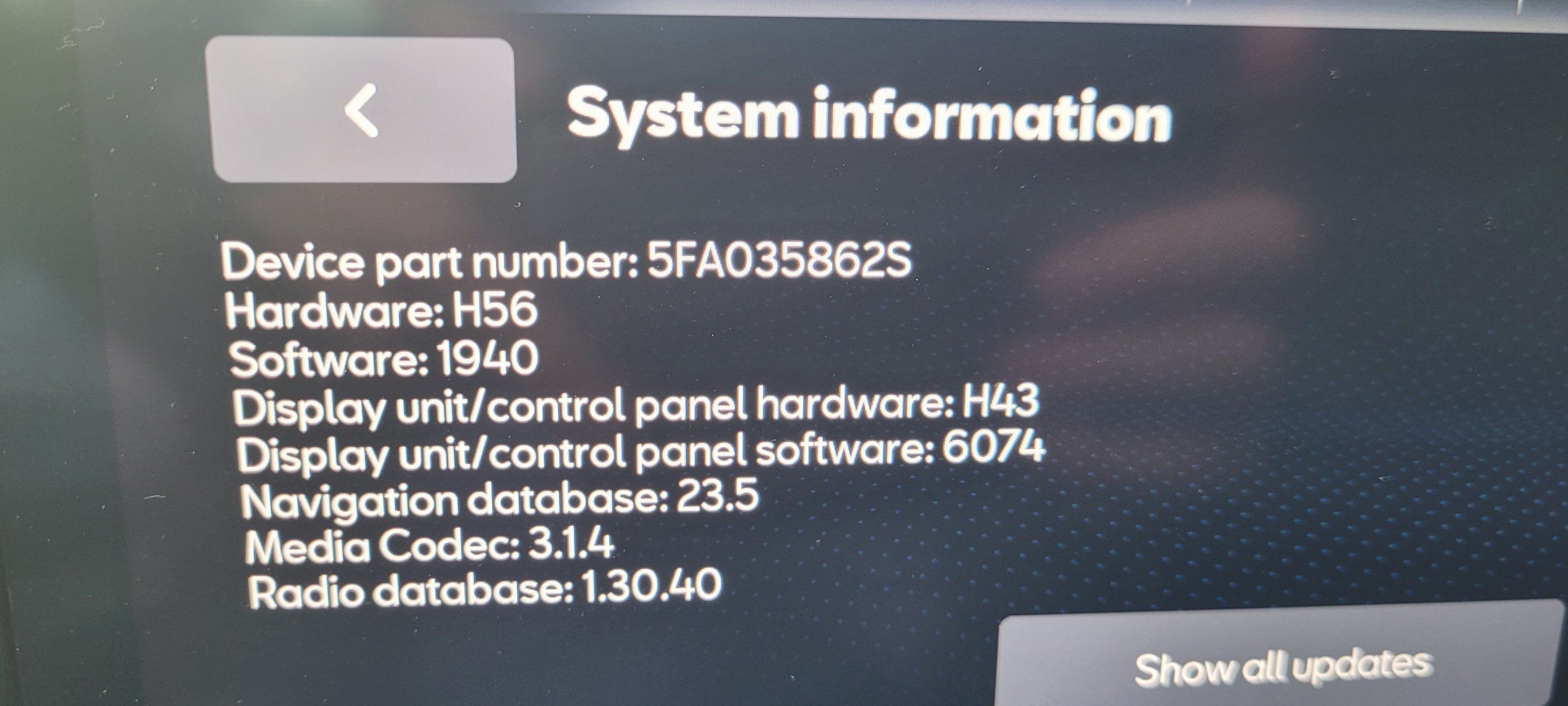

Took my car to the dealer for my annual service; they advised me that they performed a software update. Just checked the system and now I'm running the 1940 version. Have not noticed any changes as yet.

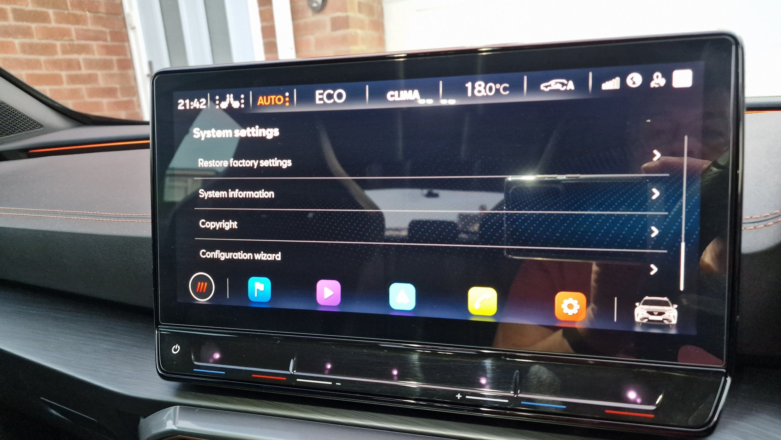

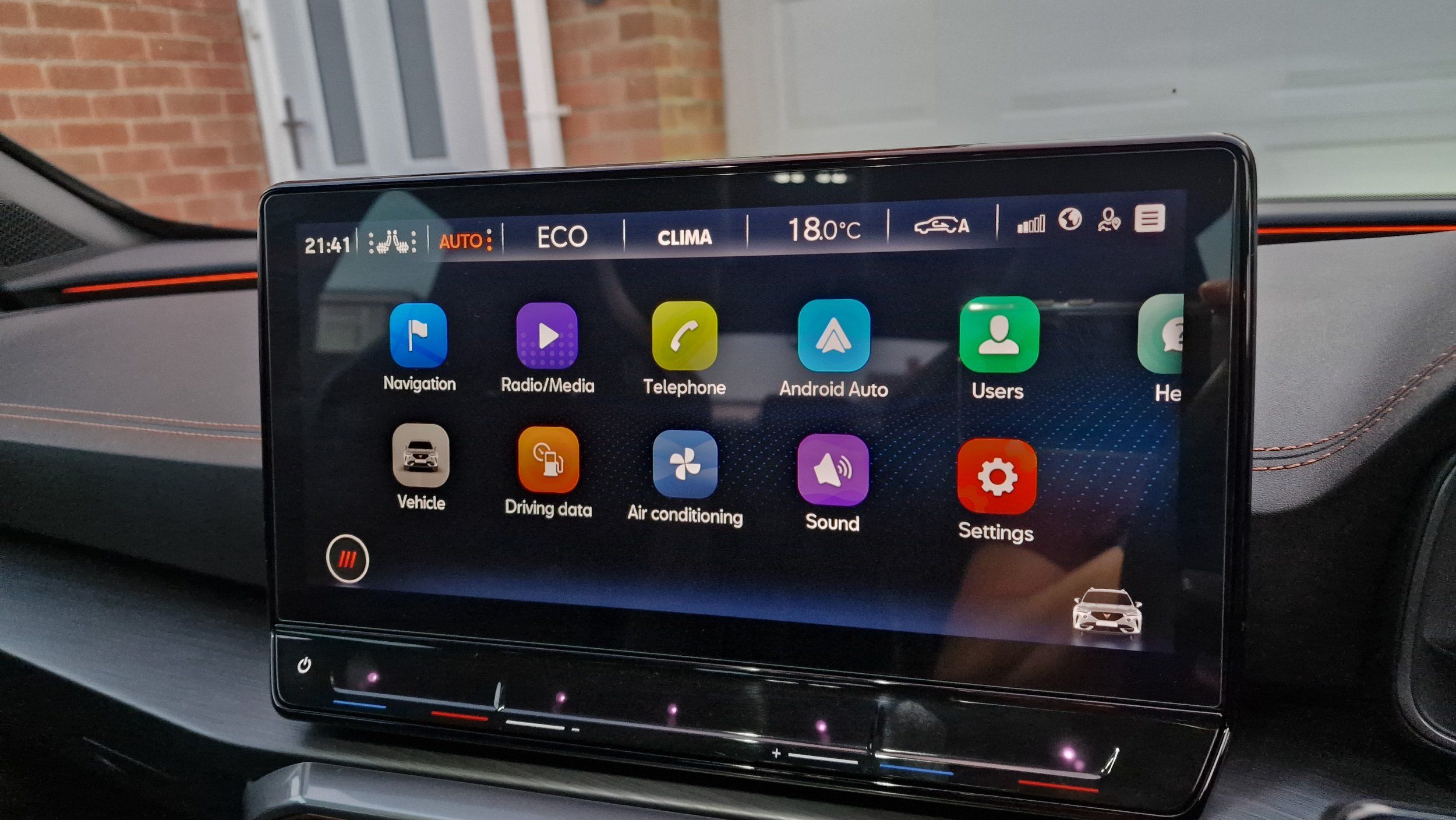

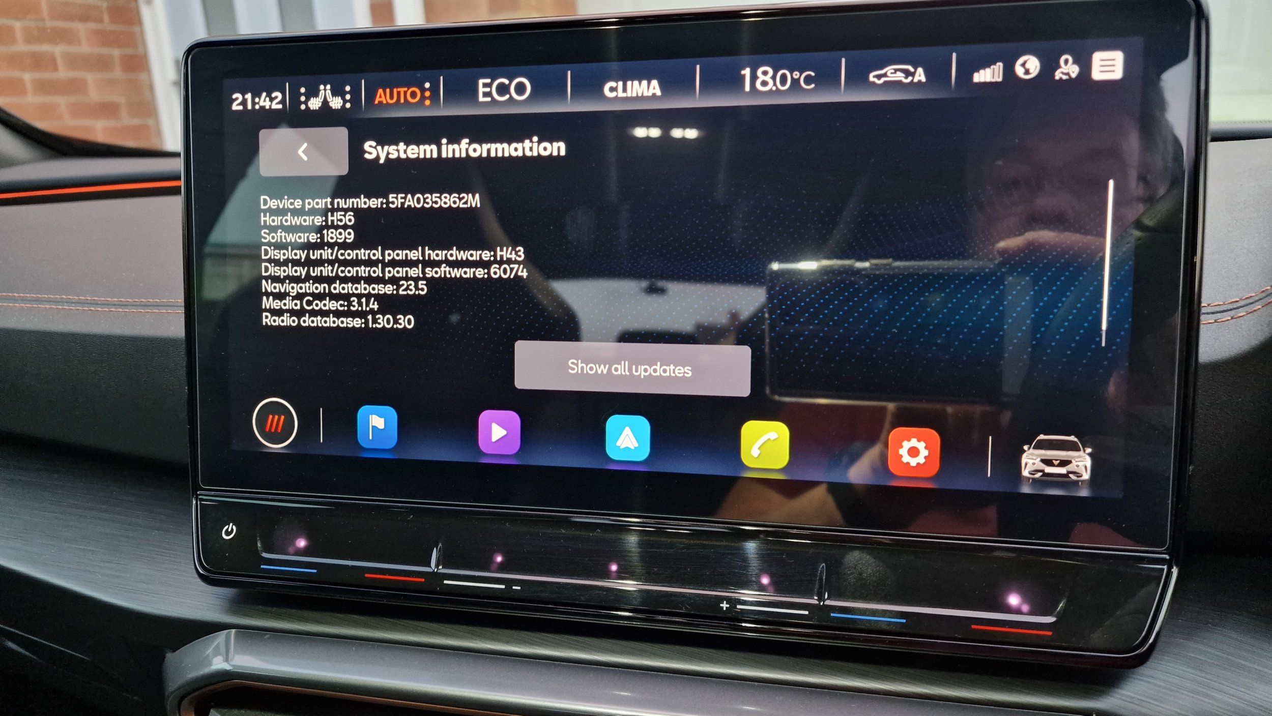

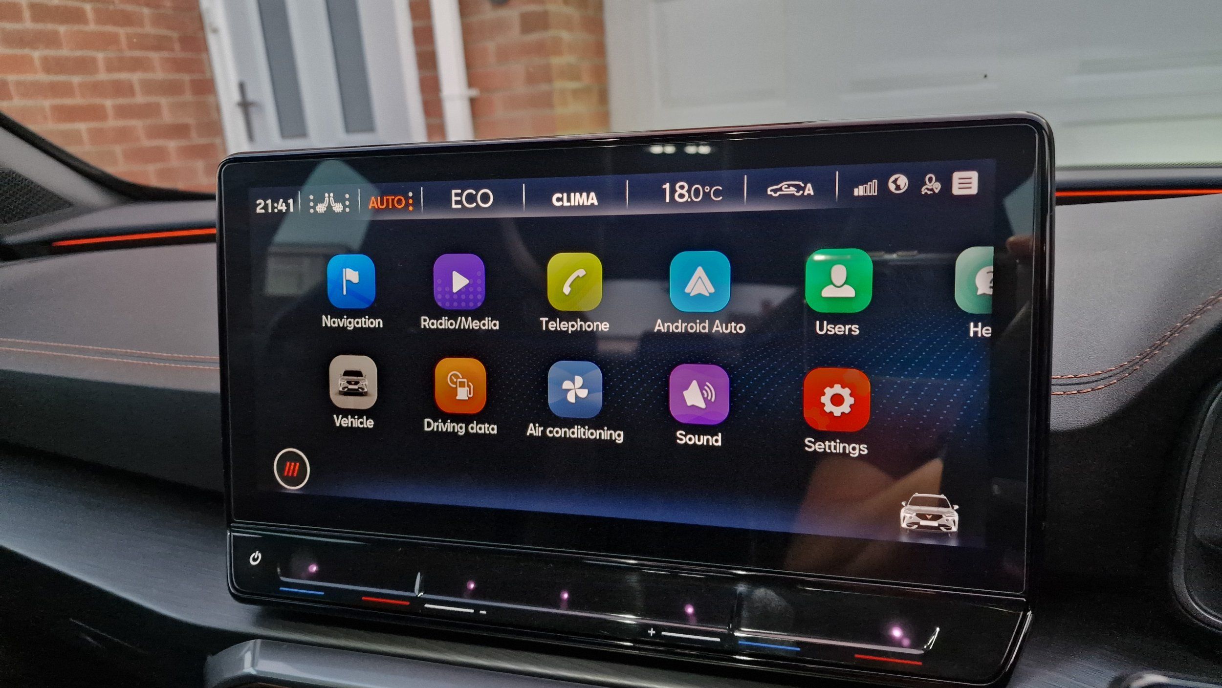

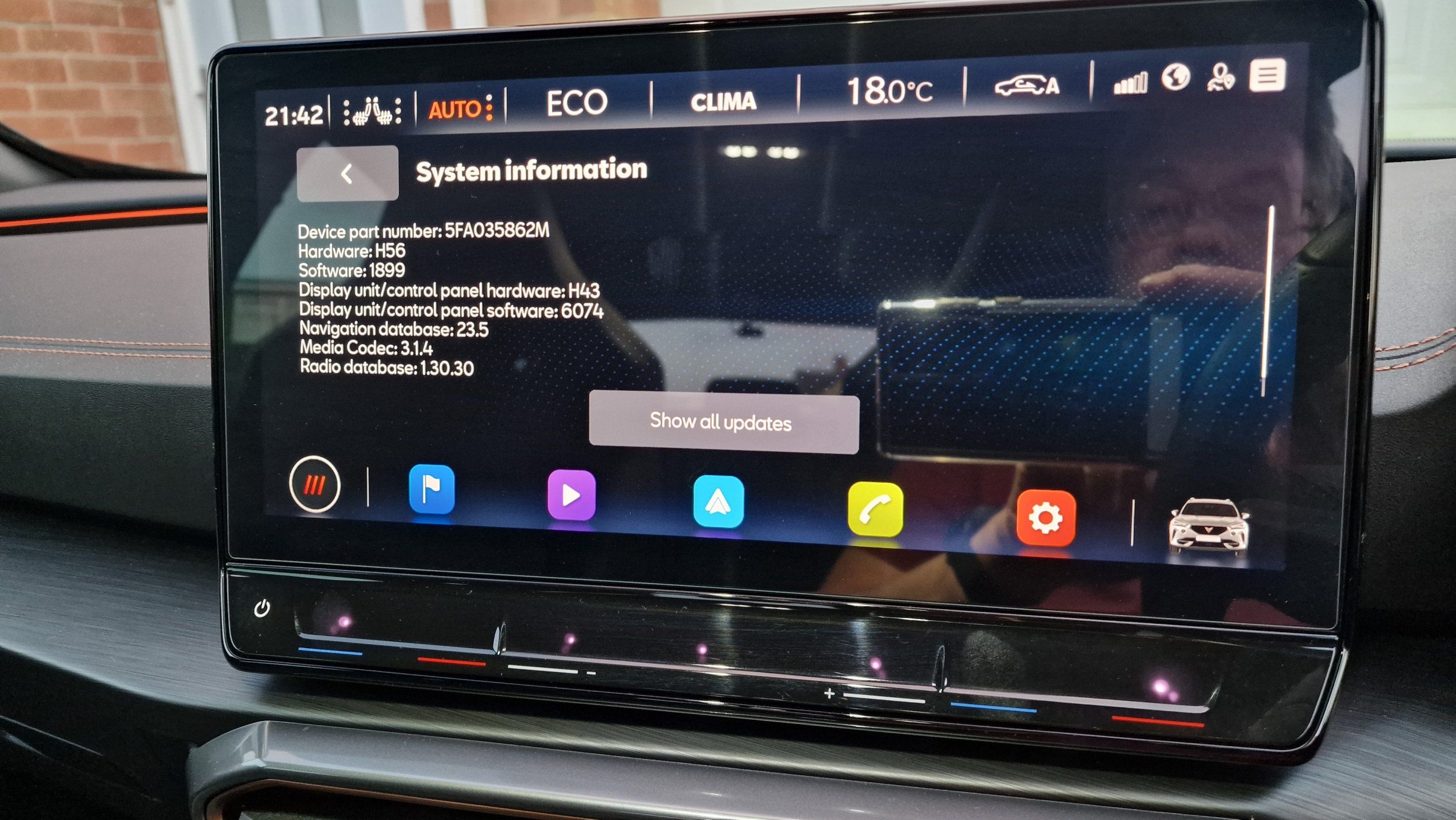

this is how mine looks like. I had a few restarts of the infotainment system while driving that I reported (at 2 instances my infotainment crashed while I was reversing and the screen went blanc - told them that this raises a security concern) and therefore I guess they had to perform the software upgrades.
