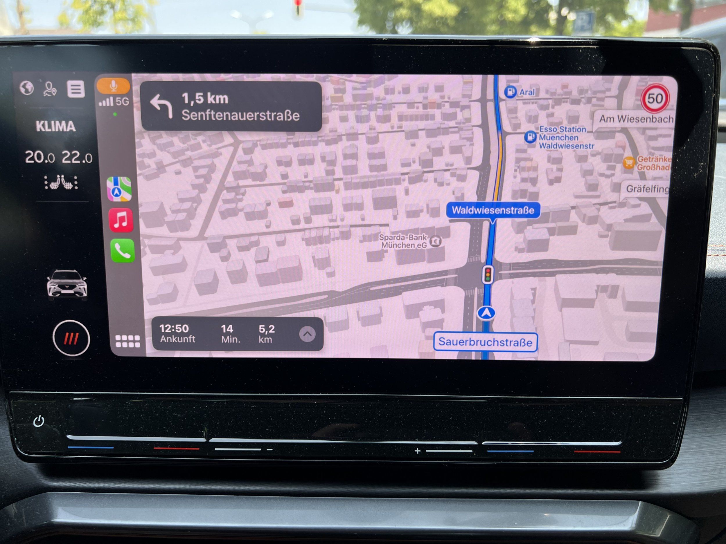

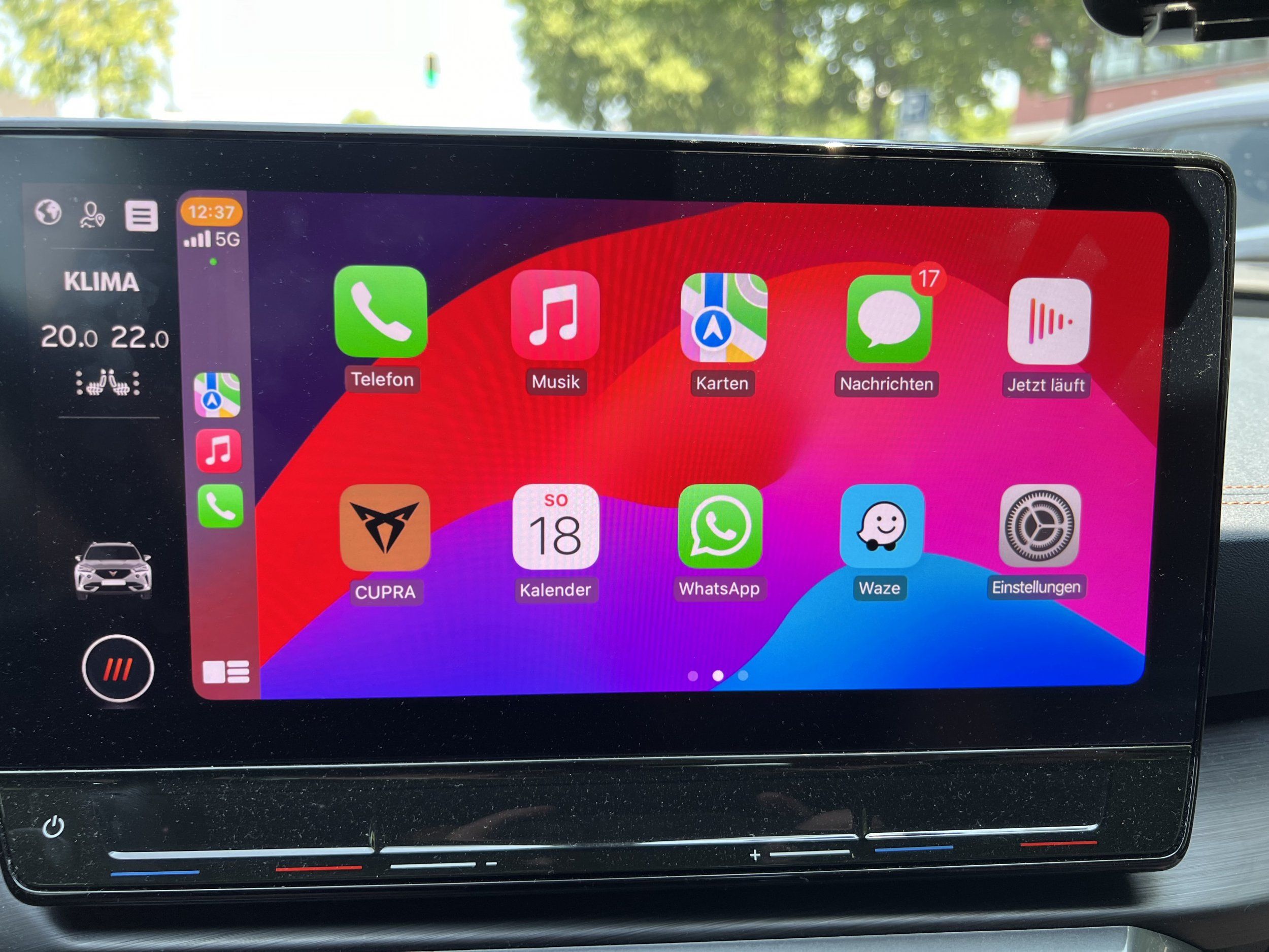

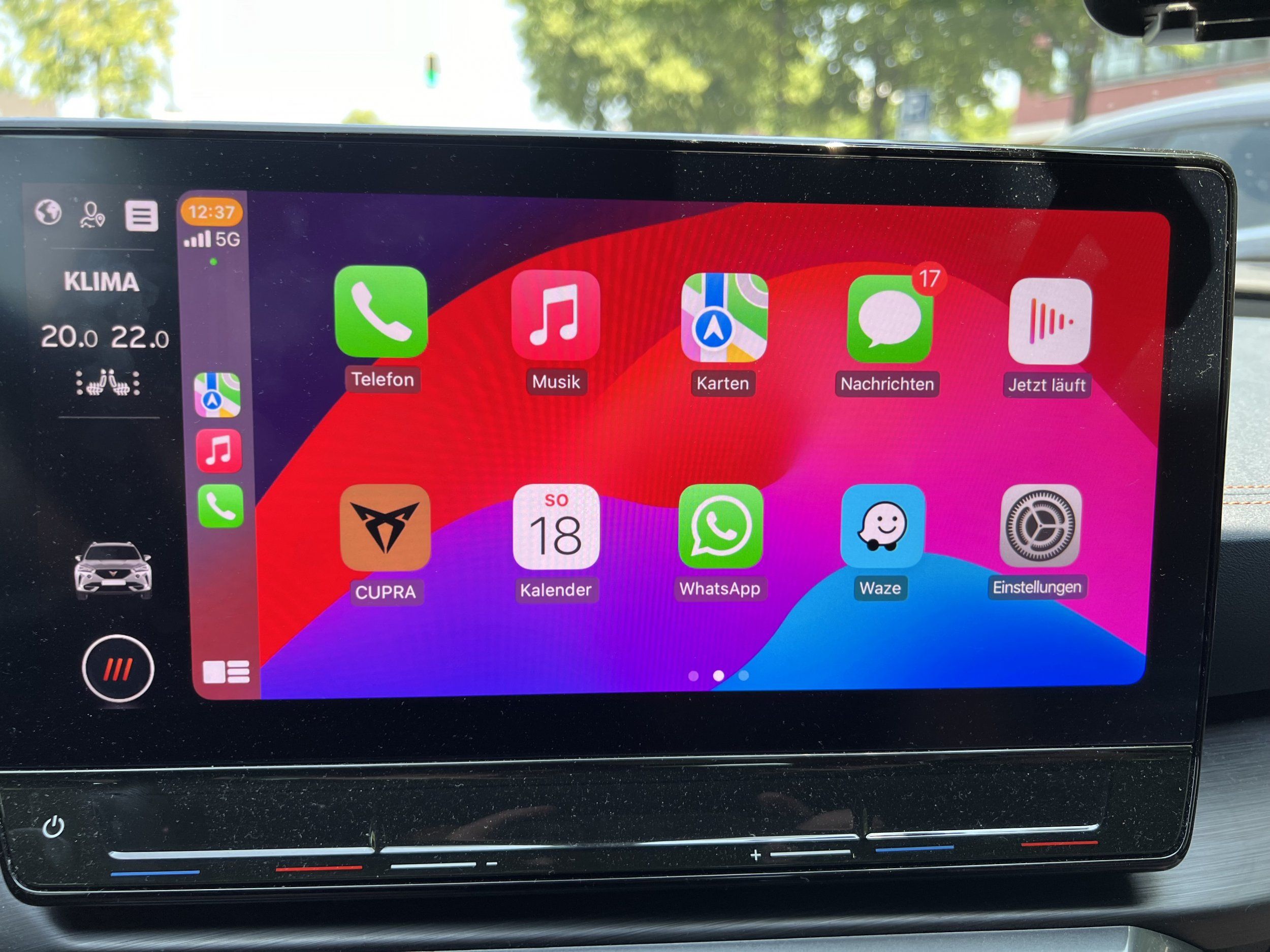

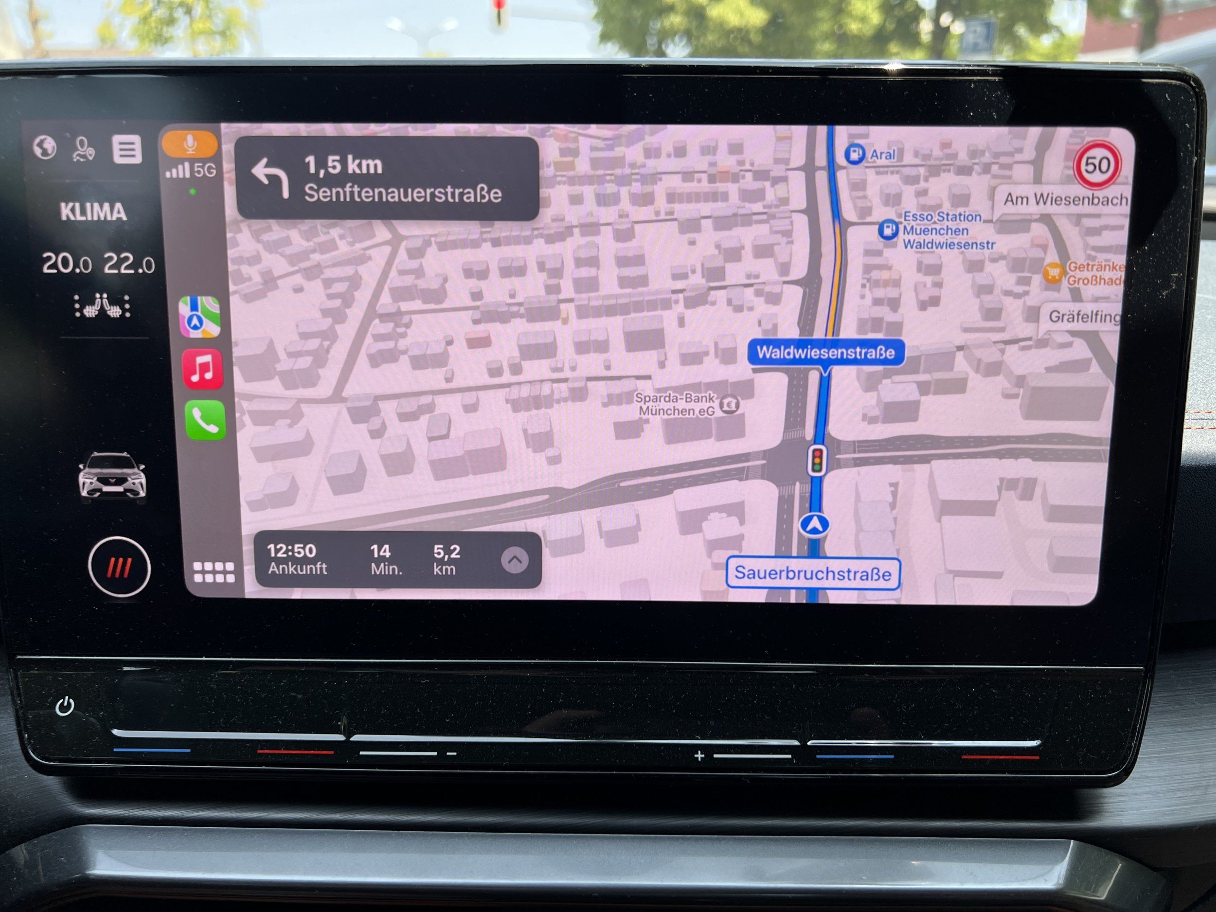

Can you show a picture of Apple Car Play please?
Reactions: tzuicomicina

Picture of CarPlay?
There is an active tpi for the 1940 update so if you have the rebooting issue the dealer will update it. I’ve been on 1940 for about 5 weeks and it’s loads better, CarPlay icons are smaller now but looks better.

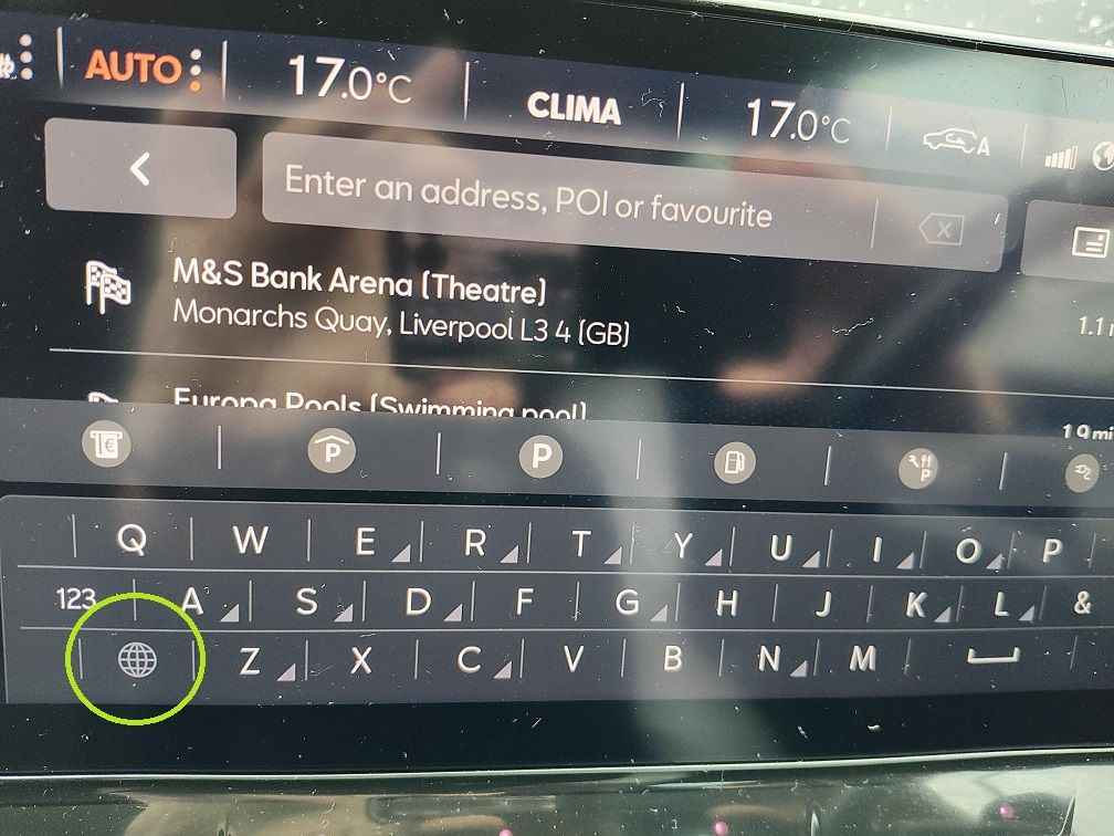

Quick question to everyone - any idea what this greyed out 'planet' symbol is on my sat nav search?....not noticed it greyed out before :unsure: (connect subscription is up to date)
Chris
Reactions: oldgitdave
Hi Chris, this is the change language button if not mistaken. Maybe before the upgrade to 1940 you had added a second language? If yes, you only need to add the second language again and then the planet will no longer be grey.
