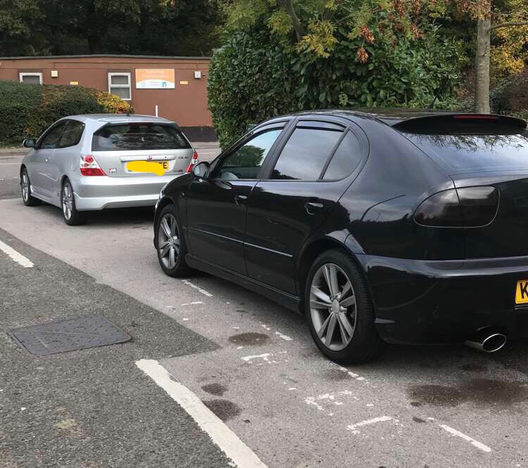

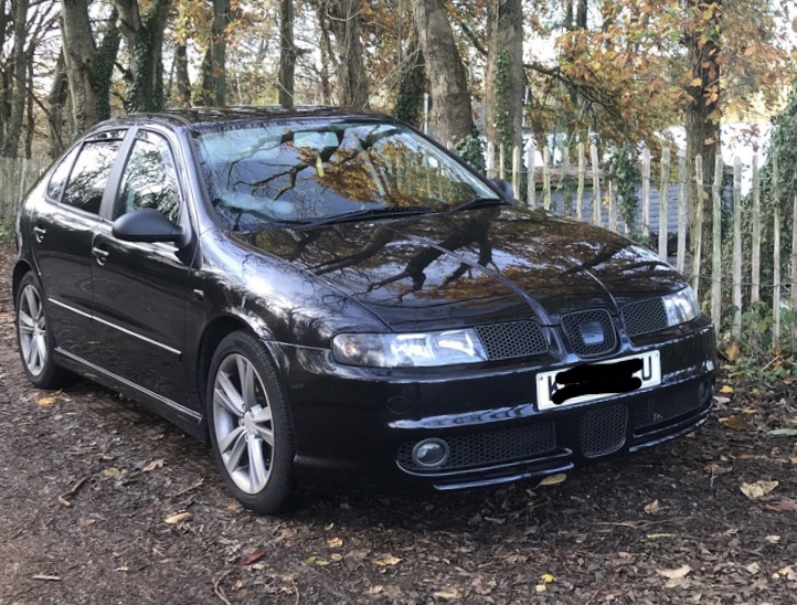

Here she is shortly after me purchasing, this is my second Cupra and was completely standard with 56,000miles on the clock.

The first thing I did was to fit wind deflectors and replaced the old rusty back box with a new Cobra non res cat-back, made a massive difference to the driving experience and looks a 100 times better. Parked up with my mates ep3 both looking clean before going on a spirited drive.

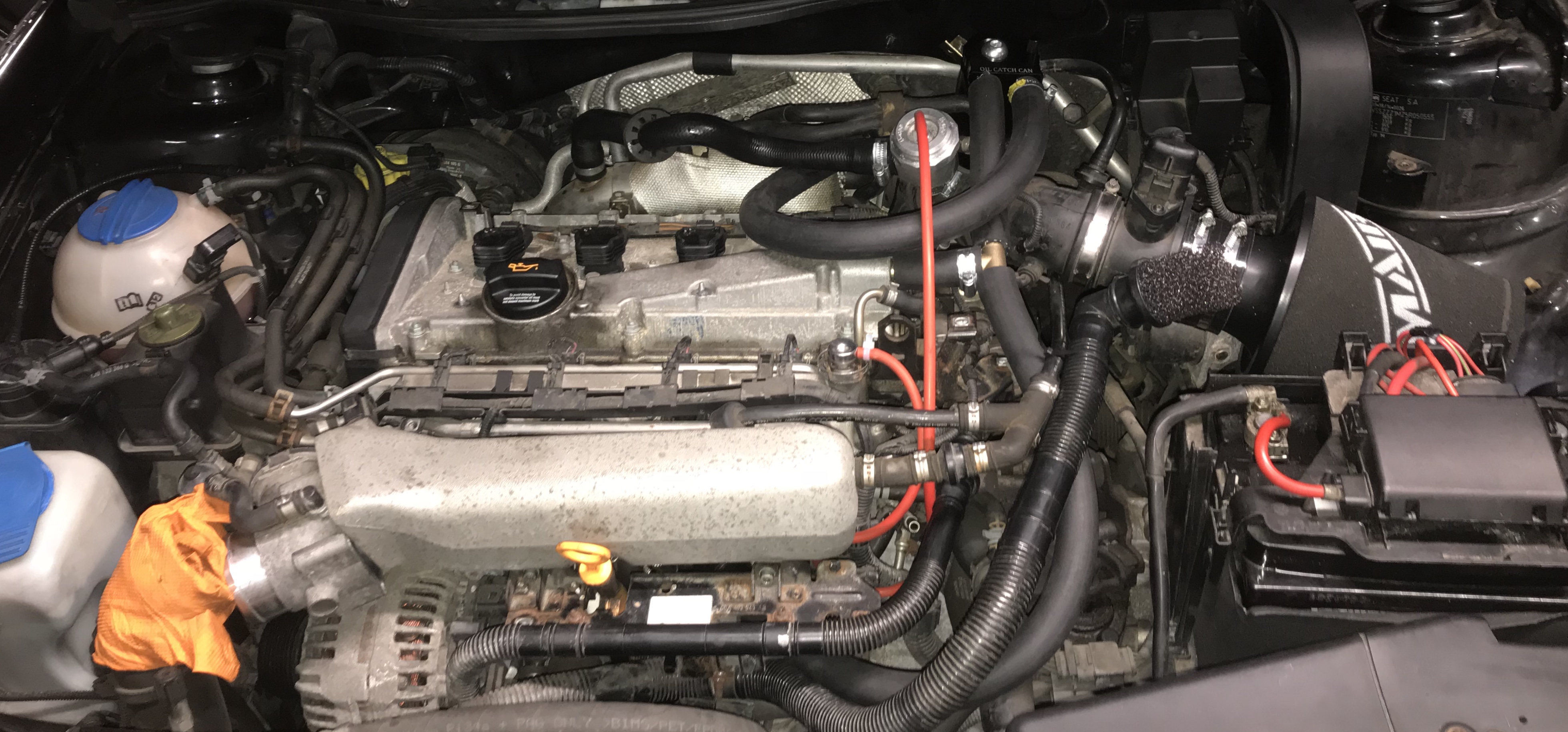

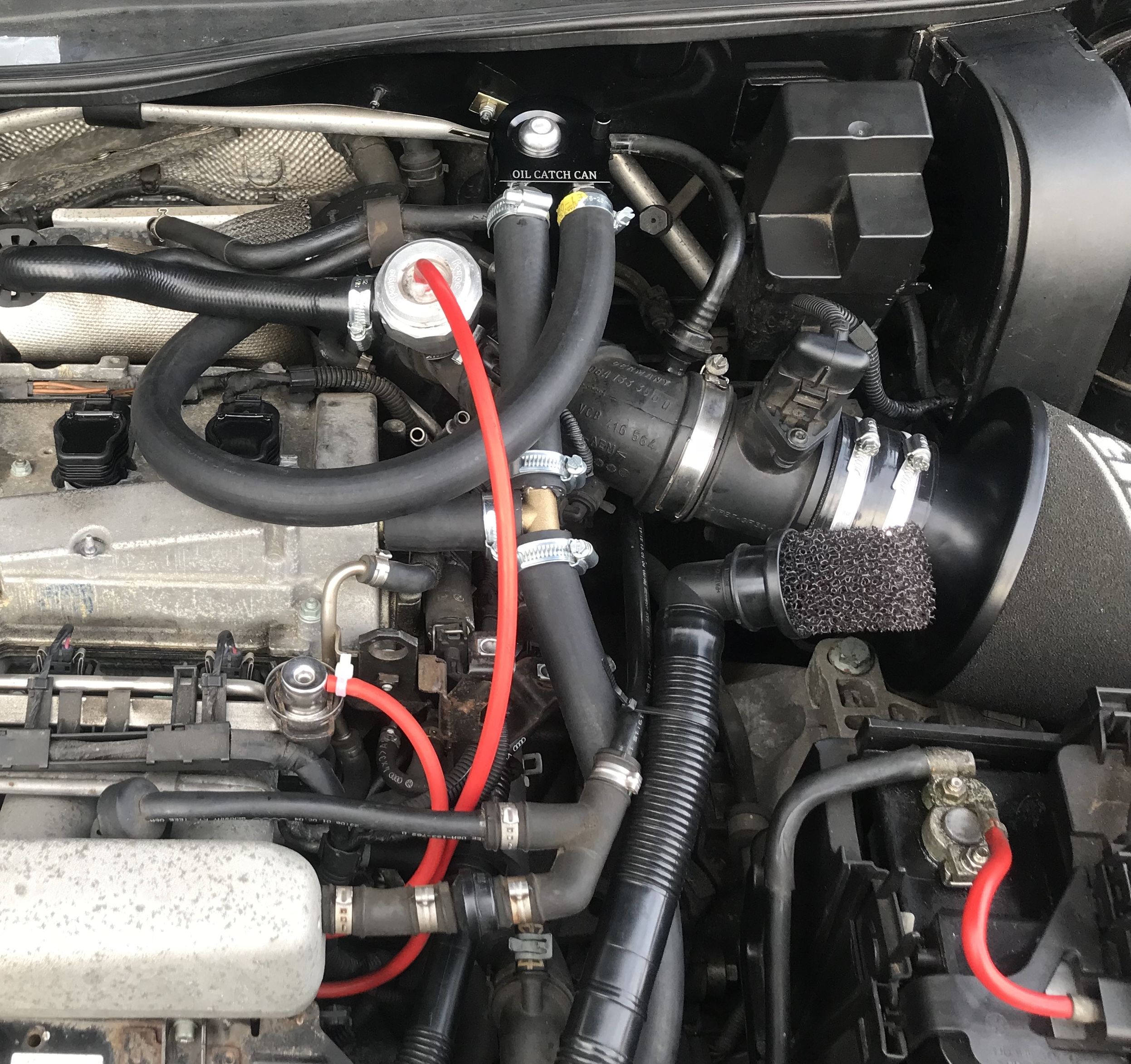

Felt it was time to get stuck in under the bonnet and prepare for stage 1 remap.
Fitted a 007p
Ramair cone filter
4bar FPR
Catch can
Clean the throttle body.
n249 bypass
Notices some differences but mainly in sound and throttle response

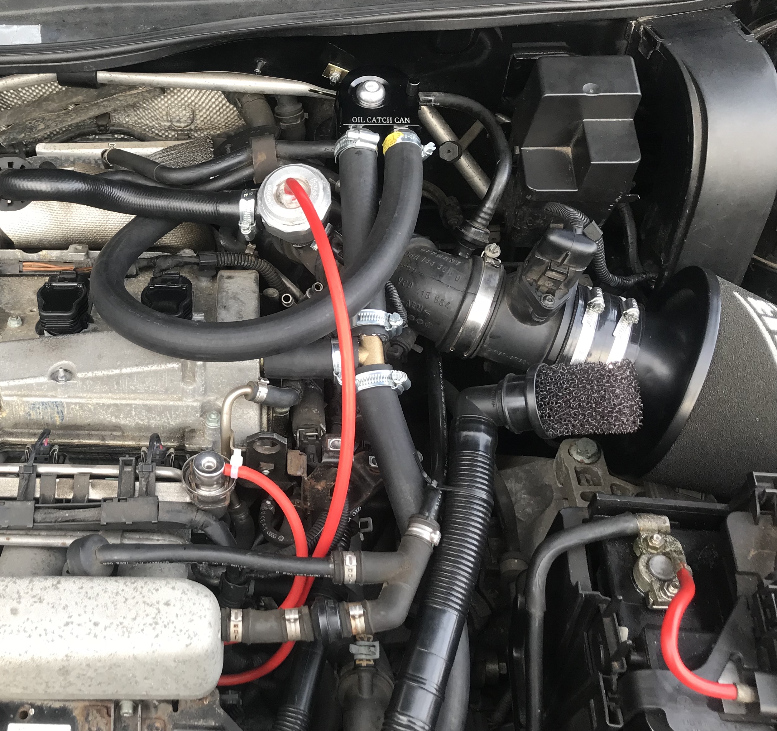

better shot of the catch can, amazed how much turd gets built up after a few weeks
Where the MAF is "the black box above it" are two relays, one for ECU power and one for sai power. Unplugging it will kill the sia from working and you can remove the rest of it with out blanking it off. Valve will not open with relay removed but will bring in the engine light "code out". Forget which one it is but there are only two...think it has 100 on it. I did this and ran it for ages without issue and without the stupid noise on cold start.
Sent from my Nexus 6 using Tapatalk
Very interesting of you to mention this as I have had an engine warning light on for a while now that keeps coming back once deleted after a couple days. The code is 16795 "secondary air injection system, incorrect flow detected." This all started after fitting the induction kit and n249 delete. Have seen many owners remove the whole system. Will have to do more looking into but may try what you have suggested as on cold start it's all you can hear!

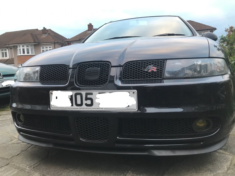

Front splitter fitted which really compliments the front end. Also wrapped the fogs with yellow vinyl, looks less plain but still understated.

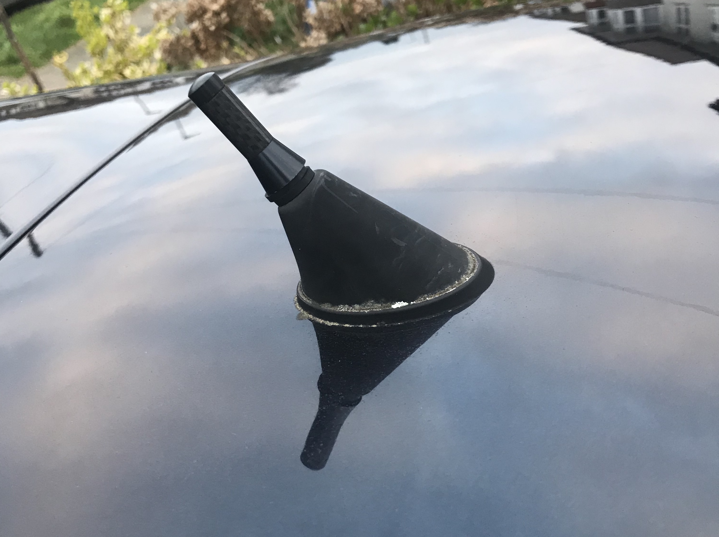

Hated the long ugly looking Ariel so swapped out for a stubby one with carbon on it, for £2.49 why not. Anyone know of any hacks to make the rubber part look less old and perished?
This code will be replace with a different one, I forget what one but it means the sia has no power supply. Valve will remain shut. Fault code will need coding out to remove the light.
