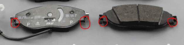

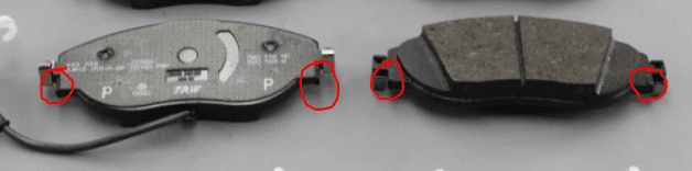

Nope, had new brake pads fitted, they have been checked, the knock was present before and after the pads were changed, also the noise is present even under braking. Cheers for the replys everyone.
Can you double check your brake pads - I see this quite a lot with this TRW designed caliper.
What pads are you using?
This brake system relies on the anti-noise shim wrapping around the back plate (red circle) - which laterally constrains the pad, so the thickness of the shim becomes a critical dimension.
I see many pads using a shim which is too thin, or where the back plate is on the low end of the tolerance - which means the pads loose & can clunk - even the VW OES pads as in the video below.
This clunk noise will travel up through the damper and top mount so may sound like its coming from the suspension.

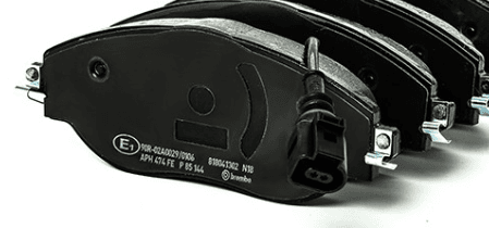

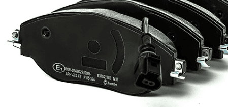

Interesting that you have said this. Got to more investigation but im beginning to think that the noise doesn't happen when on the brakes, pads i had are brembo.
The Brembo P 85 144 use a cheap thin shim!
I don't think the P 85 144X does any better.
I would be checking these, take the caliper off - and see if the pad clunks up and down.
P 85 144
Reactions: rob280
P 85 144
Just done a 10min drive on the same road over and over, it rattles when off the brakes but quiet when braking slightly.
Pretty conclusive i would say so phoned the garage and they are getting a set of pagid pads and will swop them today so watch this space!!!!!!

Fu** me sideways, swapped pads to pagid and it is sorted, the movement in the caliper with Brembo pads was nearly 4mm, no movement with pagid.
Thank you for everyones help but a special shout out to Super v8 and Deano.
