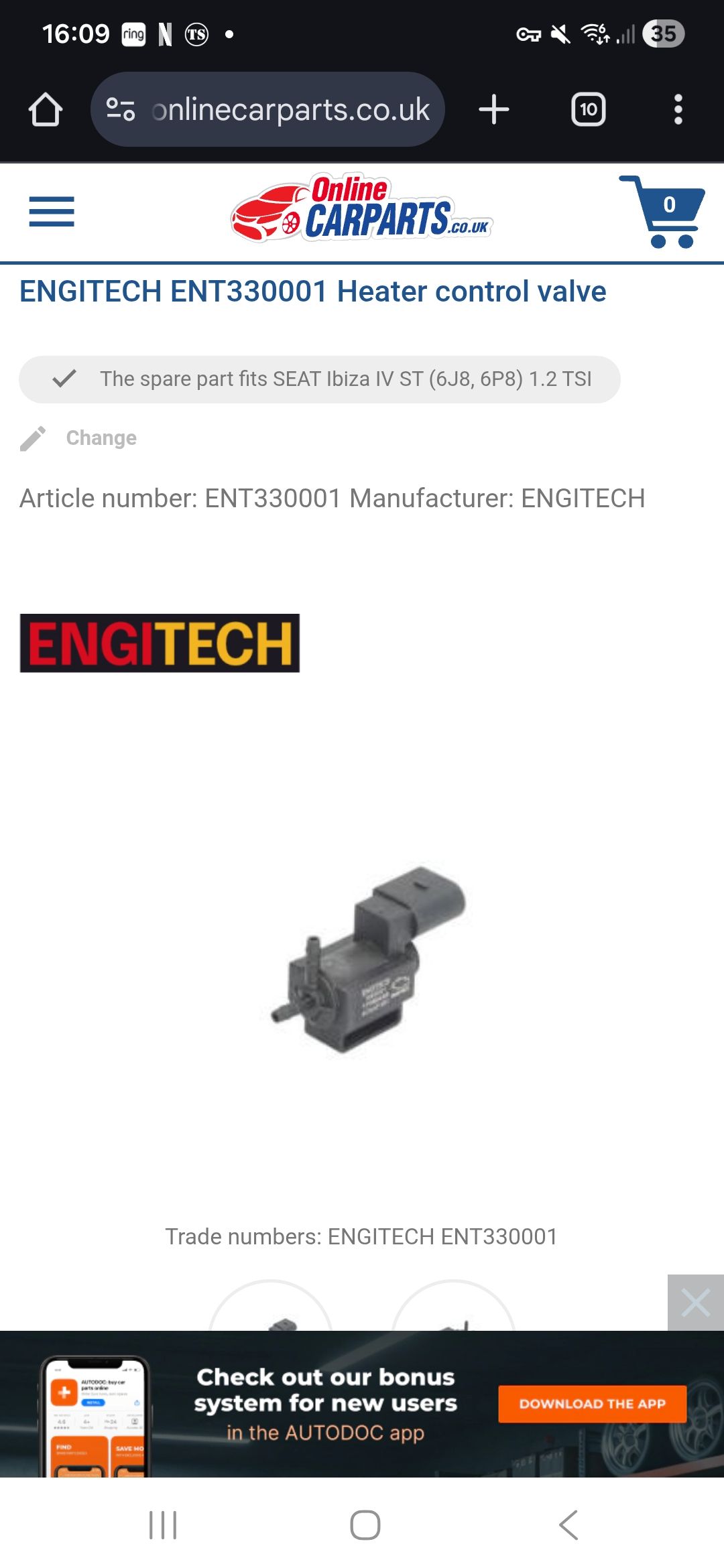

Help, I have a ibiza 1.2 fr 2013 with no heating . Ive been trying to fine the heater control valve ( like one in picture) but can't find it have looked in bulk head uder vent. It losts this type of value for my reg. Cheers in advance.
I didn’t think that these cars had one, they just use flaps to blend HOT and COLD air to achieve the set temperature.

Did you have any joy with the heating issue, in the passed I had a similar issue and it was the relay mounted on the front of the battery, behind the headlight was disconnected, reconnected and got a lot hotter, something to do with the split cooling system.
