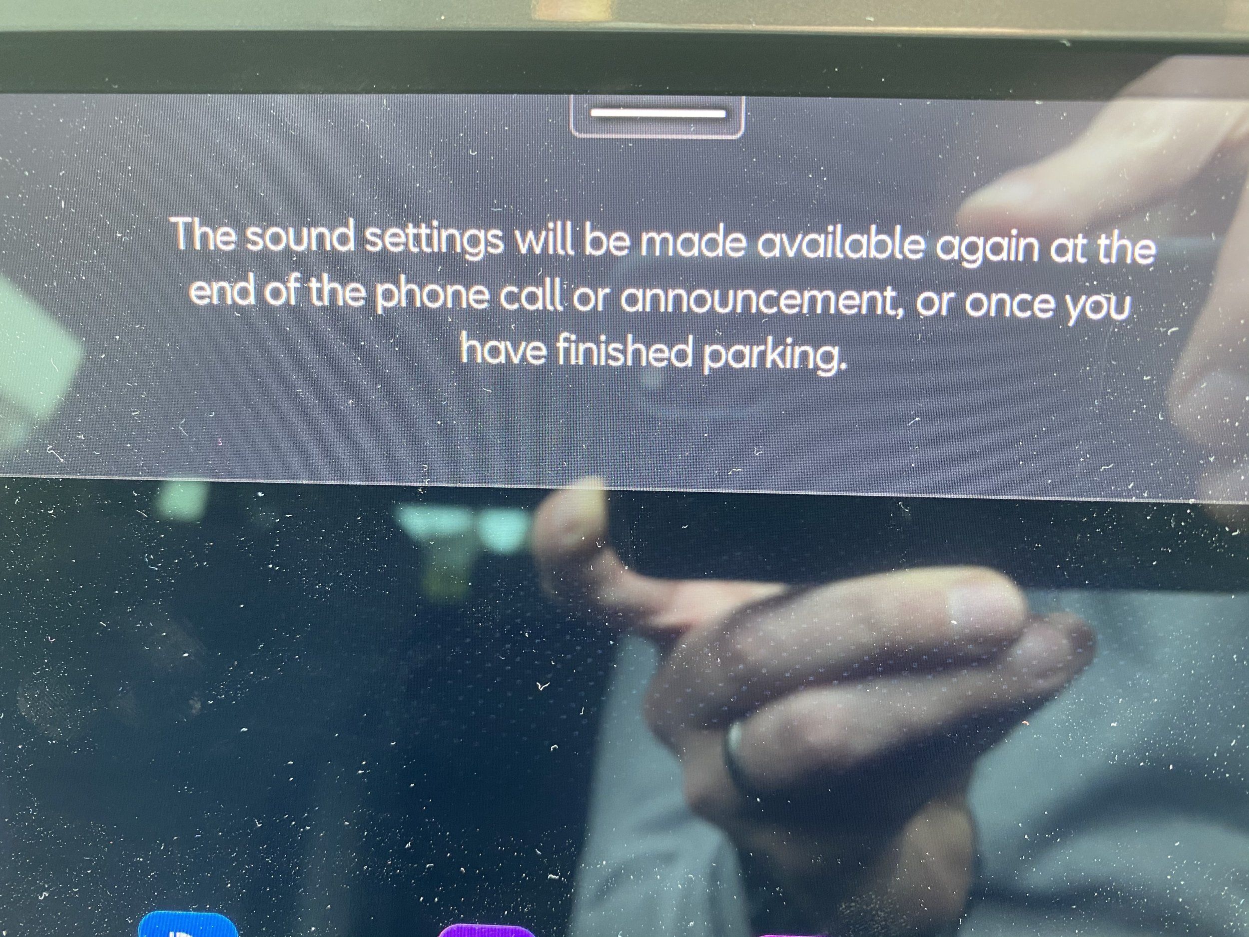

Hi @yanivkoval yes I have tried that. Additional info, when I am on the radio option, have selected settings -> sound and I am greeted with this:
“the sound settings will be made available again at the end of the phone call or announcement, or once you have finished parking.”
There is currently no phone connected.
This is very very strange, and may indicate that there is something wrong.
Maybe, Reset factory settings ?
If not, I guess it is a visit to the dealer
There is also audio when I select reverse and parking senses work as expected.
