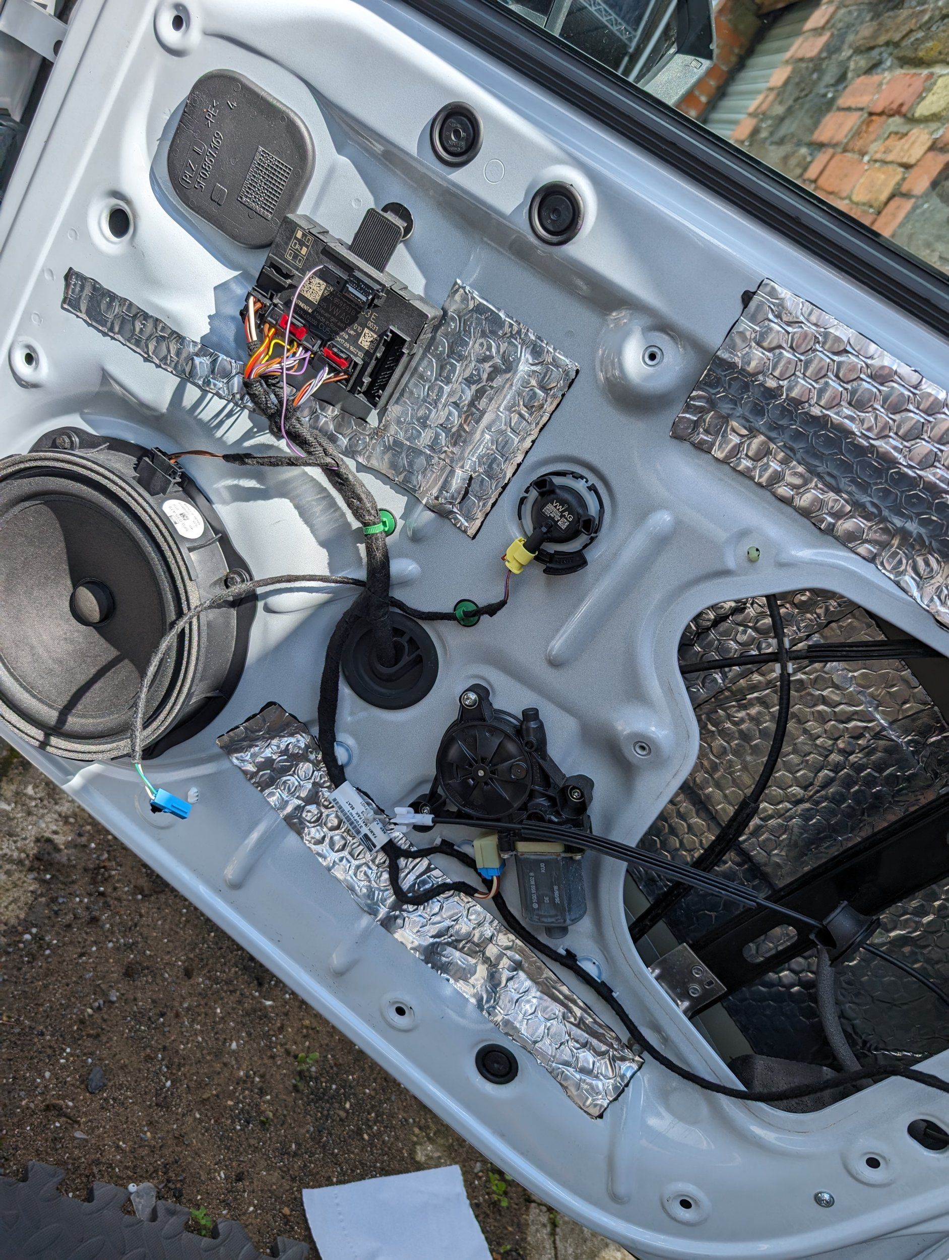

A mid work pic of me adding sound deadening back in June, I did add more to ensure good coverage and rolled the hell out of it, the difference is night and day even with the OEM speakers... I do have a video too but zero motivation to find somewhere to upload it and link it here LOL
If Seat warrant my engine replacement and I get the car back then I will carry on and finish this as in all honesty, I only did this door as I run out of time and haven't got around to doping the rest or ordering more sheets ha!

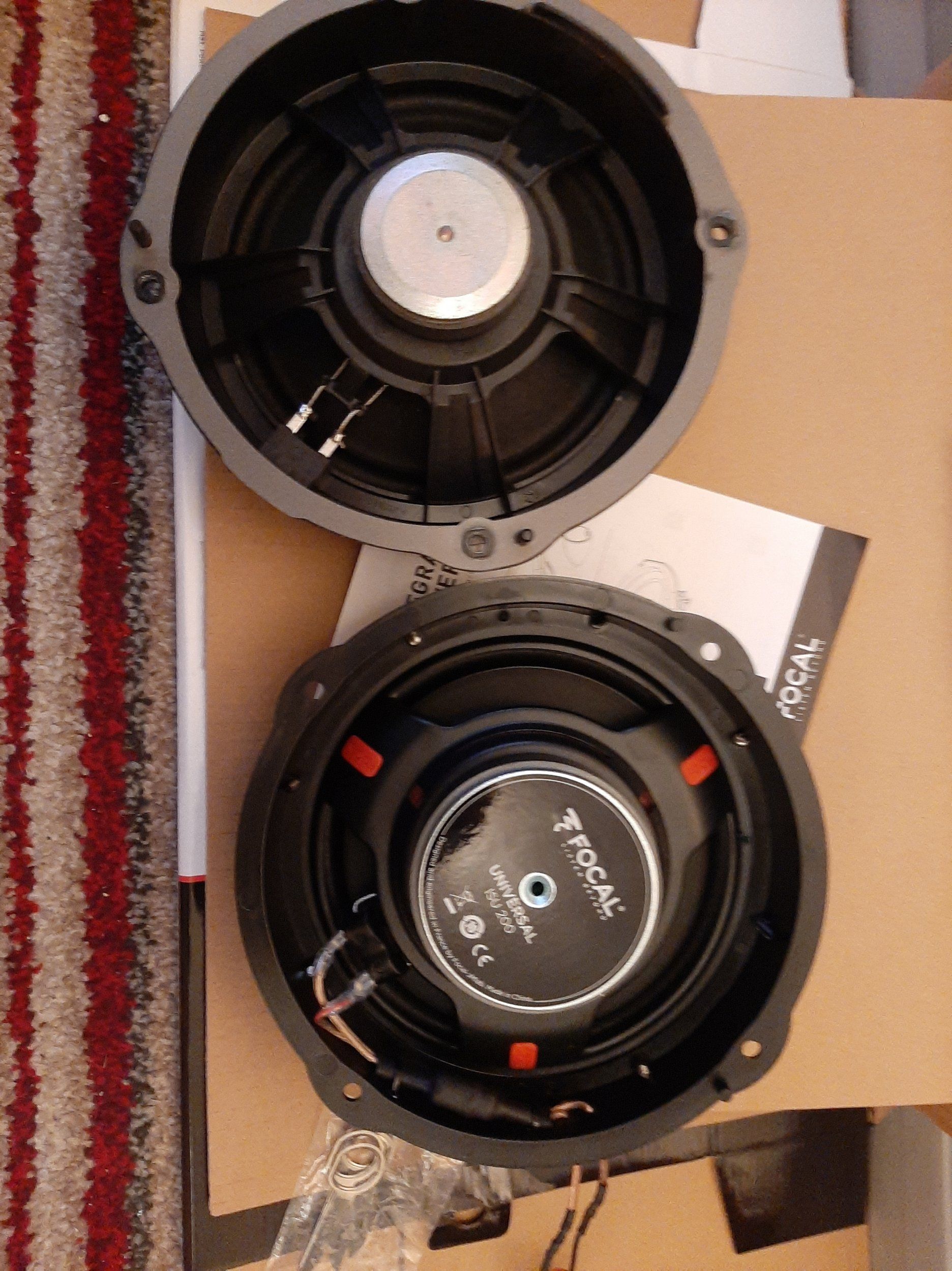

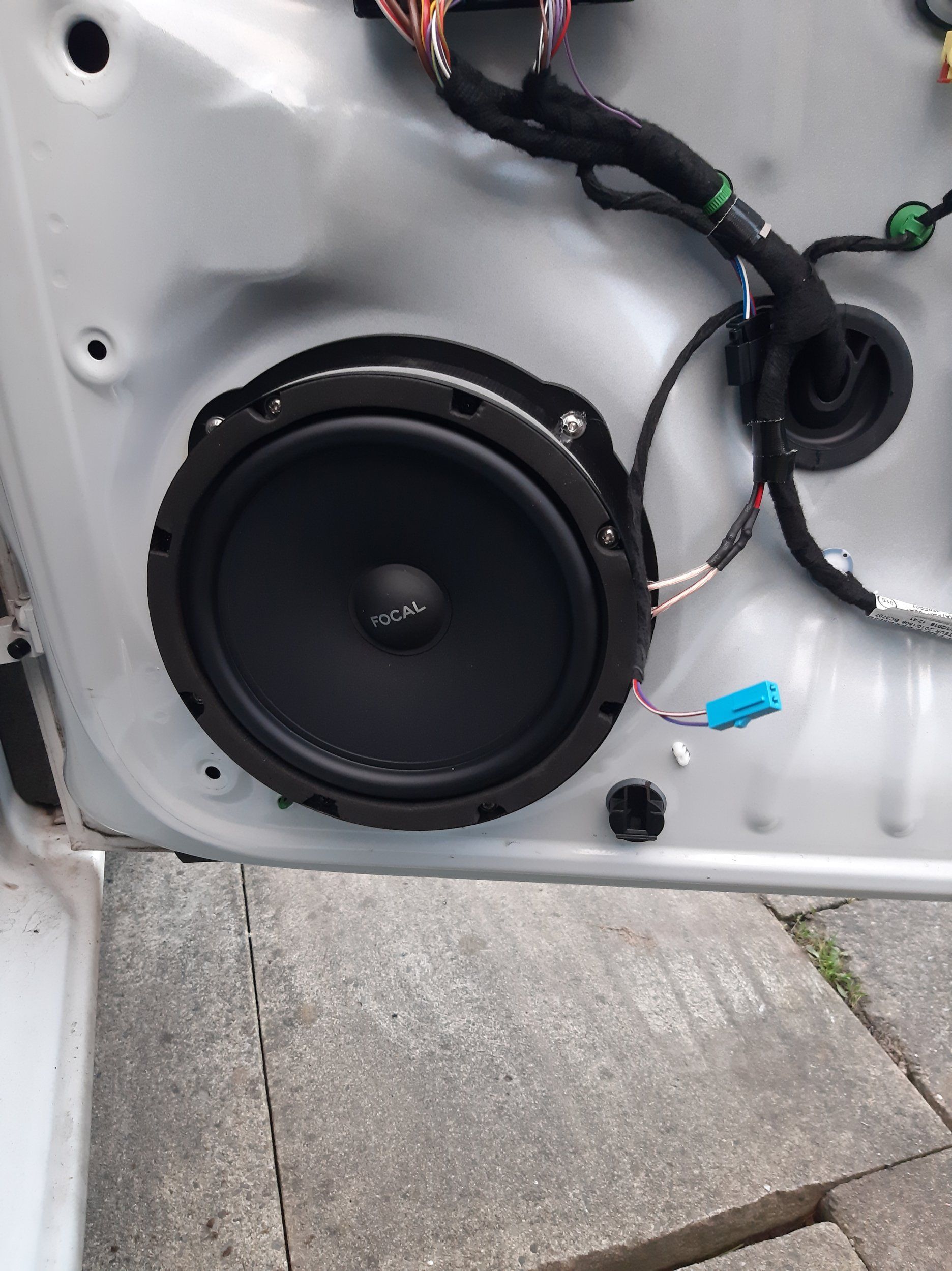

I went with Focal ISU200 in the front doors.
The std front door speakers do not have a splash guard built in.View attachment 46143
@Matt_anderson you can see the rain guard on the original speaker just poking out at the top of the photo.
@DEAN0 , I don‘t know how long you’ve had them fitted, but if you ever have the door card off, I’d suggest just whipping the speaker out to check for water pooling - I only say this as the lip on the Octavia’s door was smaller than the Focal’s aperture and water was still pooling in the speaker!
I cured it by cutting a ‘V’ in the bottom of the door speaker aperture to allow any water to drain, and painting the bare edges with Hammerite to stop it rusting.
Reactions: nd-photo.nl
@Cubbington
That is the bottom of the speaker at the top of my picture.
The two locator pins and the connector are the top of the speaker.
Crikey, my bad, that’s a drain-away then!
Just found a pic on a Google search and the Octavia speakers have a big splashguard covering the top half of the speaker as I recall and the drain-away at the bottom, as per your pic.
The Octavia’s doors must be more prone to allowing water in than the Leon’s…that being said, it’s still worth a look if you ever have the doors apart.
