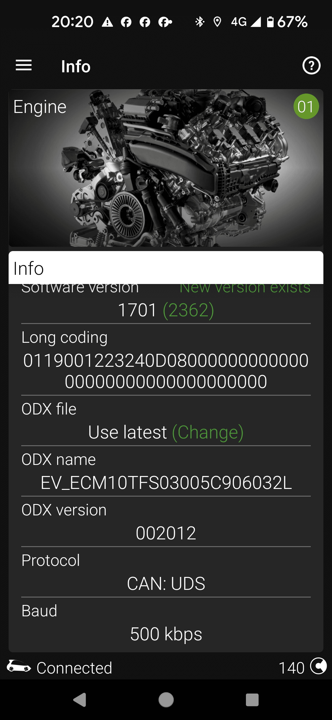

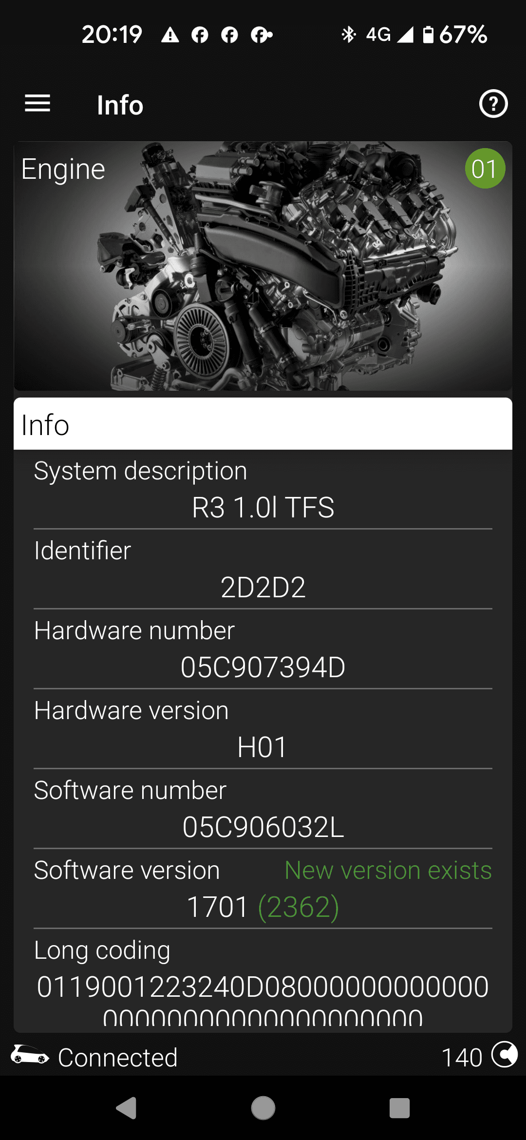

I get this information about the engine from ODBELEVEN:

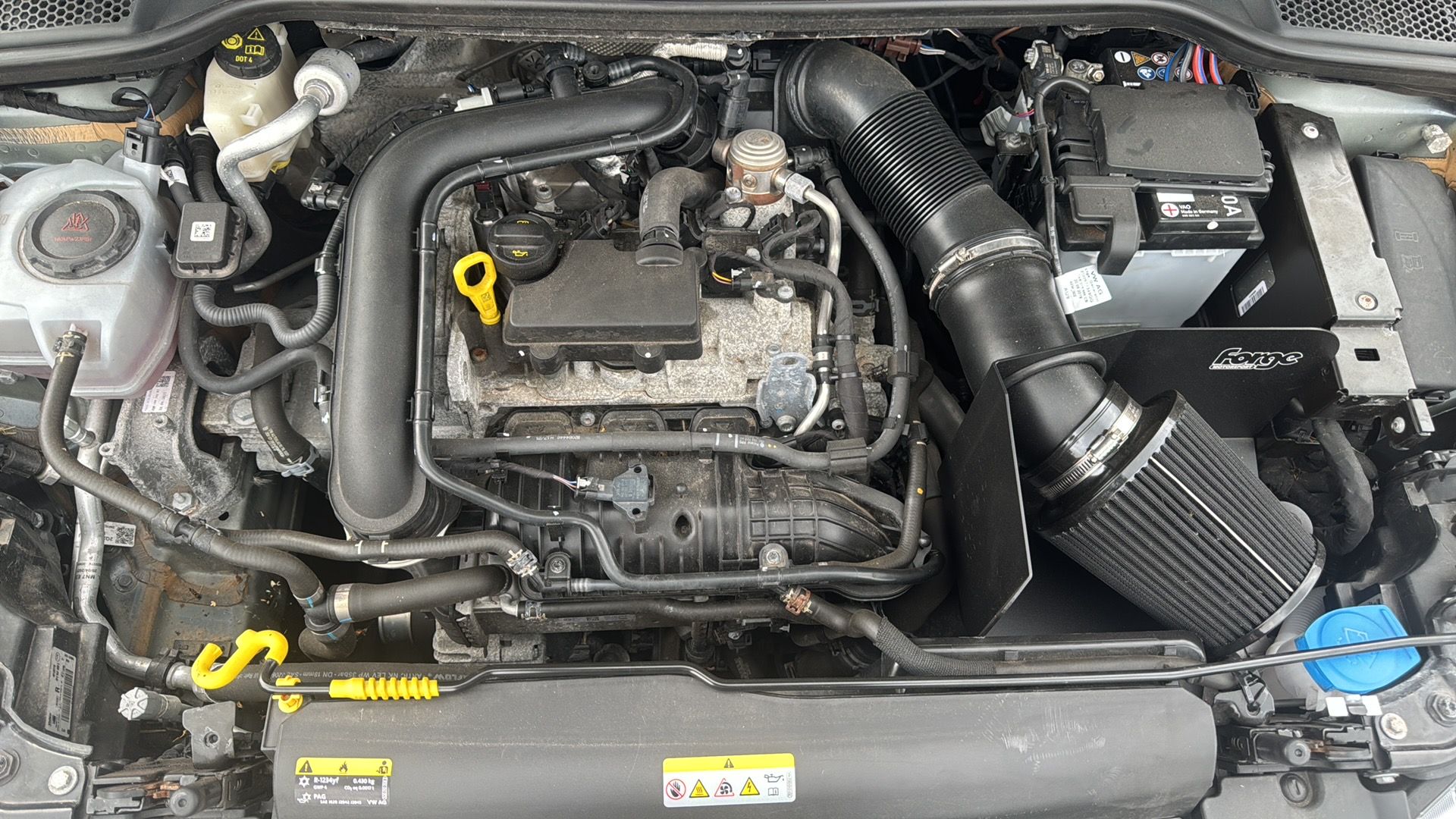

The engine looks like this:
Does that help? If there's any more information that I can get from ODBELEVEN that might help, let me know! Thanks!

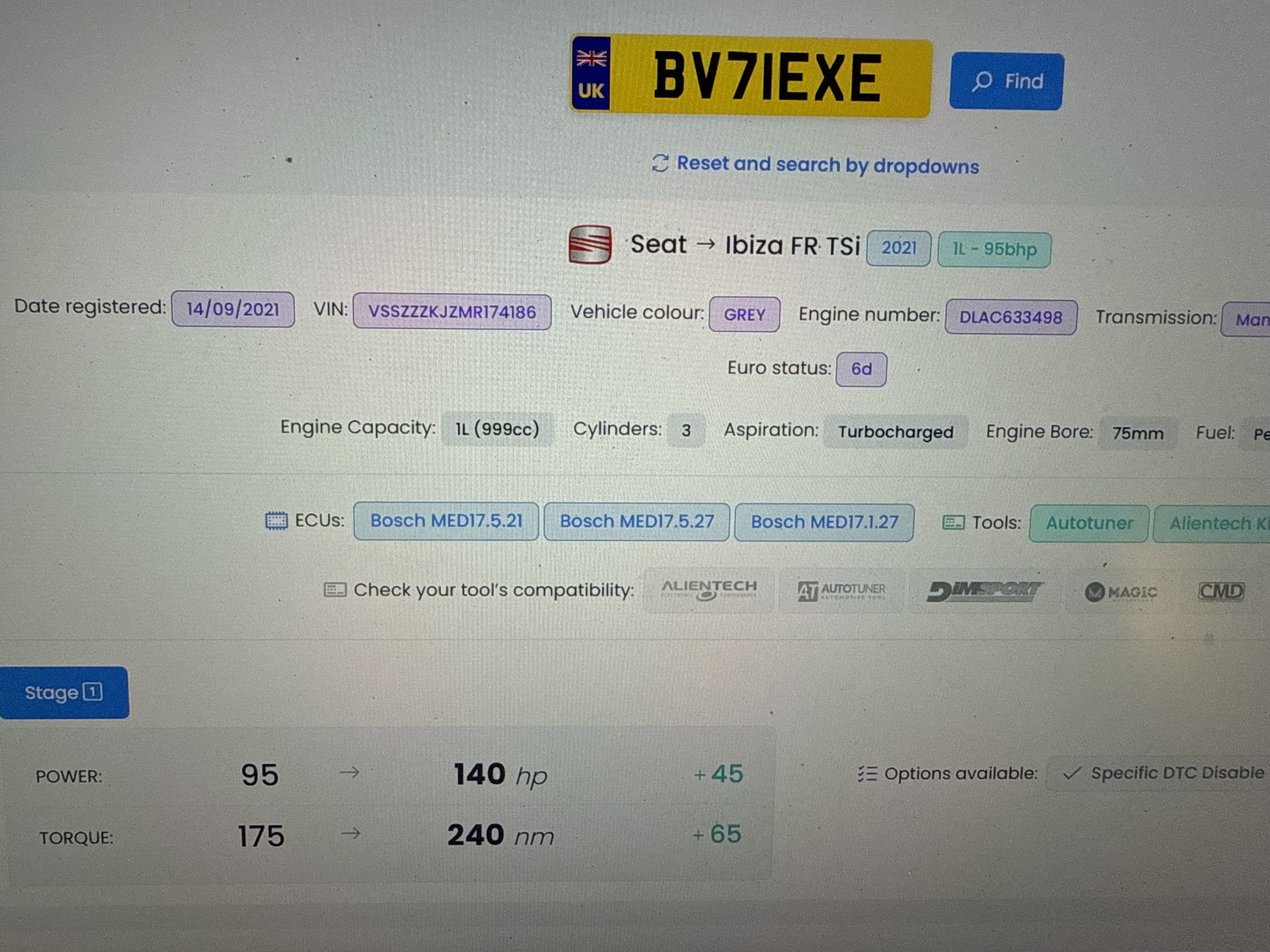

I am really confused as this is a photo from a tuner showing my car having a bosch ecu when it’s a 2021 plate
The ECU is usually easy enough to access, unless it has the anti tuning cage on it. If it doesn't, you should be able to pop it out of the bracket and have a look at what the manufacturer is.
This is my engine bay too the far right it’s underneath whatever them metal screw type things are and I don’t think it just pops off
Ah, that'll be the anti tuning cage.
