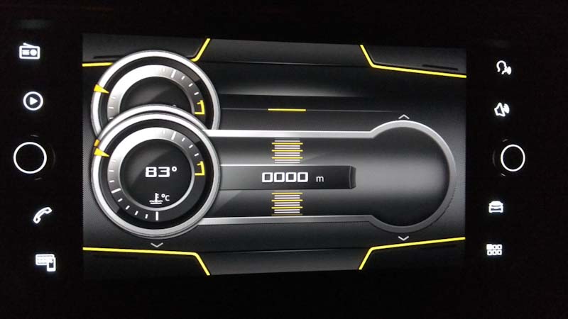

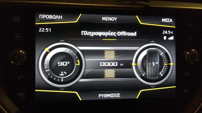

I also tried the off road menu
At first it seemed to be working but very quickly it started freezing up until the screen was blank.
See the pictures below.

Hi Aroza,
Yes i have seen this rallenty in my ibiza too.
But i do not change the color to green.. So try probably to turn back to red color and reset... With turn off the button of the radio for few seconds and see if the rallenty is on again...

Hi Aroza,
I own an Arona myself.
I didn't change the color to green!
And what does "rallenty" mean exactly? :)
I was thinking of reseting, but I dindn't want to lose all the radio stations. But I will try it...
Thanks again!

@Aroza,
ohh yes probably the Arona have the green menu' insteat of red in our ibiza!
I mean slowdown in several menu' like the black fiber i have seen this slowdown...i don't know how!!!
About the reset is to apply the modify after coding....but not will do any delete of radio station!

@Aroza,
This is what it looks like now.
