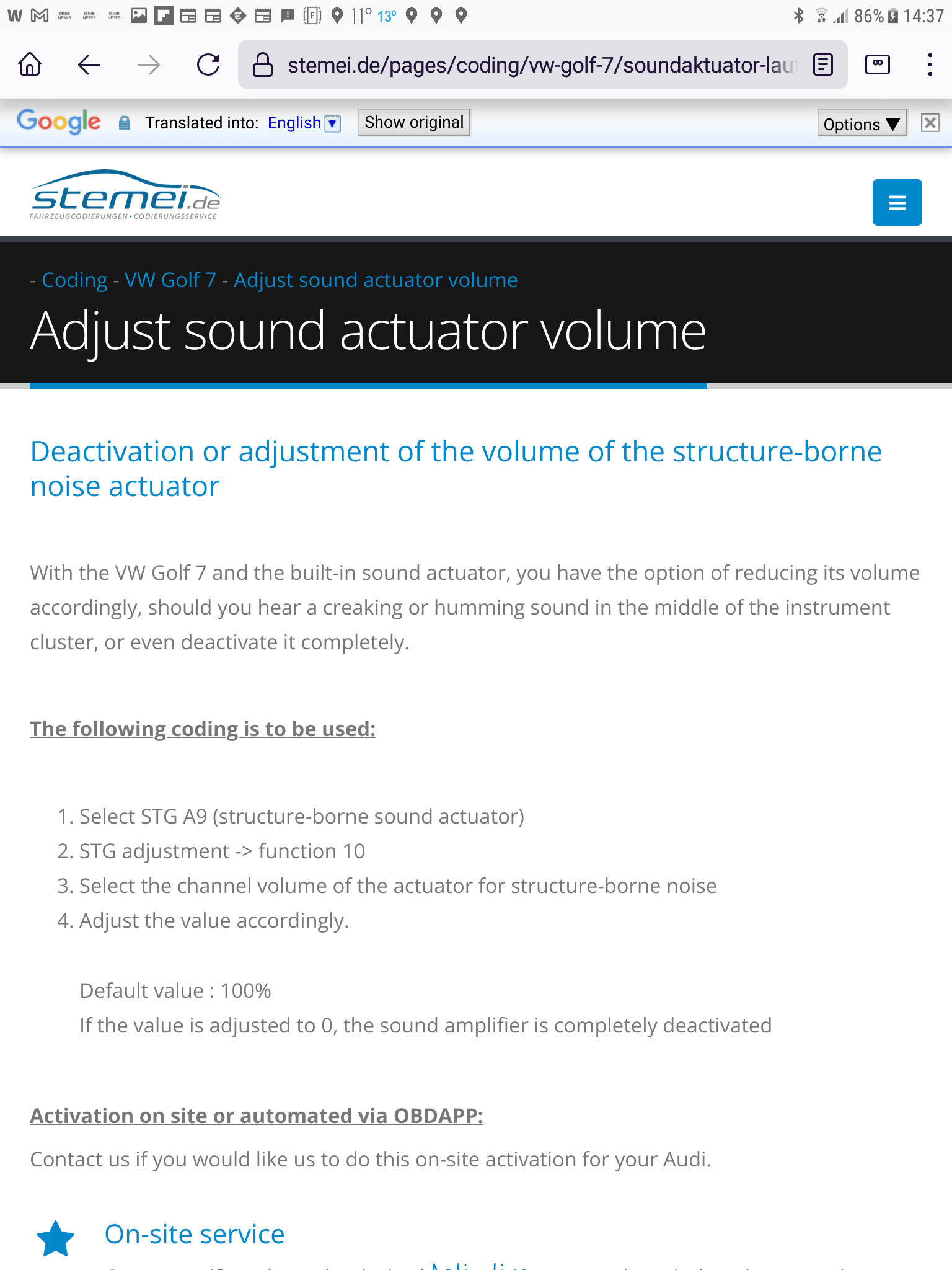

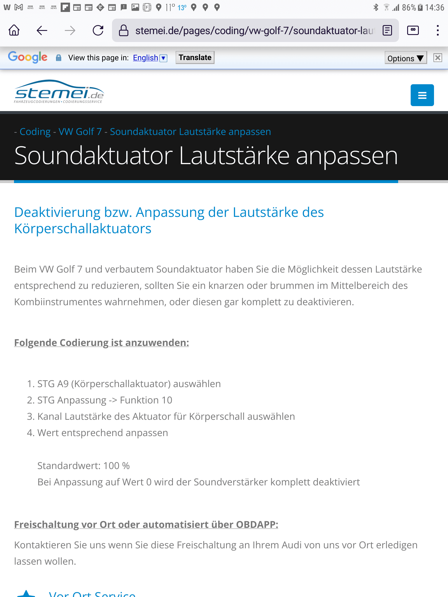

There was no option called "structure-borne noise actuator" or anything with word "sound" or "volume".
I believe it's this one from the Cupra Formentor PDF in German:
" Fake-Sound" (VCDS – kein SFD)
STG A9 Körperschallaktuator
Anpassung 10
Kanal IDE04472-Lautstärke des Aktuators für Körperschall
Gespeicherter Wert ist 100% → Neuer Wert dann beliebig
Translates too:
Fake-Sound "(VCDS - no SFD) STG A9 Structure-borne sound actuator Adaptation 10 channel IDE04472 volume of the actuator for structure-borne sound The stored value is 100% → New value can be freely selected
Can you find that. Should be in the A9 module. May be under Adaptions or Basic Settings ?. May be text still in German. It happens.
Function 10 = Anpassung 10
Is they key if you find it.
Golf 7 one is German and translated English.
You might have some luck. If so screenshoot them in Obdeleven. If you can't find the A9 module then it's hardwired in not under software control.
