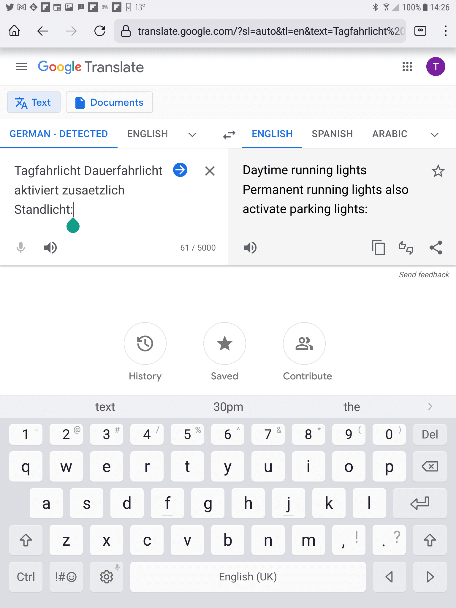

Control Unit 09
‎‏Adaptation
Daytime Running Light
Tagfahrlicht Dauerfahrlicht aktiviert zusaetzlich Standlicht:
New value: ON
‎‏Old value: OFF
This is what i used.

Did a translate.

I don't know whether you have an equivalent on the Formentor to method 2 on the Ateca:
That one enables a menu choice on the infotainment screen so you can turn the DLRs off when it takes your fancy using the infotainment screen. They are sort of compressed menu options which get liberated to do things. I got that one off the Club Leon board at the time. Also an example of where I screen shot a screen with settings and put it through the Google translation app to read the graphical image and translate to English from the German field names.... useful at times when published mods are a bit scant on the exact procedure and if you dont know German can be a bit tricky.
