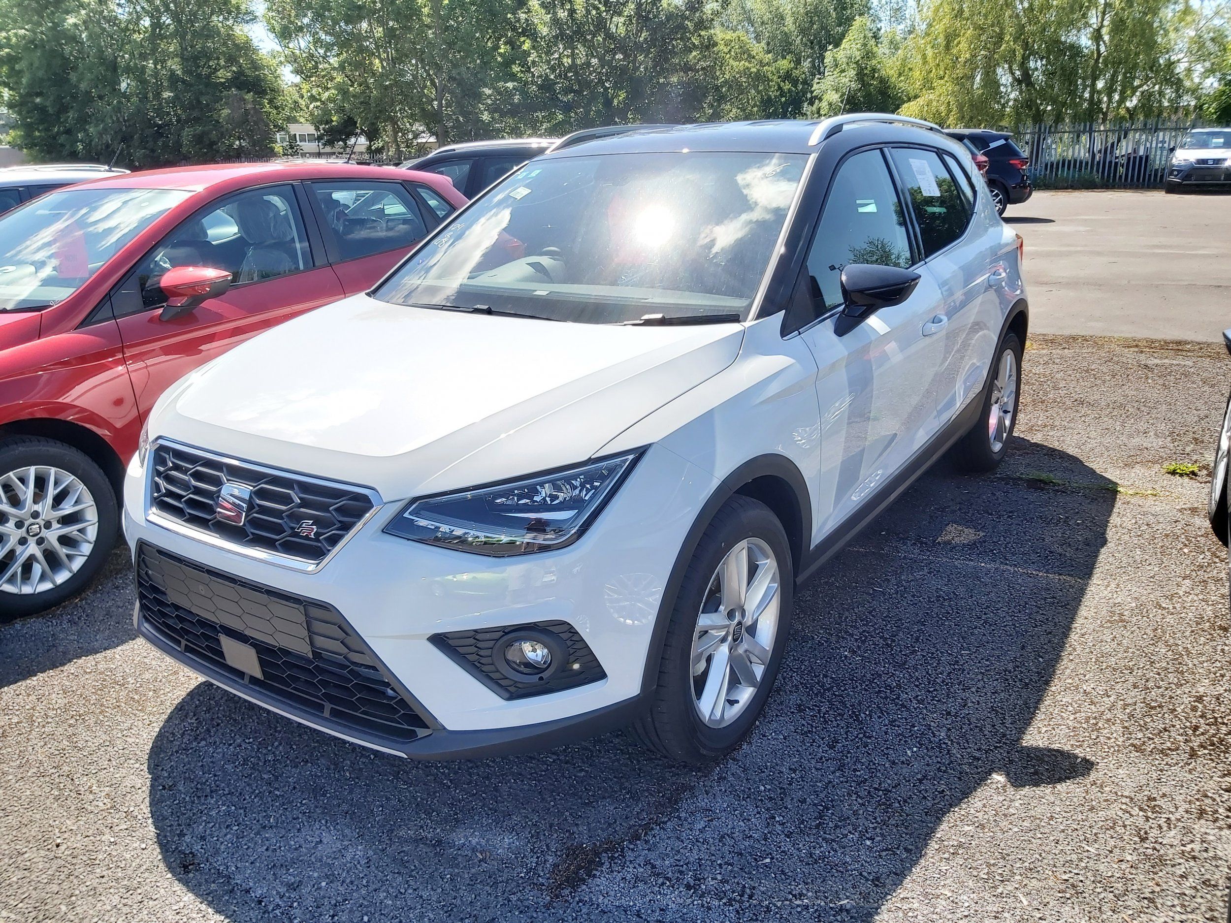

MMhmm, I'm pretty certain it's MIB2 just based on the interior and exterior. I've attached of the car :)
That's pre facelifted I'd say. Mib2 standard. No SFD I reckon so the world is your Oyster.
