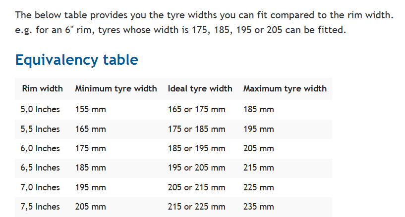

Thank you so much, i will go fór either the Ibiza or Leon Mk4 wheels. One more question Serdar, if the rim is 7 inches wide, will 205 mm tyre be fine? Or should i choose 215 or even 225 tyre?
The table below shows the ideal and maximum tyre widths for a given rim width.
Keep in mind that original tyre size for Leon Mk3 16" rims is 205/55.
If you go for 215 or 225 tyres, then it's better to lower the sidewall ratio accordingly, like 225/50.
(Also 215/50 and 225/45 have acceptable circumferences but I'm not sure whether such sizes are in production)
