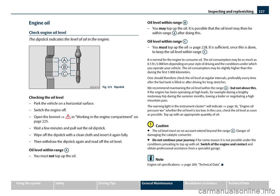

If my dipstick is at 1/2 it doesn't take much to get to 1.4 and then the oil light comes on. As @SuperV8 says, fill it to full and monitor the mileage until the light comes on. Very to know how much oil you use when you say it was filled between 1/2 and 3/4.
