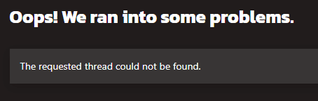

There was a useful thread on EA288 oil consumption - but now its no longer found?
Any ideas where it went?
EA288 184hp 2.0 Diesel - Oil Burning - your findings?
