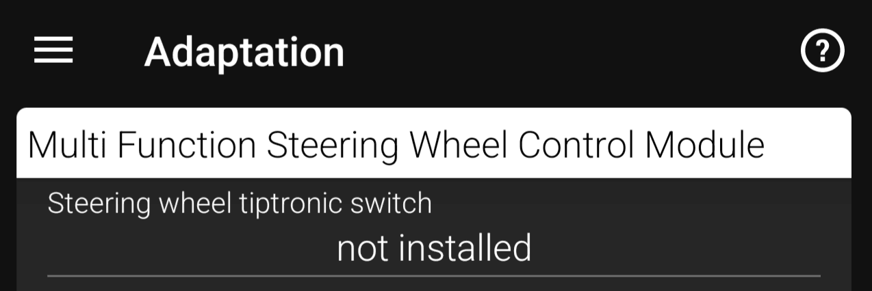

Yes, change the steering wheel to one with paddles, and code it in with VCDS. You need to check that the steering column controller fitted will support the paddle change.

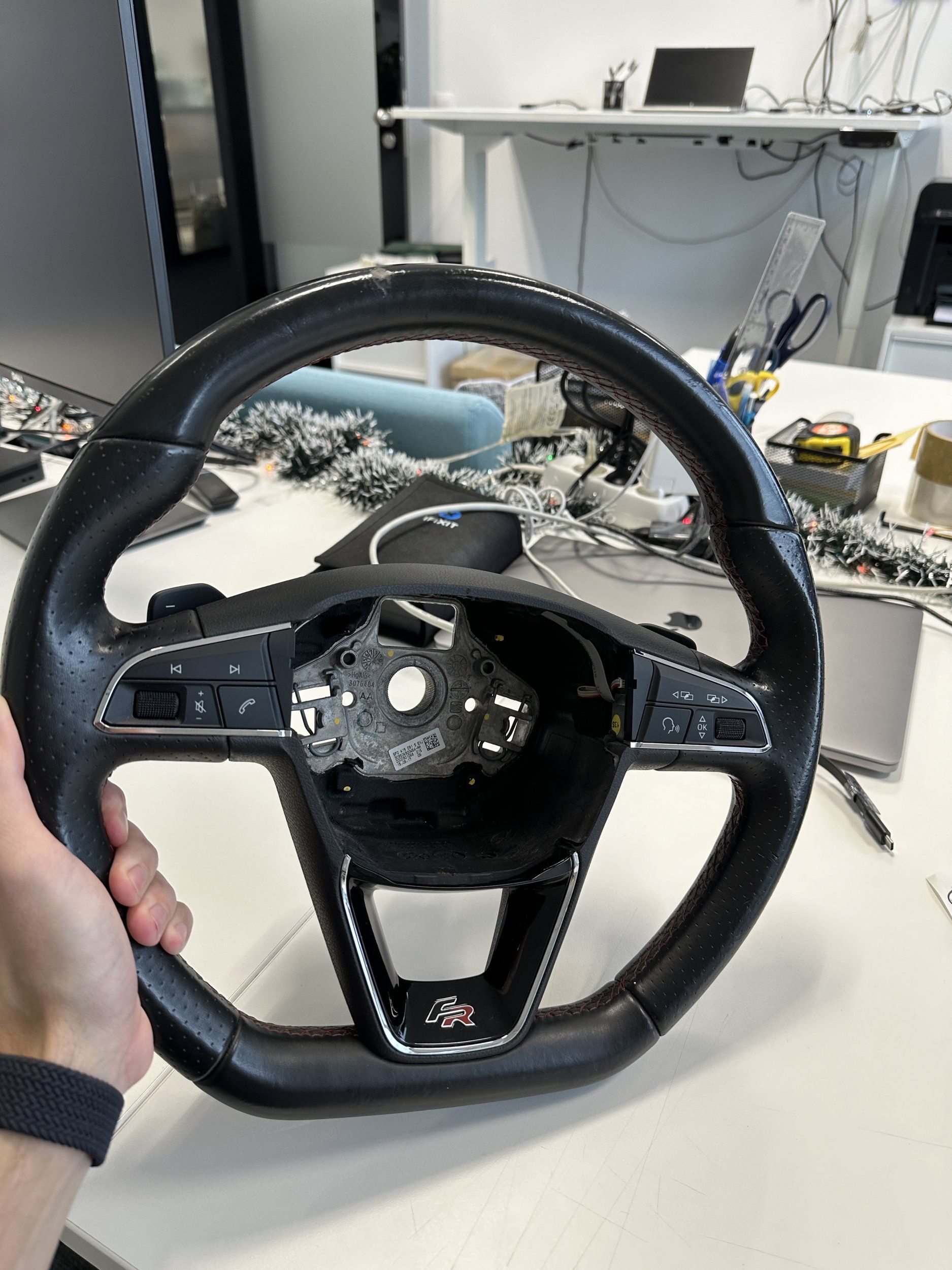

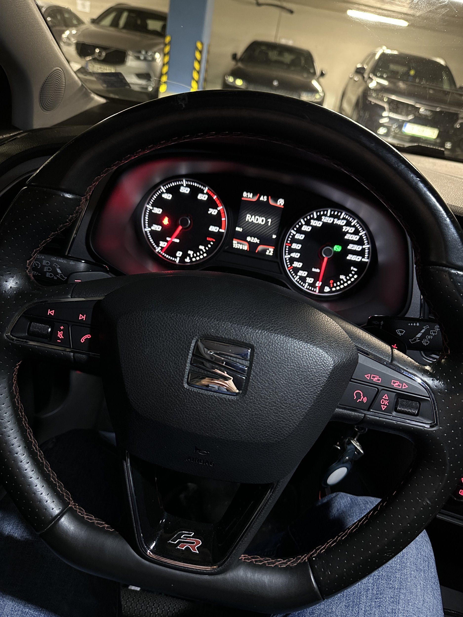

I did that on my 2013 Leon FR. Bought second hand steering wheel with paddle shifters and it was just plug and play for me. Nothing needed to be coded on the car, it recognised it straight away and it works perfectly.
It costed me arround 70 pounds off Ebay. Without the airbag, of course
