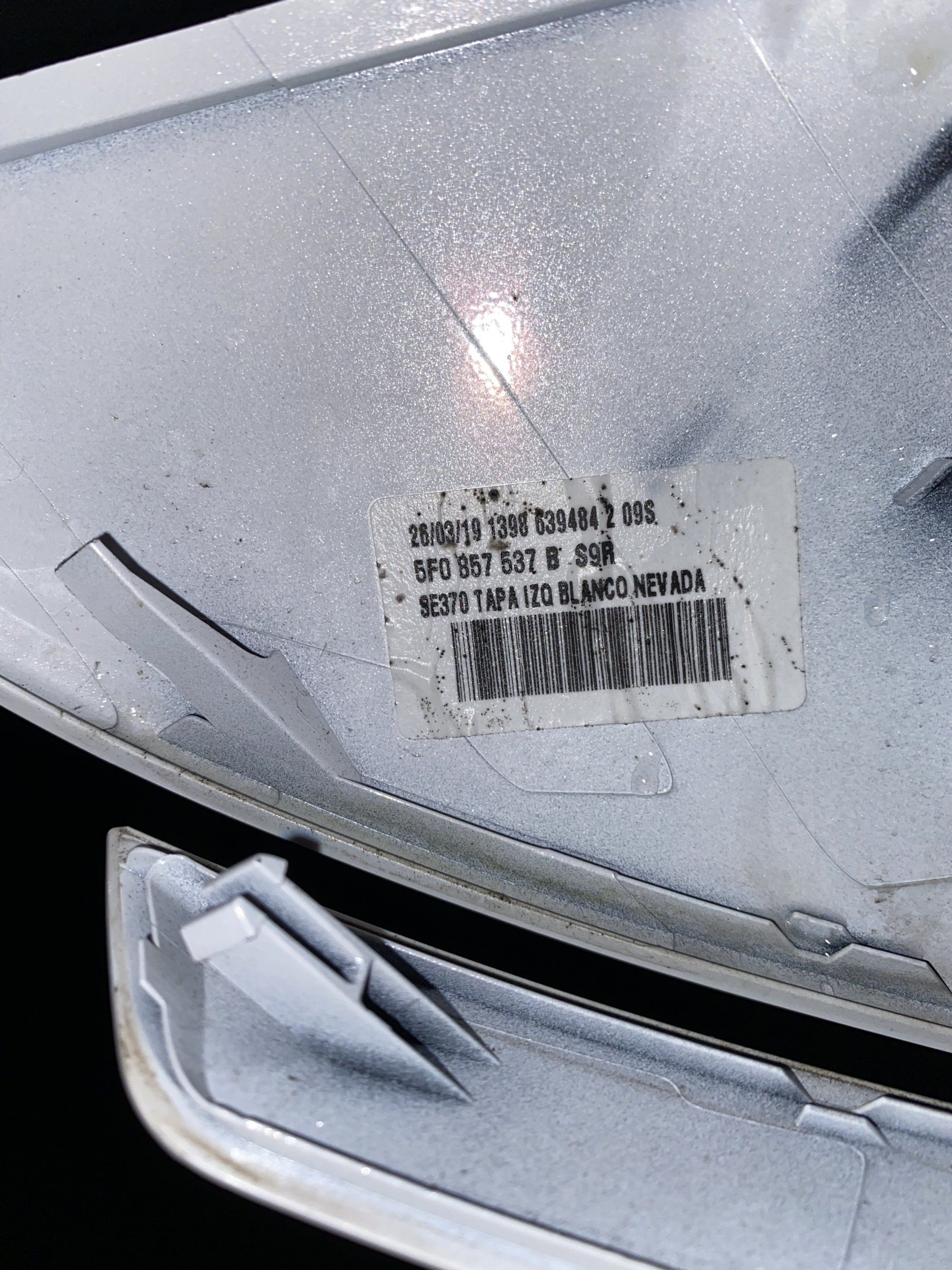

Is there a way i can find out my paint code at all, ive checked the boot and the sticker has been removed that contains the paint code and ive checked all other areas like the side of pillars and under the bonnet
would be great if someone could help as i need to order some paint tonight
Is there still a PR code sticker in the front of the owner's manual?
Also - if you specify the year built and what colour you think that it is, you will be able to find the paint code from the options lists.
No have no stickers in the owners manual either
so i decided to take the wing mirror cover off and found the code S9R
