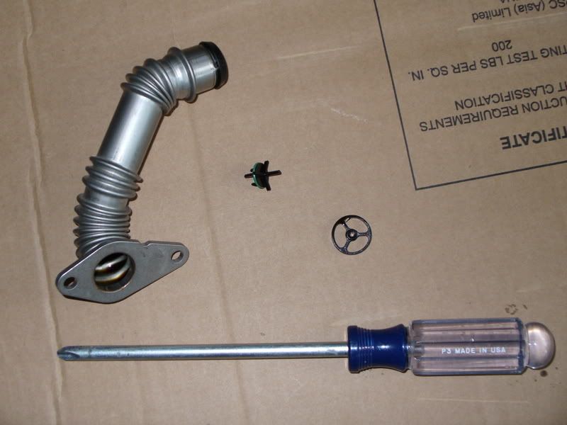

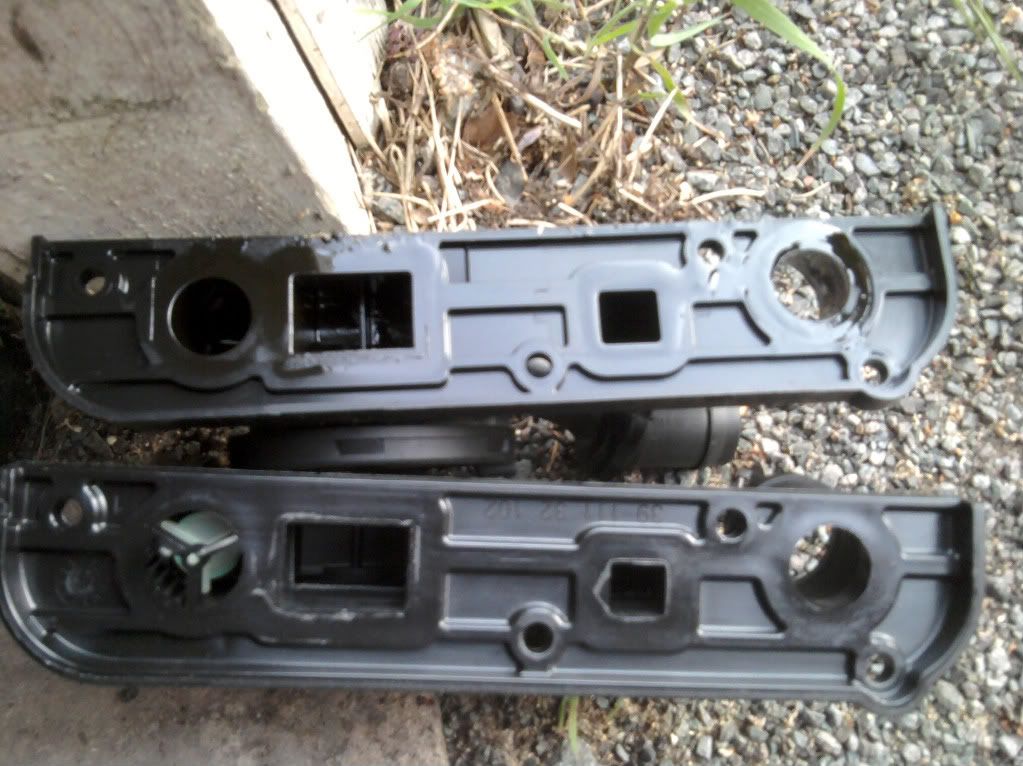

Well picked up the revised pcv valve. The latest revision is 06F129101N.
The newest one is the bottom one (with the valve)
Before fitting the replacement.
Took 5 minutes to change, and the verdict!...............Has made no difference! Still hunting / misfiring slightly.
Will have to get hooked upto Vagcom, to see if there are any fault codes.
