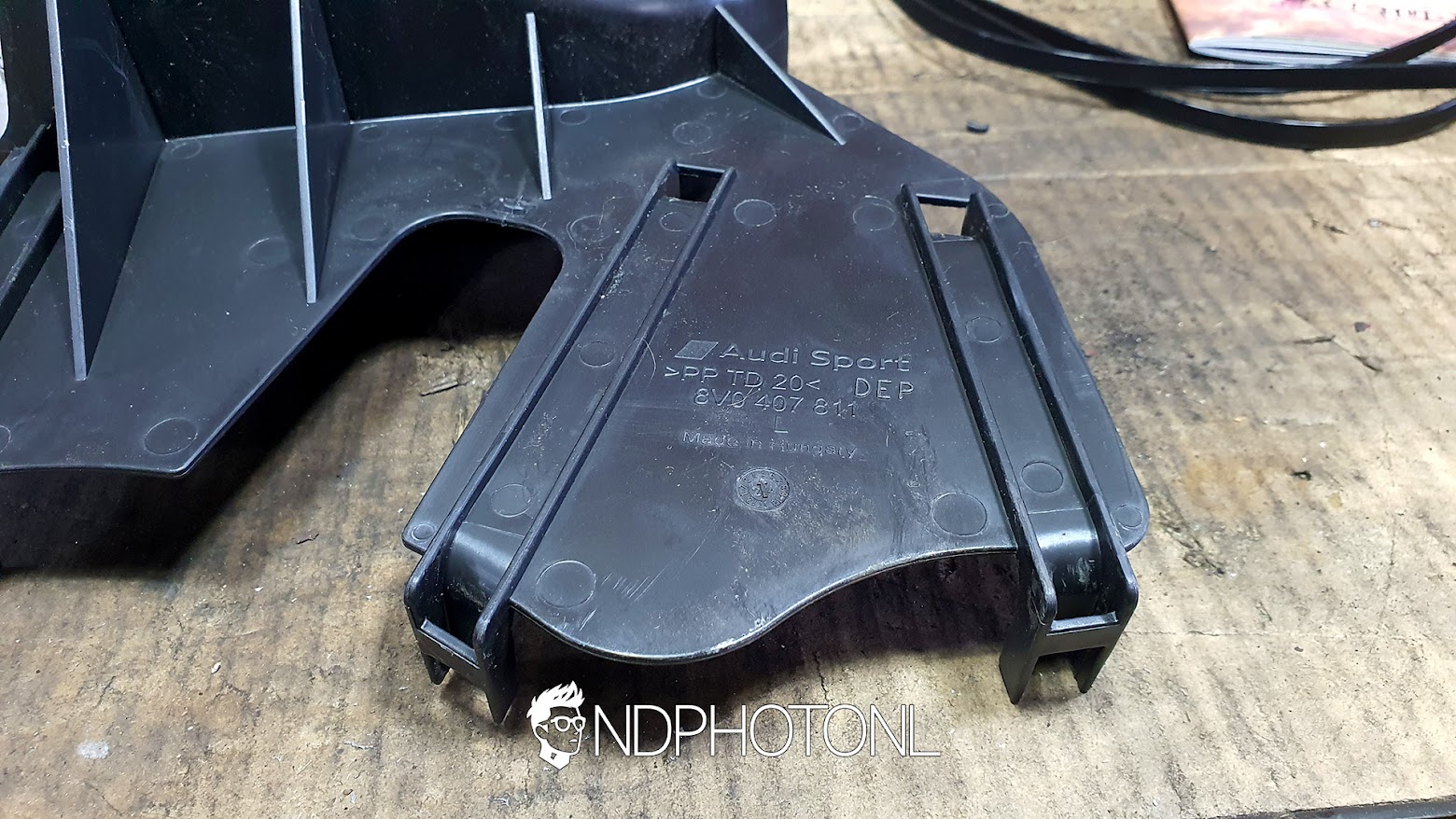

Bought the Audi RS3 8V brake ducts / deflectors. They are by no means a straight fit and you need to hack away most of the material. I still need to fit them, as I have other priorities.
Partnr : 8V0407811 / 8V0407812
