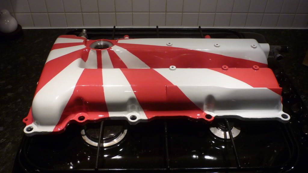

Dont mean to be critical but, it looks like it needs a few more coats of paint? Also I would have thought it needed at least 12 hours for the paint to fully dry and harden. Did you lacquer it?
Looks better than standard though.

I painted a rocker cover a few years back with rattle cans
Just goes to show what you can achieve with £10 worth of paint and a roll of masking tape.
