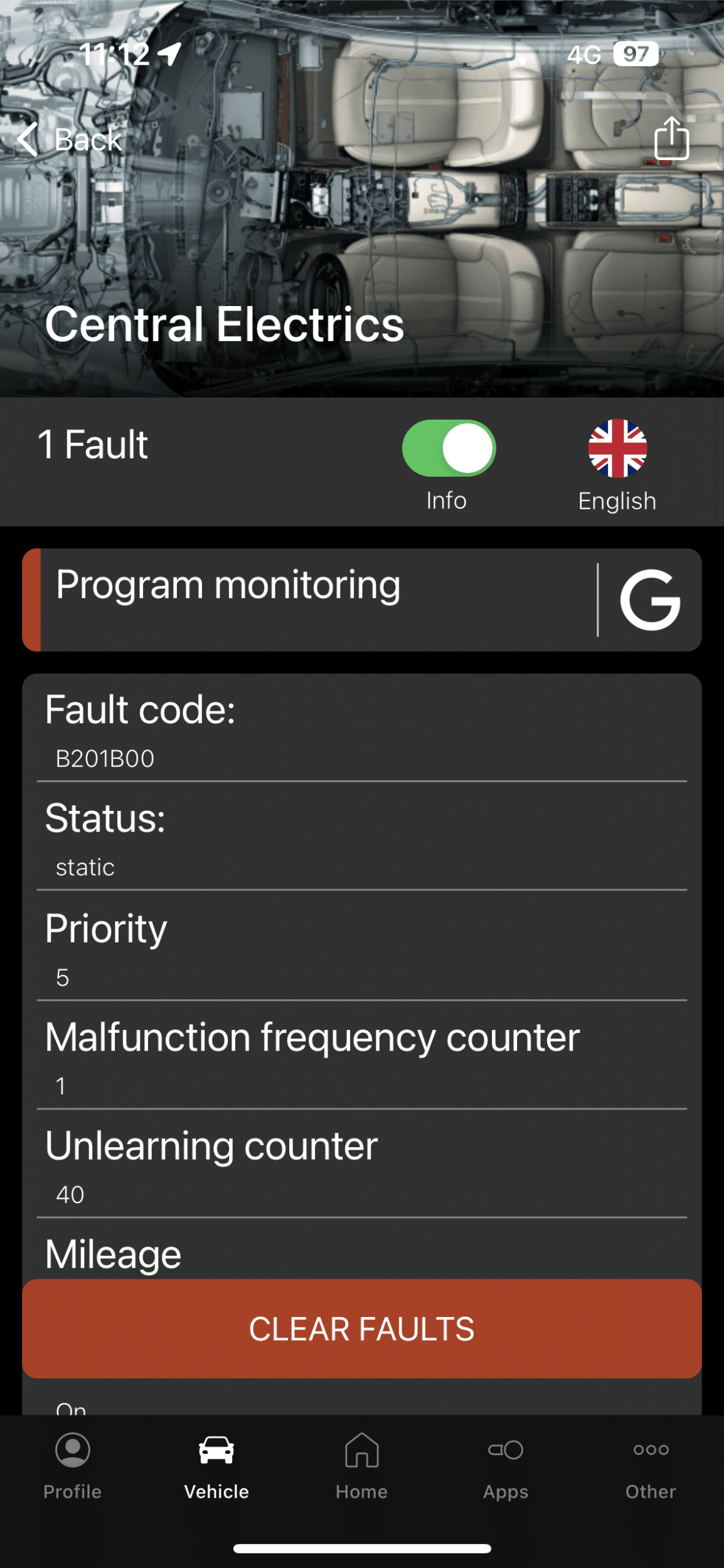

Hey everyone, I was scanning my formentor yesterday and realized I have 1 static fault:
It's in 09 (Central Electrics) Program Monitoring B201B00.
Has anyone seen this?

Hey, thanks for answers. Yes I have updated the software via USB by myself, but turns out that was not relevant at all. (I thought it had something to do with it as well).
My key fob battery was low believe it or not. After changing the battery, I was able to clear out the code and it never came back.
