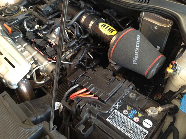

I forgot to update my thread. Some weeks ago I changed my DV with the upgraded forge. It makes a difference especially in digs and also there's no stalling in shifting. The blow off sound is very different too. Here are some pics and a video. Oh in the second picture you can see the size of my almost invisible turbine wheel compared to my car key :lol:
Forge - DV Sound
I'll be back with a stage 2 maybe stage 2+... we'll see :whistle:

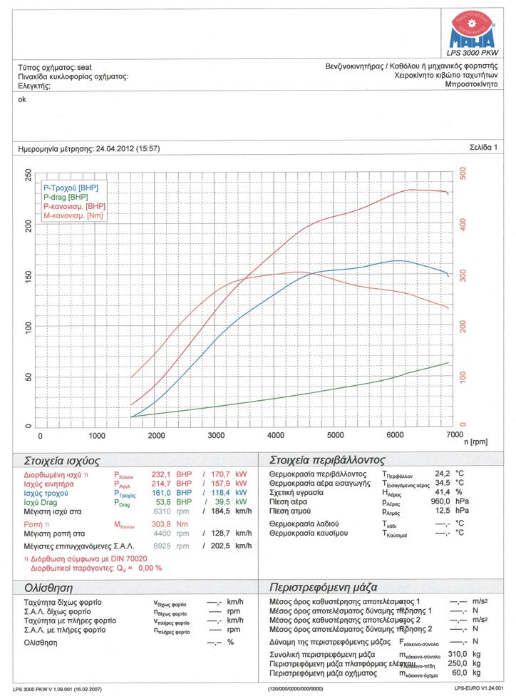

Waiting for my stage 2, I decided to dyno my car to see the after gains. Temperature and humidity level aren't the best but they'll do.
I have to admit that I was surprised along with my tuner and the people working at the dyno.
May I remind you that I'm still a stage 1 Revo (file 3) with custom carbon intake, Forge DV and custom intercooler.
This is maha rollers so bare in mind that we look only at the first number (red line on the graph) for bhp (DIN corrected).
The car has received a fair amount of fine tuning.
:love: :love:
milltek tbe, forge wastegate and iridium spark plugs to be fitted soon.
Dare I say 255+ bhp?

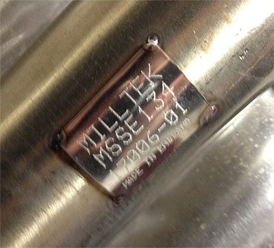

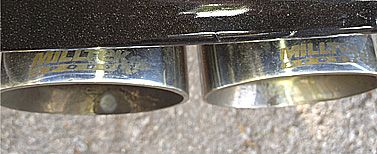

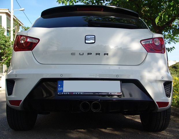

Got my stage 2 installed today, milltek tbe exhaust, forge wastegate, iridium plugs (NGK BKR7EIX). I also had the rear diffuser and inserts painted gloss black.
It hasn't adapted yet but my first impressions are great sound on idle, nice burbling while cruising and amazing pops on shifts!
It feels way faster, I can't wait to see by how much...
Visually it looks better and gloss black diffuser suits very well with my gloss black rear wing.
Here are some pics and I'll post a video with the sound in a few days.
That's my wastegate, you can see a bit of my DV on top too.

Back with my stage 2 dyno. Due to summer coming, along with high temps the tune runs quite safe, so this power was expected. I was impressed by the torque which although less as a number, it holds for a whole 3000 rpm range. New dyno will follow in winter with more aggressive settings, along with a small mod that will help the car run more smoothly. ;)
