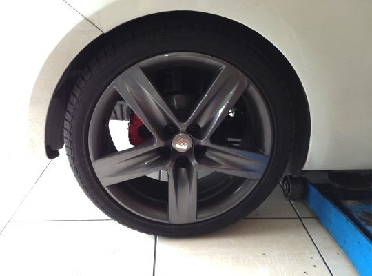

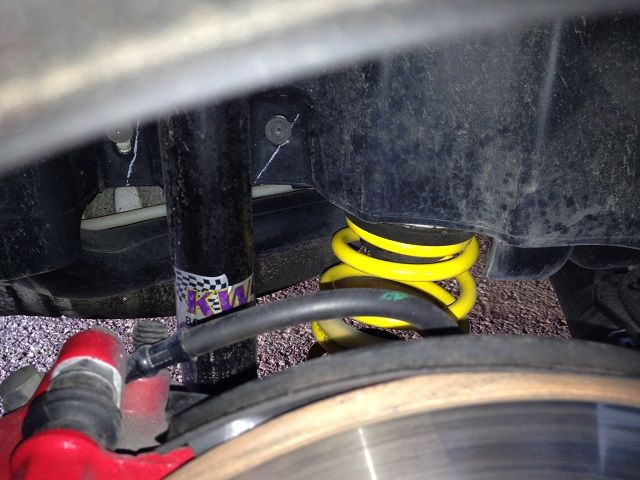

So the kw v1's are on, the car lowered something less than 5cm, the ride is great, the front isn't that stiff anymore, the rear is a bit firmer but that helps a lot with digs. It is a great improvement all around and I highly recommend it, the car can actually turn now!

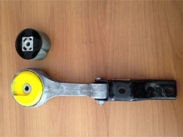

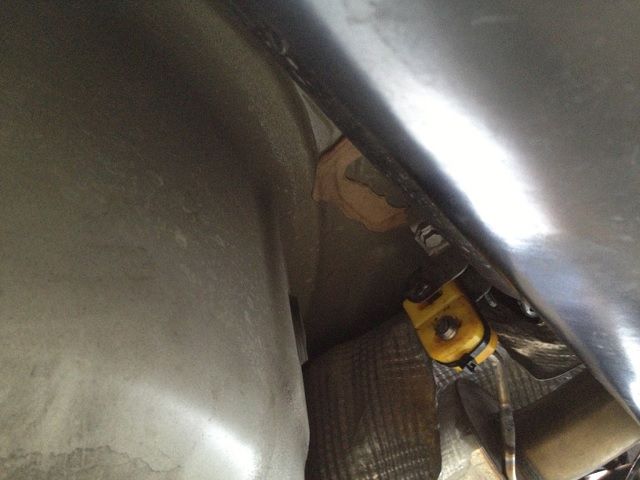

Following the fitting of the coilovers I decided to install the Powerflex mounts. So I installed the engine mount and five exhaust mounts, since the car's lowered so much that the exhaust was only a few mm away from the rear axle. What can I say, now the car is as stiff as a rock and the engine doesn't move one bit. The feel of the steering has changed dramatically!
When I get a chance I'll post an engine video where you can see the improvement.
Some pics:
The stock mount compared to the aftermarket:

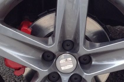

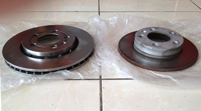

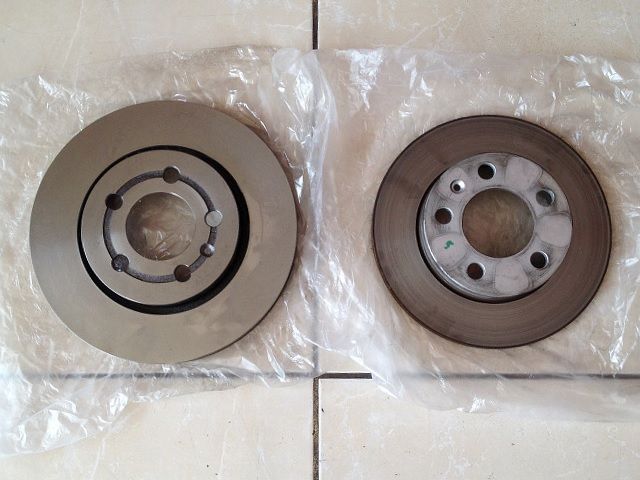

So I bought the s3's rear brakes, brand new with EBC discs and pads, I got them painted red with electrostatic coating and installed them today. I also got the chance to change my brake fluid with the top rated Motul's RBF600.
New vs old disc, before I sprayed the center black so it wouldn't rust.
Side view.
Two closeups, mounted, where you can see the cover which was cut and "unfolded" so it could snugly fit the new brakes.
Old vs new, mounted.
Right now I'm in the bedding-in process, so I haven't gotten a chance to see anything huge in terms of feel, but as the pedal becomes firmer, it's starting to show.

Looking good, your car is really coming along now queen, it's a weapon.
Really liking those new rear brakes, I have a few questions about them. Firstly is it brakes for a mk1 Audi S3? (1.8 20vT 225). What cover do you mean when you say it was cut and unfolded to fit? my rear brake discs are worn and I need to replace them so I was looking at getting a similar set up like you have there.

Brakes look good :)
Thanks :)
Thank you! Yeap mk1 s3. The cover that sits behind the rear discs and helps keep them cool. I believe that all cars have one. If you look at your rear brakes you'll see it, it's a round metal thingy. The cover had to be either removed or opened or the new discs wouldn't fit. The only downside is that the discs are pretty damn heavy, so if you're looking into buying one like these try to get them drilled if possible.

Ah I see, thanks for your help! I think i'm going to do this to mine too, do you still get the S3 calipers available to buy brand new?
EDIT: Did you need to buy the carriers aswell?
queen
~Nassia~
Nov 29, 2010
727
87
Athens, Greece
You're welcome! Yes you can buy them new, you need calipers, carriers, discs and pads. Make sure you clarify that your car is front wheel drive so you get them with the right adapter too.

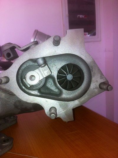

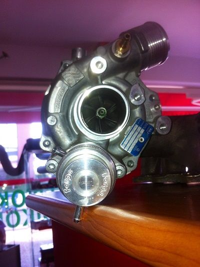

Hybrid power ;)
k04-23
Compressor wheel
stock:
hybrid:
Turbine wheel
stock:
hybrid:
Even though the car is still adapting I can feel a huge difference. Spools earlier and it has a stronger top end. Louder exhaust tone, louder dsg fart and different (better) blow off sound, like a k04!
