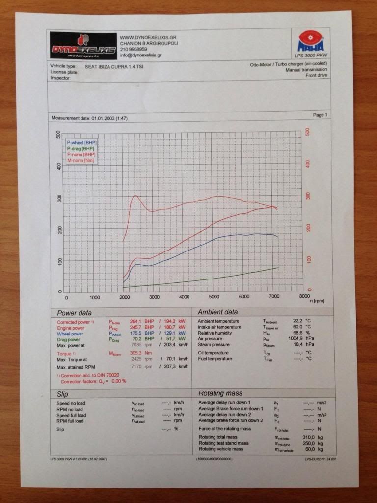

Finally dyno'd. Roughly 265hp, 25hp more than stage 2 which explains the 2.5 car lengths that I gained in the 50-180kph roll.
Results as expected with the Revo stage 2 tune on a hybrid.
Custom tune here I come! Should be able to gain at least another 10bhp with much better power band.

Whoot!! Looks good Queen. My guess is that your pretty happy with these resaults? Will you be planing any other big upgrades in the futer?
queen
~Nassia~
Nov 29, 2010
726
86
Athens, Greece
Thanks! I'm happy as far as the tune goes because it's just a stage 2 tune, not one especially made for a hybrid setup. The power curves suck big time which is my main focus now. I'm not after a certain number but I want my car to be smooth, with power gains in every gear throughout the power band. Right now until 150kph it goes just like a stage 2, those 25hp more show above that speed. That's why I'm leaving Revo for a custom tune.
Very nice queen, not having any problems with it running that much power?
Thanks, no problems. Here we have hybrids with custom tunes making 280bhp or more running strong.

bloody hell. I noticed no gain on the dyno with my loba upgrade, think its down to the actuator setting they used to it works like oem until you electronically change the map. You should be good for a 270-275 which is awesome. Hopfully im good for another 10bhp. Just be careful. I would get the map developed, dyno the car then de-tune it to be safe. Its the pistons i would worry about. But good luck, hope you get some good results

I'm not after any numbers, I basically want a fatter curve throughout the rev range. Oh and the tuner I'll be going with has a dsg map developed as well, which will go on my car along with the tune. Thanks!

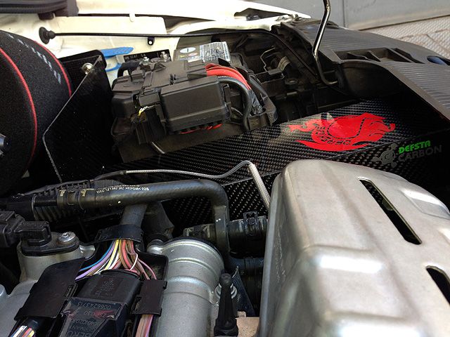

I went for a custom tune, as I'd said, Overload Performance, gaining about 35bhp, hitting the 300 mark BUT the car started suffering from mid to high rpm misfires due to soft valve springs. So we detuned the car to 1 bar redline which is my safe line for misfires, waiting for the stiffer valve springs made by Supertech so I can run higher boost (1.4 bar redline).
Meanwhile I decided to spruce up my engine bay and fitted custom carbon ram air type intake, carbon heat shield and a bigger pipercross filter (C0177). We also fitted the exhaust check valve back to its original place on the intake.
The mod was done by the same shop that tunes my car together with Defsta Carbon. Everything was done from scratch, they made a mould for every part. They now offer the whole carbon intake package ready for the ibiza cupra dsg that have the battery in the engine bay.
I also changed my coils with the uprated by BERU.
