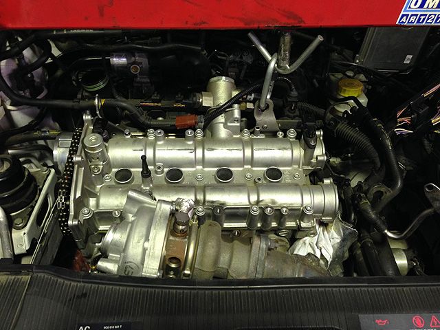

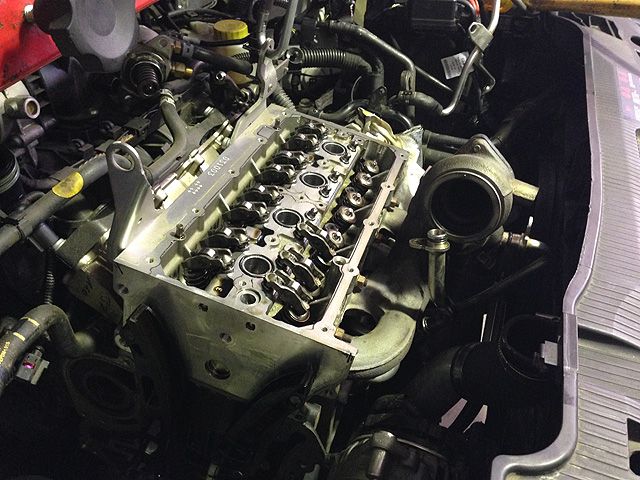

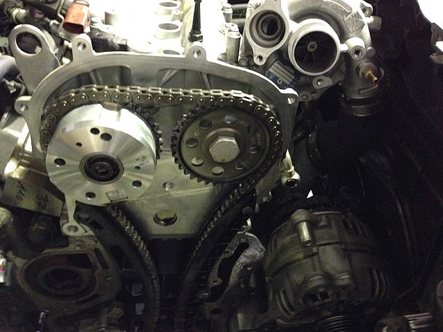

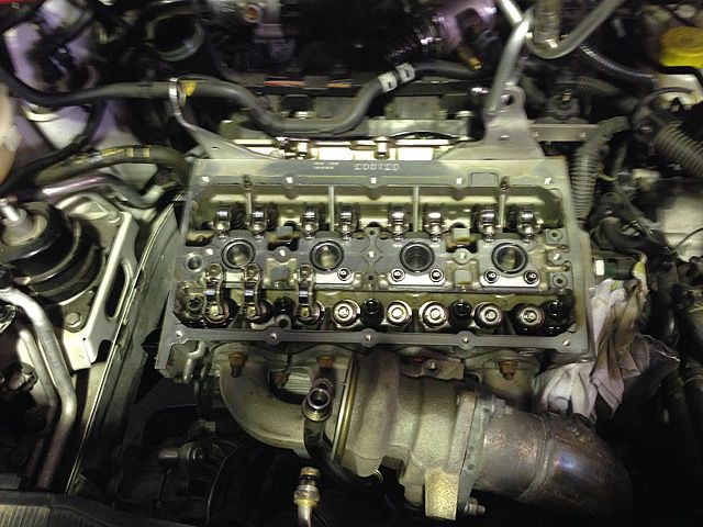

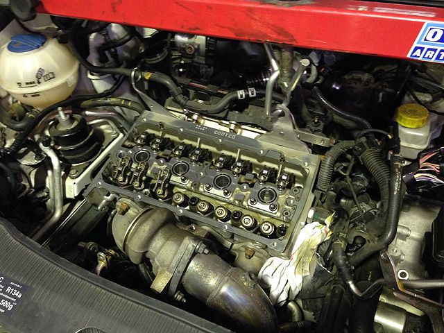

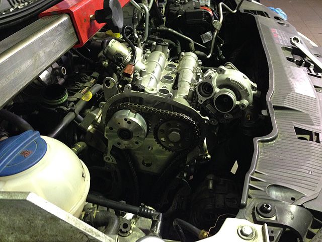

So since I had become best buds with the check engine light and we had figured out that the misfires were caused by the weak exhaust valve springs I decided to change them. Since we couldn't find any springs from Supertech we went for the uprated stiffer oem valve springs that all the latest '12 and on 1.4 tsi's have, ETKA code 036109623AC (in case anyone wants to change them), which are color coded in red and not green as I'd read in another forum. They're much stiffer than what I had, so much that you can feel it in your hands.
The project was carried out by Derekidis Service, where he used a special tool that compresses the cylinder so that the valves won't drop inside (sorry I can't describe it any better). It took him 4 days as he works alone. Total cost including labor and an oil change less than 500 euros.
Some pics from the whole valve springs process (I'll post some with the tool later):

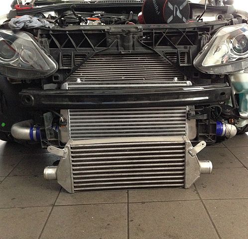

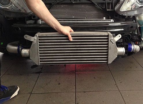

But the damn thing wouldn't stop whining! So we decided to change the cooler with a bigger, wider, thicker one from China (by the way here everyone goes for a made in China universal cooler that are pretty good for the money). It's almost 11 liters rated for 350bhp and in several runs going in 4th and 5th to the redline with 30°C ambient, we logged 37°C tops. With my previous custom cooler we had logged 35°C with 15°C ambient. After it was fitted we went for a run and the whine was gone (something must have hit the old cooler and made a hole in it) BUT this time the wategate's membrane went bad and I was hitting 2bars boost lol. I'm taking the wastegate for a service next week and provided that everything else goes well we will tune it one final time in 2 weeks. Right now I have a stock wastegate on and the car holds 0.8 bar boost throughout the rev range.
Cooler pics:
VS the old one:

Hey Queen,
Would you be able to post details of where your new Universal Intercooler came from?
Ideally with a linky so I can buy it?
Hi,
I bought it from a shop here, they don't have a website or ship.
I can give you the dimensions so you can get it maybe from ebay, core size 21 inches length (full length up to the pipes 25), 11 inches height, 2.6 inches width.
The pipes are 2.36 inches because that's the size of the throttle body, you don't need to go any bigger.
Hope it helps.
