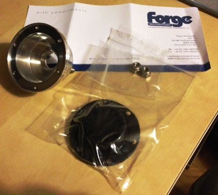

During the last 12 months my wastegate had broken 2 times. The diaphragm, to be precise.
So after an email to Forge UK, these goodies arrived today:
Apparently I wasn't the only one having this issue again and again, so they have redesigned a part of the wastegate and it should hold better. The new wastegates come with the upgraded part. They sent it to me free of charge, as well as a new diaphragm. I recommend the upgrade to anyone who is having the same issue.
Here are some closeups:
Thank you Forge for the wonderful service! :clap:

Not good to hear Queen, I have that wastegate too! Can I ask what the symptoms were when it failed? I might email them and see if I can get the revised part too.

You can't miss it, check engine light was constantly on, would stay on even after restarting the car and the logged fault was something like pressure too high - overboost condition.
In my case (ripped diaphragm) the pressure wasn't able to be contained, then the valve couldn't open, which caused the turbo to over-spin and overboost.

I can't believe what I have just read.... this all happened to me!! I got the CEL up and it showed the fault code as 'overboost' and I had terrible problems, My engine would cut power and made less than standard power on the dyno... me and my tuner couldn't figure out what the hell was wrong so I ended up changing out my yellow actuator spring for the green one and updated the Revo map and it sort of fixed it but my car only made 205bhp on stage 2 and now I know why, I have a ripped diaphragm the same as you! I hope it hasn't damaged my engine... better get on the phone to Forge.
Did you fix yours ok with the revised wastegate?

There is a way to check the diaphragm's condition without removing the wastegate. There is a tool that connects with a long and thin hose to the hole on the head of the wastegate and applies pressure so you can check when the actuator moves to open the valve. Like this: https://www.youtube.com/watch?v=aIBKyFi9YqY but it can be done as I said without removing the wastegate.
Yes, a new diaphragm would be enough but since the new part will keep it from getting ripped again, even better.
