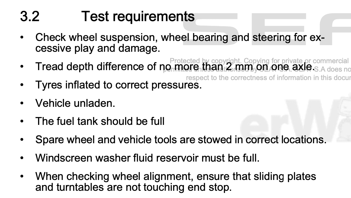

See attachment for test requirements. Did you do any repair to the suspension, or is it only checking?
If you have DCC, you need to do a basic setting after working/repair on it, which is done by getting the car in the air and let all 4 wheels hang at their lowest point. Then do the basic setting
On vehicles with vehicle level sender, carry out basic settings for wheel damper electronics ⇒ Vehicle diagnostic tester
