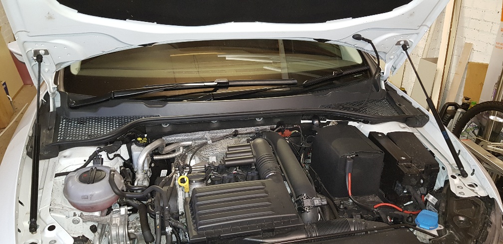

I have done this mod. I bought 2 gas struts from bestpartstore.co.uk
Part no: 140794 Stabilus lift o mat.
240nm eject force (lifts bonnet perfectly)
length is 602.5mm
stroke is 241.5mm
Also need 4 x 10mm steel ball stud bolts M6 which I bought from eBay.
I made a couple of Steel brackets and fitting it all took 20 minutes.
You will need to trim the foam inserts on each side of the bonnet bracket which was easy enough with a scalpel blade so your bonnet will sit flush when shut.
Hope this helps

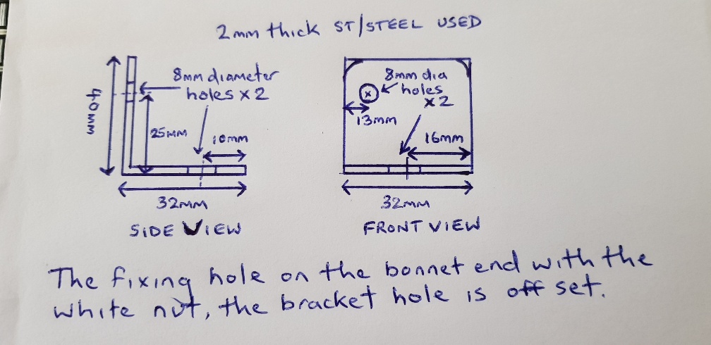

ADM - what dimensions did you use for the brackets?
Reactions: ADM
Here you go, hope this helps.

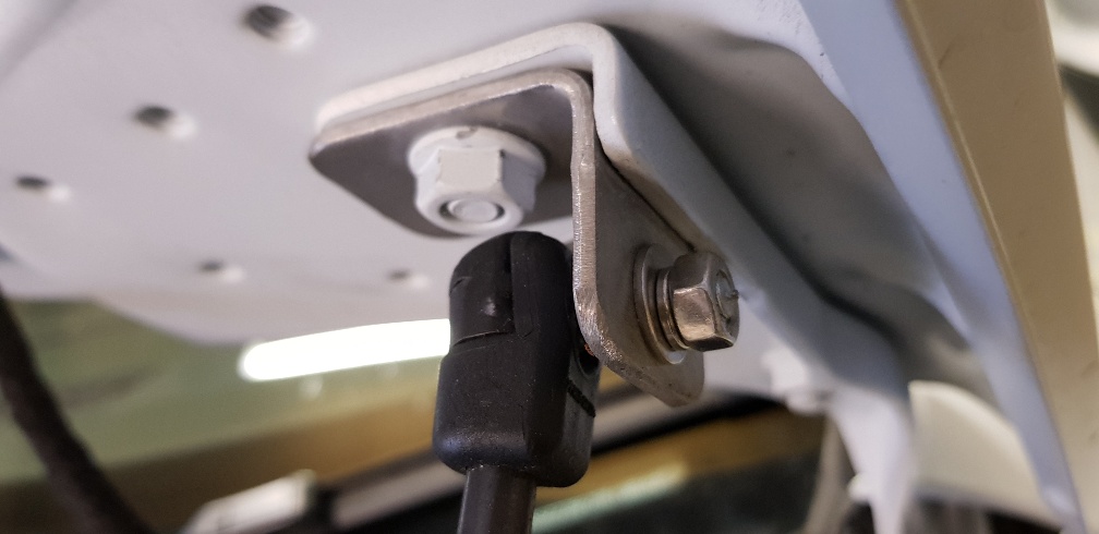

Thanks for the info ADM! Can you post a picture of the other side of the gas strut?
