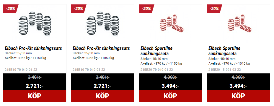

I own a 2017 base model Leon ST which unlike the FR/Cupra variation doesn't come lowered from the factory. Therefore I was hoping to somewhat be able to replicate that very same look, but instead on my base model. I am a sucker for aesthetics and the look of a lowered car however I also wouldn't want it to impact the driving comfort too much. After looking online for a bit the Eibach Sportline & Eibach Pro-kit seem to be reasonably priced here in Sweden, does anyone have any experience with these? The Pro-kit offers a 35/30mm drop, whereas the Sportline's offer a 45/40 drop.

I can't offer a 100% comparison as I ran Eibachs on a Cupra 4 Drive. And the 4Drive only had Sportline's as an option and their springs were different to the normal Cupra ST due to the added weight.
However, I would say that if you're after a more OEM (Cupra) look and retaining road comfort, then Sportline's are definitely not the choice. As much as mine where great in general, they suffered on the bigger bumps, even hitting the bump stops. I'd say stick with the Pro, which will still sit lower than a Cupra anyway (Cupra and FRs sit 10mm lower than stock).

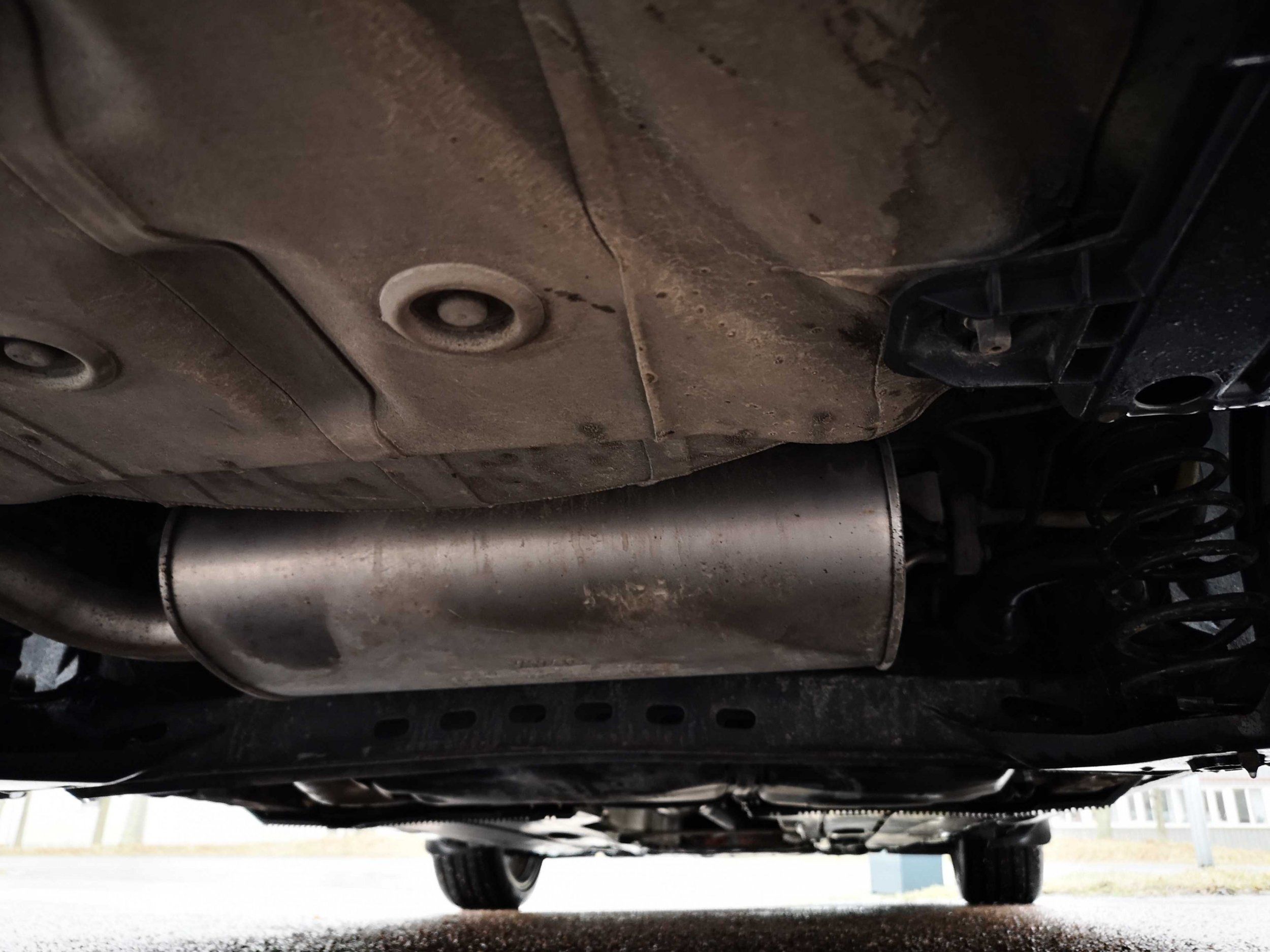

As for which version you need, independent or cross beam,, the easiest way would be to just look under the rear of your car. If there is a beam connecting both sides of the suspension, then you have the cross beam, where as if you have hinged joints, the you have the multilink independent. I'm sure in the UK it was only certain higher engine and trim levels (FR and aCupra) that got the multi link, but I could be wrong. This might help you identify what you have:

It's been pouring rain here in Sweden for the last 3 days straight so I haven't had a chance yet to look under the car to figure out the axle bit but hopefully the weather will clear up soon. The pricing here is absolutely insane though, around 220 pounds for just the Pro's but seeing as everything is always very inflated here in Sweden compared to other countries I'm used to it by now haha
You're 100% correct. It's been pouring buckets here for a few days straight now, but the second I saw it clear up just now I had a look underneath and I do have a cross-beam axle, so it might have been the same for us here in Sweden where only the higher-end models got the multi-link
