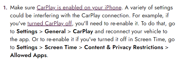

I had the same issue like yours and my iPhone 13 even car-dealer wasn't able to fix it
however, for me was not the car but my phone, car play was not enabled at all, see screenshot
once CarPlay shown-up in iPhone I have first connected with a USB Type-C lighting and it worked as charm, now it connects automatically in bluetooth mode with no need of US cable
I truly admit, this kind of setup is not very well explained

Everything is fine in my phone, and it was working without any issues in my previous cars, except this Cupra Formentor.
Problem is not related to my phone because when I open Full Link app in Infotainment, it immediately gives "Function is not available" error. It is not even searching for a phone.
