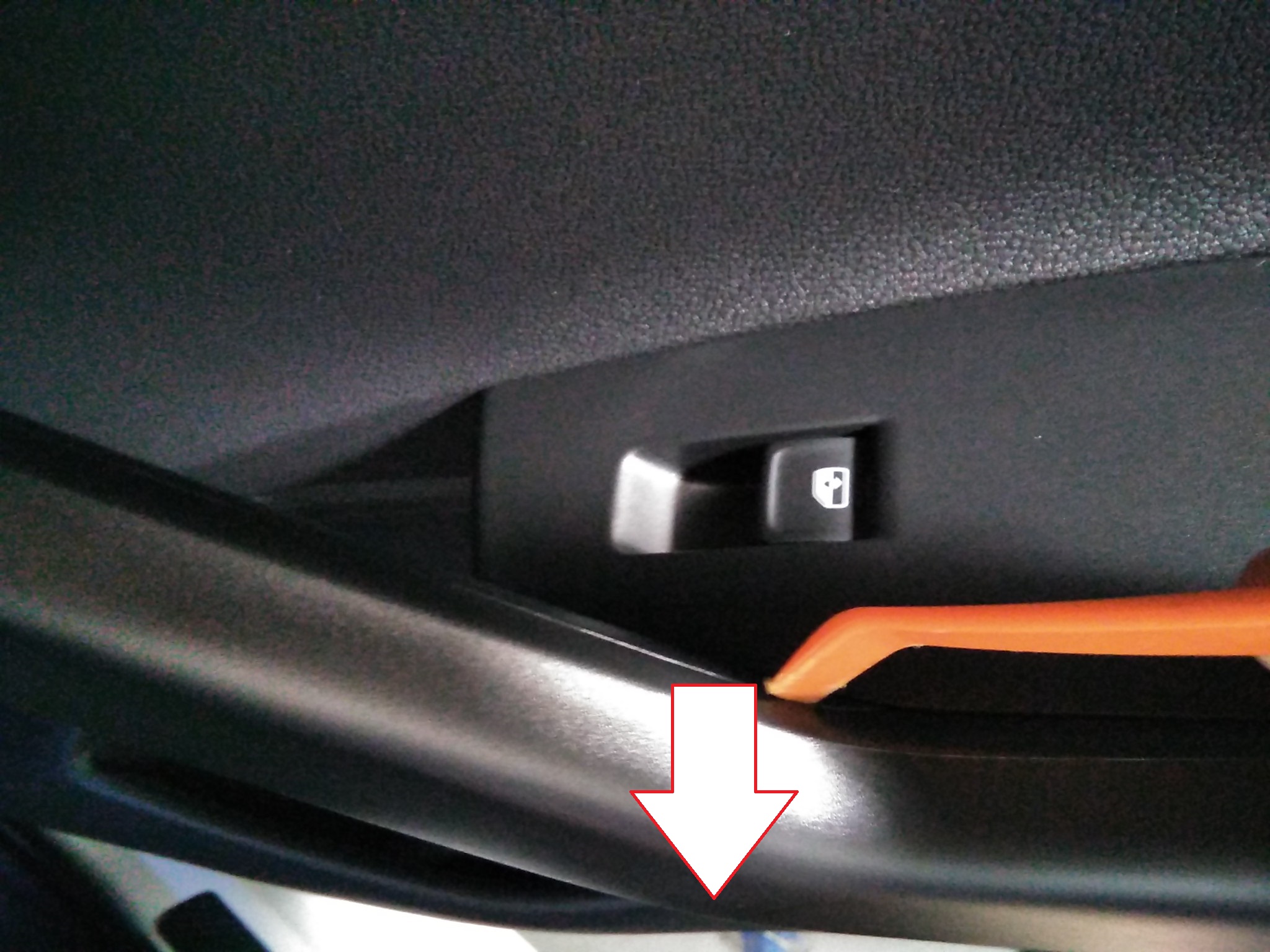

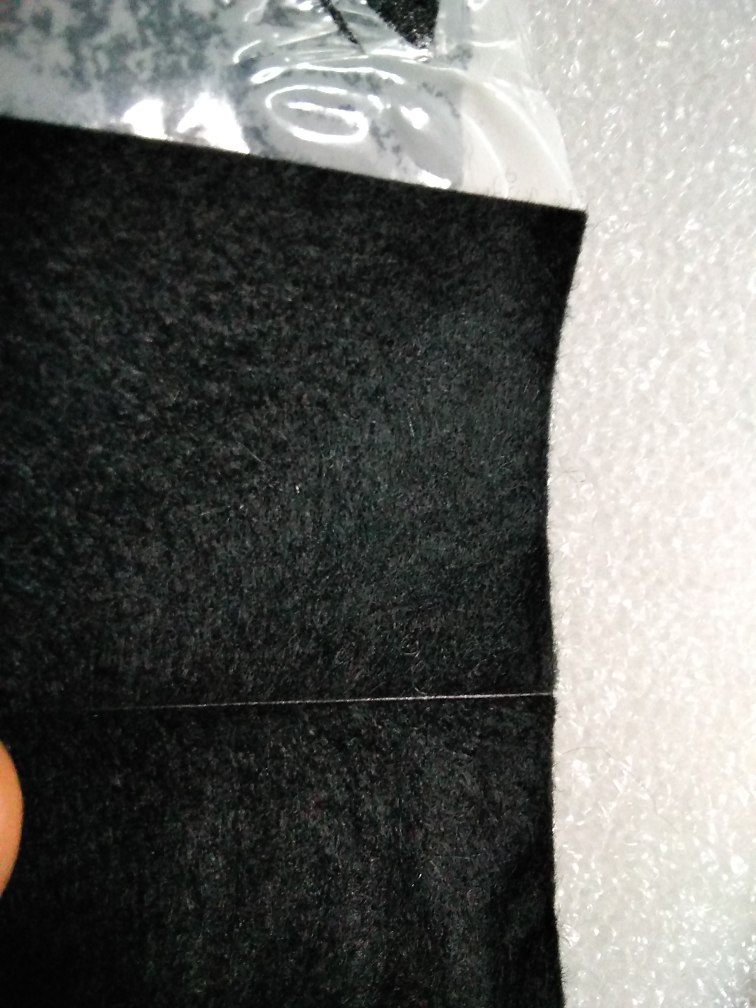

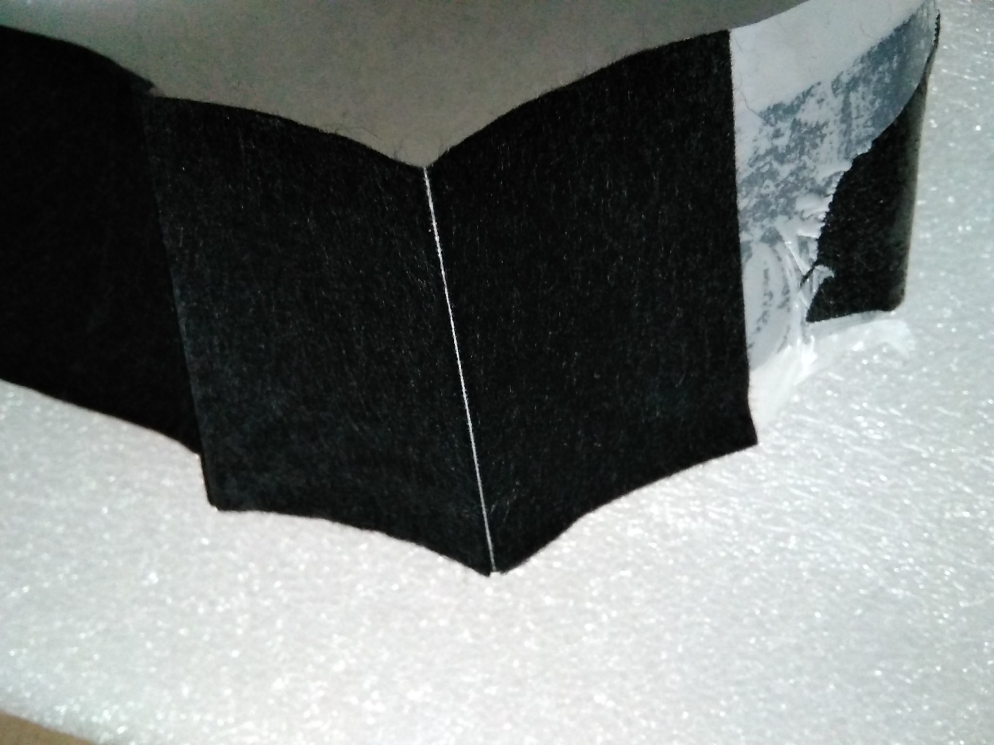

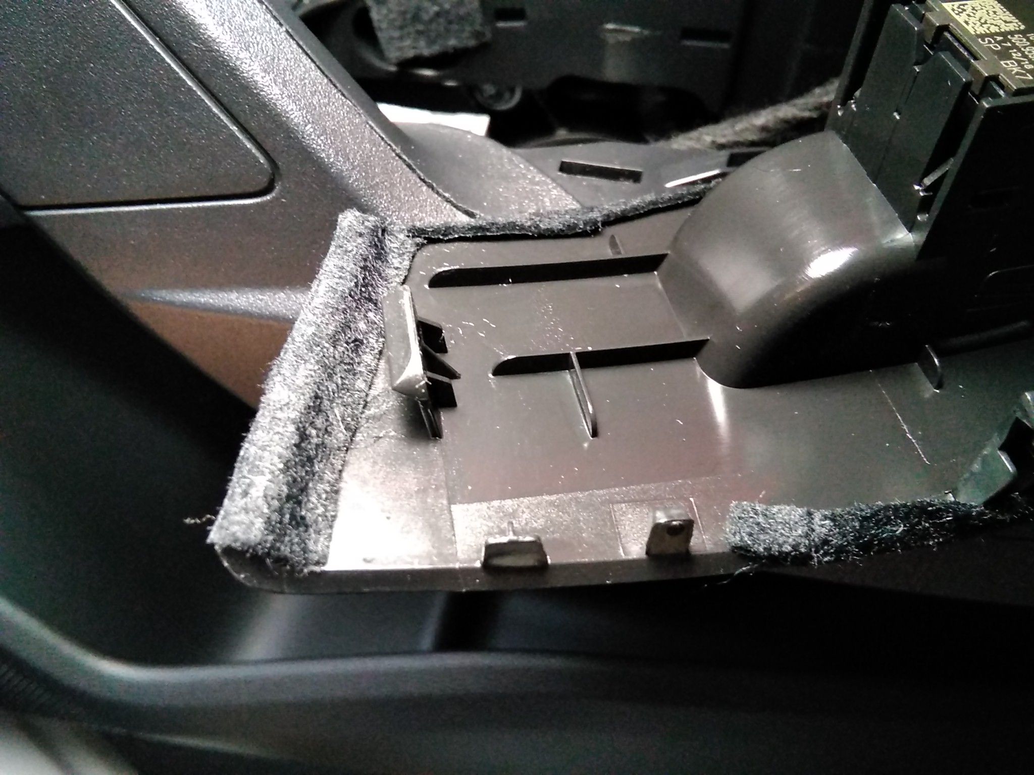

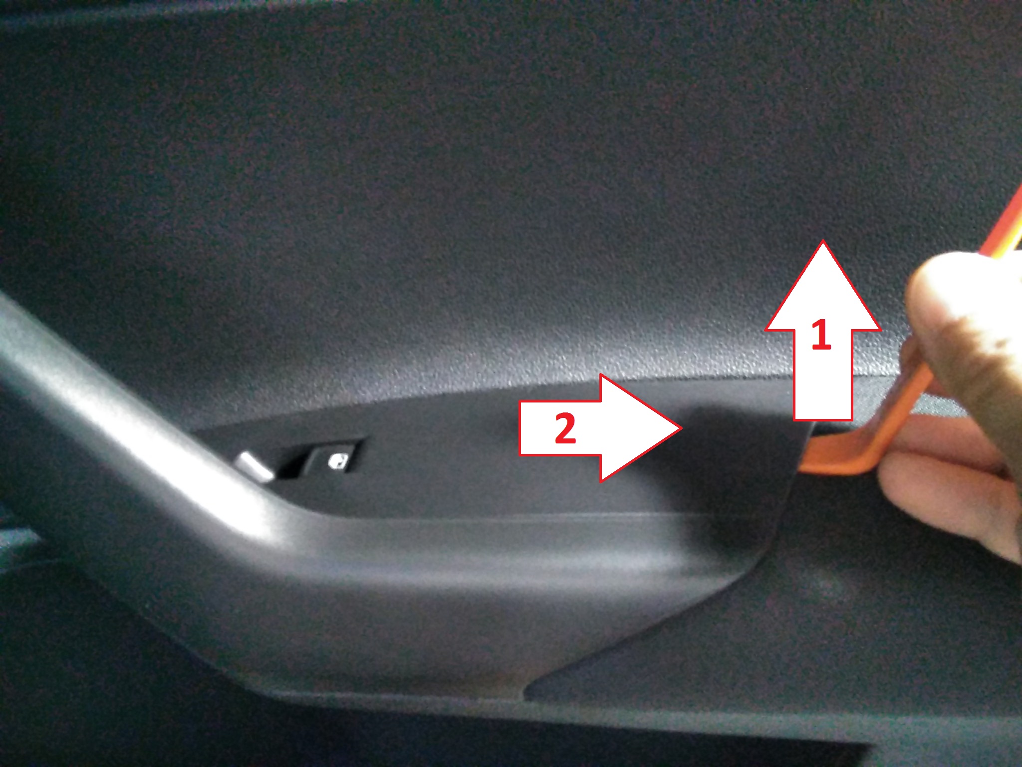

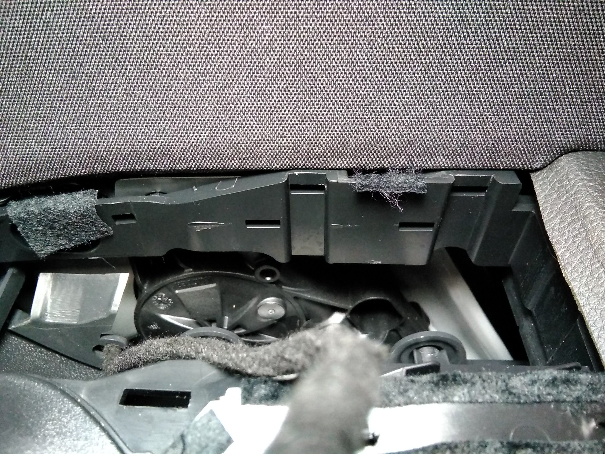

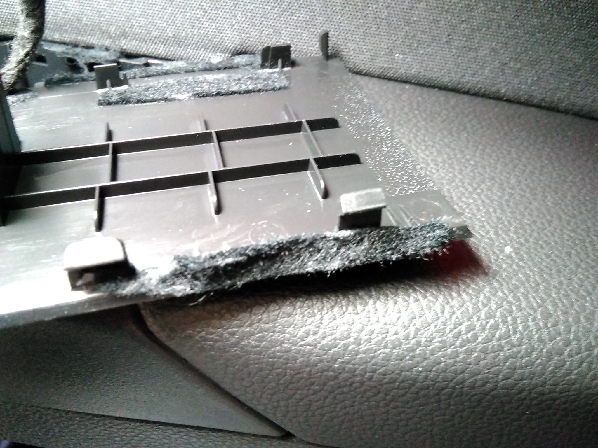

The noise I had and resolved to 90% were the interior door knobs that creaked whenever I moved them.I open and put some kind of tape cut very small to be in the middle of the knob that stays in the car and the other that comes out. I will put some photos as soon as possible.
The tape and what I did.
