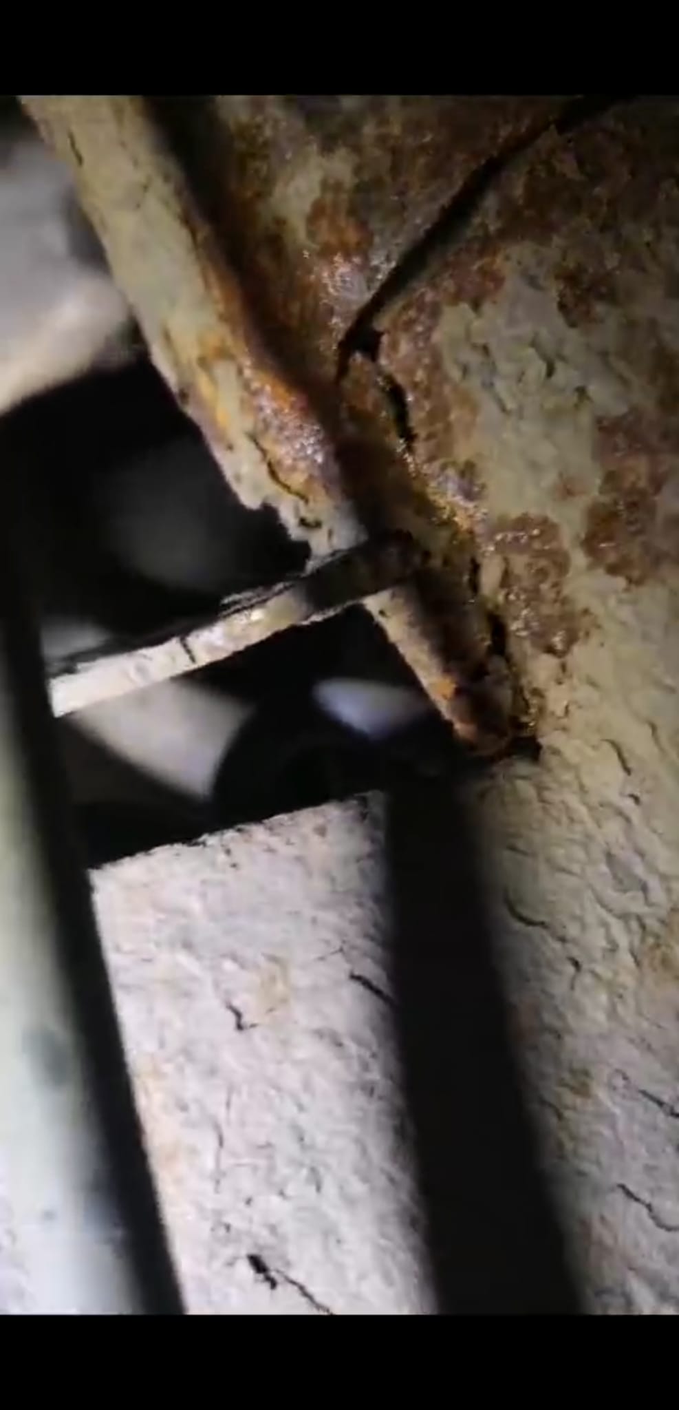

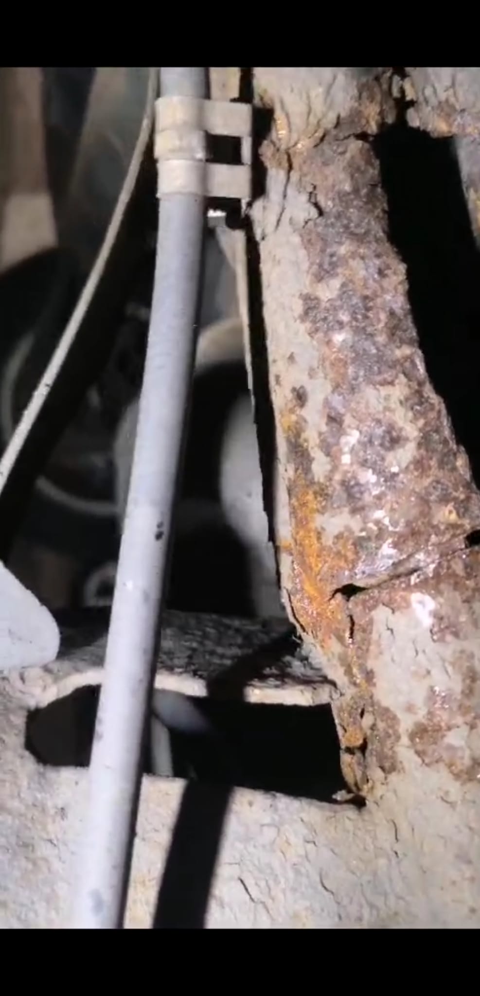

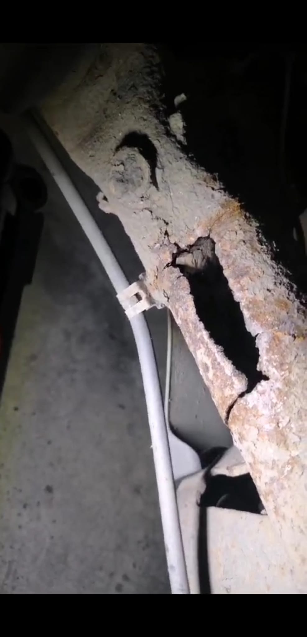

im about to overhaul mine with a bend new axle ( right now they are on ebay for £114.95 + postage of £15.99) the car has 216k on the clock thus far so will be treating the back end to new stub axles and new wheel bearings while im back there. The back wheel bent as a result of the axle giving in ... anyone thats not checked theirs... please go do just that as we all know these cars are not driven in the safest manner possible. i shudder to think the speeds i was doing with my axle in that condition and being completely oblivious
